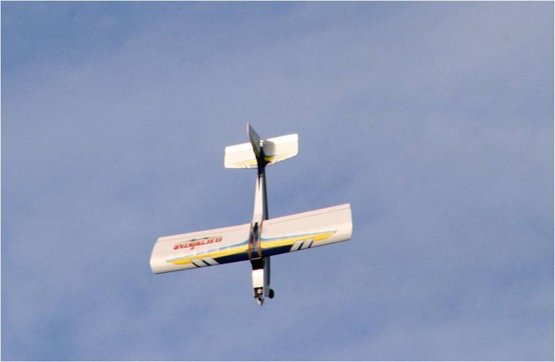

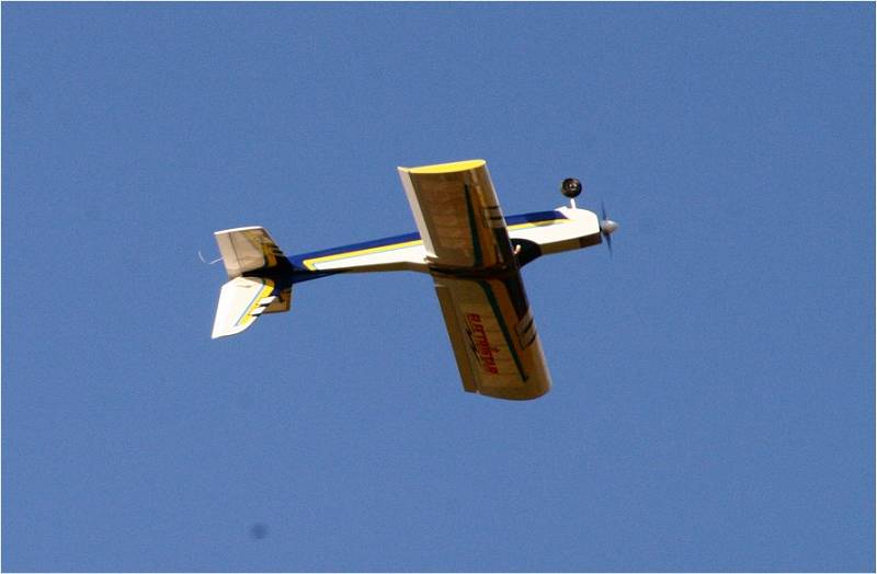

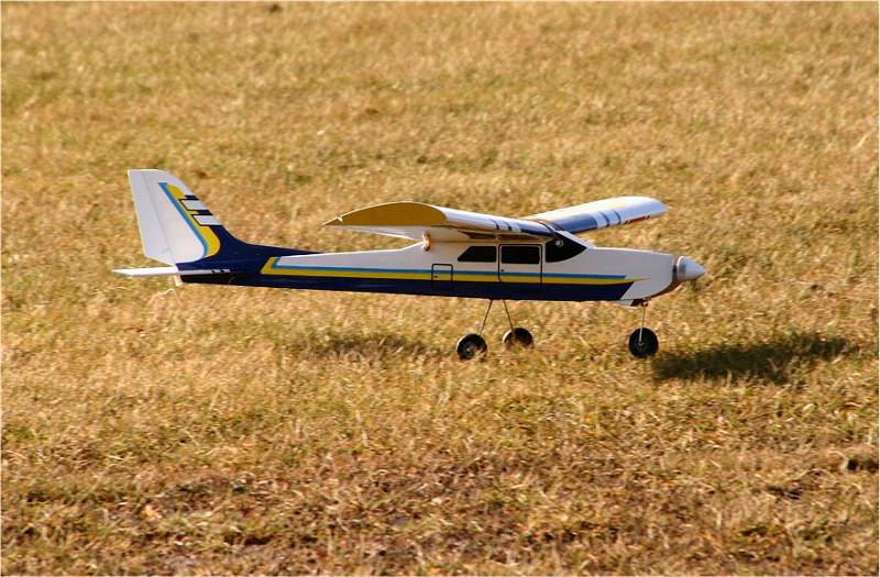

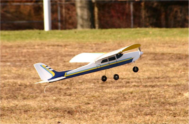

RE: Hobbico Electristar Select EP Trainer RTF
We flew the ElectriStar today and it performed very well. The maiden flight was using the two NiMH packs and the second flight used the lighter LiPo pack. Even though the grass was rough and muddy, the ElectriStar handled it well. We could loop it, roll it, and fly some very low passes. The plane flew stabile and landed easily.
The only issue I saw was some pulsing from the maiden flight takeoff. It appears that the NiMH packs had a problem delivering the current at full throttle after their first charge. They should improve after a few cycles. The issue was not seen using the 20C 3200mAh LiPo packs that can deliver 64 amps.
I'll post some video soon...
flying photos by "Papa Jeff" Ring

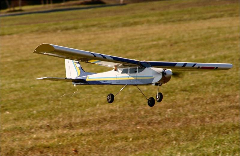

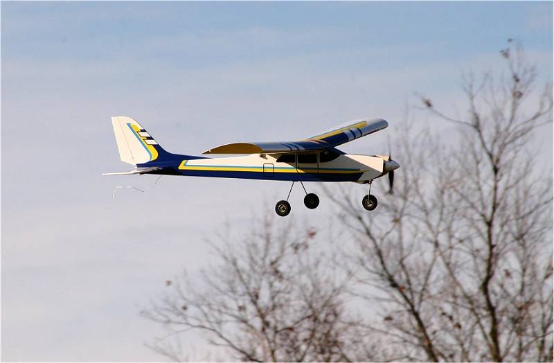

#32
The maiden flight of the ElectriStar used the two 7-cell NiMH packs in series as a stock configuration. The take-off used 3/4 throttle as we noticed some motor surging likely due to the new NiMH packs still needing a few cycles to gain strength.
[link=http://www.gregcovey.com/reviews/Electristar1.wmv]ElectriStar Maiden Flight Video 1[/link] (10meg)
The second flight used a 4-cell 3200mAh (20C) LiPo pack which weighed 1lb less than the two NiMH packs. The short take-off used only 1/2 throttle. Although the plane flew fine using the two NiMH packs, the lighter LiPo pack really gave the ElectriStar extra spirit. It makes for a great (and easy) upgrade once you have mastered the trainer.
[link=http://www.gregcovey.com/reviews/Electristar2.wmv]ElectriStar LiPo Pack Video 2[/link] (12meg)
