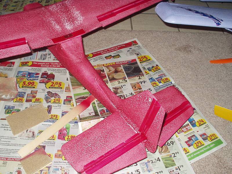

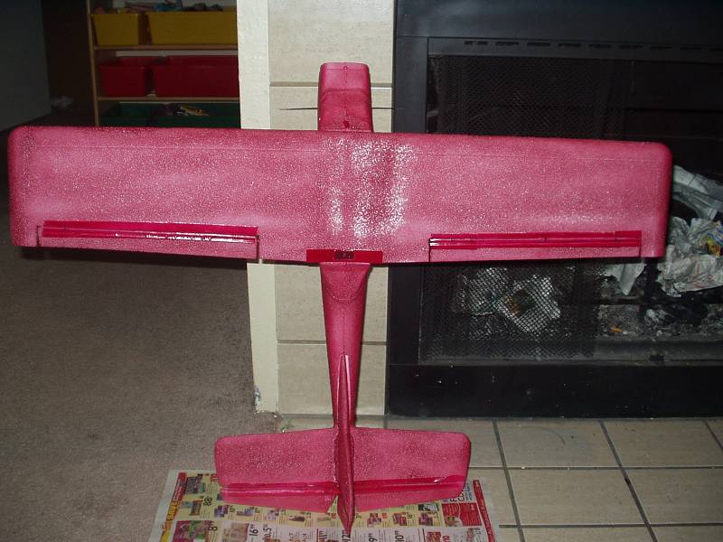

Just finished the main part of my build on a GWS EStarter foamie and wanted to paint it. Not even thinking about it I used one of my cans of paint designed for plastic. It ate into the foam and has left me with a new "braille" version of that model.
My question is: Can one use some kind of covering like Solarfilm Lite or Ultracote? Maybe some LW Tissue? any ideas? I don't want to restart this build, this is the second one I have done and I have made more mistakes on this one than I care to admit.
I assume having a rough surface will make the plane pretty unstable in the air...or will it be ok??

The rough surface is on the fuselage, or is it on the wings?
If the fuselage, it will fly just fine. If it's on the wings, it will probably alter the flight.
RE: Major screwup..is it fixable?
Its on the wings and elevator as well as the Rudder and ailerons.......... does that mean I am buying another kit?

Arrow, post a pic of the damage, it may be fine.I have planes with damaged and eat up places on the wings and they flay just fine. The ES is a very forgiving plane, look in my models and you will see mine that has been through more abuse than mose can survive it is 2 years old but is my most dependable plane. You can use ultra coat on foam but I wouldn't do it unless you need to. I covered a scratch build with it and it came out OK but I am going to have to remove it all and use some adheisive first so it will stick better.

The underside of the wings is just horrible......... I am thinking I need Ultrakote. Heres some pics.....hope you can see how bad the paint ate the foam.

I don't see any holes - Put the motor on it and fly it man! I'll guarantee you won't make the same mistake again, and it will be good for you to have a plane that "isn't too pretty" for you to try those new maneuvers on!
Seriously - just finish putting it together.

I agree with Bad Daddy it will most likely fly just fine but if you just realy want it to look better there is another way besides ultra coat. I say this because the prep and time involved to cover a solid area is,,, well lets just say time consuming and unless you have done covering you can make it a lot worse by melting the foam with the iron.. Now having said that first are you going to be using the stock motor set up or going brushless, also what batts are you gonna use, the plane will most likely come out tail heavy in the stock build. I would sugggest just taking some 180 grit paper and sand the whole plane good, there is plenty of meat to sand some foam off and not be concerned, then use 220 to smooth it out, then if you want to paint it use testors model paint or something simular, keep in mind all water based paints come off real easy with nicks and dings unless you seal them in with something. My ES actualy has 2 coats of paint, the first was a dark burgandy, then I painted it back white and did the rest in decal material.
Good Luck with it, the ES is a great flying plane
EDIT: one other thing you can consider is light spackle, thin it out and paint it on, let dry and sand it smooth, I haven't tryed this yet but I know a lot of people that have, mostly for small repairs but your just looking at pit holes, not major gouging.
