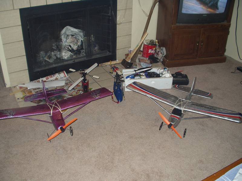

I did some mods to mine - brushless power, 3s lipo, tricycle gear, fiberglass inside the tail section, clipped wings.
Here are some photos:

And another important mod as seen in Nitroaddict's pics: Putting down a wood tray under the elevator and rudder servos. I just put down 2 thin strips of wood across rather than making an entire tray and glued them in (I try to save weight where I can). You can screw the servos down then. I still use the double sided tape too--I don't want anything to come loose in flight. Had that happen once....
I don't do a tray for the ailerons. Wood strip as before and do a very tight fricton fit. Put tape around the case of the servo and glued them in with a touch of white glue on the SIDES of the case. I had to remove one once and it wasn't too bad cutting it out. Just stay close to the servo with a sharp knife and take your time cutting the servo loose and it will come out clean. You'll have more problems if you put glue on the bottom--no way get at that easily with a knife.

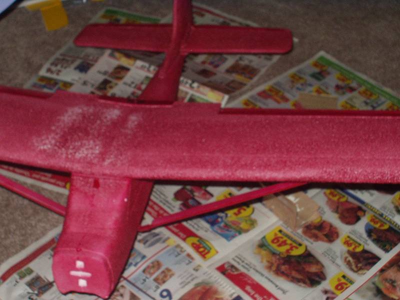

Just finished the build on my Estarter last nite. I made a bunch of major screwups and had to work backwards alot but am going to maiden it in about 20 minutes here. Also have the gf's Estarter fixed up and ready to go too. Hers is the purple one, I painted mine chrome........ Originally it was burgundy but I used non foam friendly paint and about ate the foam away. Had to spackle it and sand it down to closer to smooth then repainted it a shiny color........ Old eyes don't see as well as they used to.
also will be flying a few of the helis I have......TREX 450, HoneyBee King V2, and a Eflite Blade CX2. Weather is supposed to be beautiful all day today so want to make a day of it!

Nice looking planes Arrow, and Nitro. What kind of paint did you each use for yours? Dont want to make the same mistake Arrow did.
Nitro and Time Pilot, thanks for the advice, will definetly be re-reading this thread often when the plane finally shows

RE: What needs done to new E-starter?
I ended up going to a crafts store in town and bought some Testors spray paint. they didn't have the copper color that i wanted so I went with the chrome.........
Paint at the hobby store.....5 bucks a can.at the craft store....3 bucks.....hmmmmmmmmm
Alright, thanks.
Sounds about right, but hey I'll prolly buy from LHS if I can, only one around and it's still 45 minutes away, wouldnt want them to go outta business.
heli - I used pactra racing finish - lexan car body paint. it will eat the foam if you lay it on too thick, but several light coats will work just fine.
