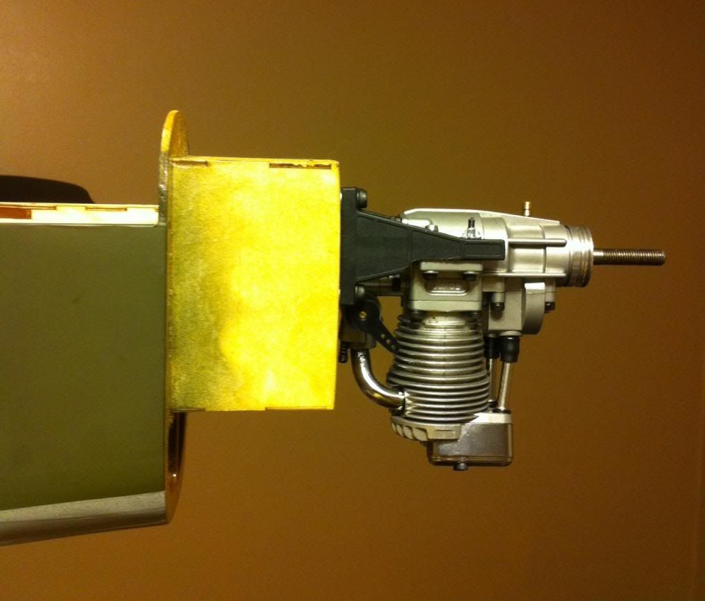

I started the build by cutting the motor box back 43mm from the front, keeping the right thrust intact. I cut a 1/4" piece of plywood and epoxied it in with triangle stock going back into the motorbox. After that dries, I will fiberglass over the air-cooling openings below the motorbox, and fuel-proof all the wood in front of the firewall.

If anything, it appears to have UP thrust and no DOWN thrust at all. Did you add any? How does the cowling look regarding downthrust, c550?

I only noticed right thrust in mine, but unless you want to redo the cowl you have to match the cowl to the spinner backplate. I used a bandsaw to cut off the electric motor stuff off of the backplate and it fits the saito just fine.

I'll live with the unexpected and undesired upthrust.

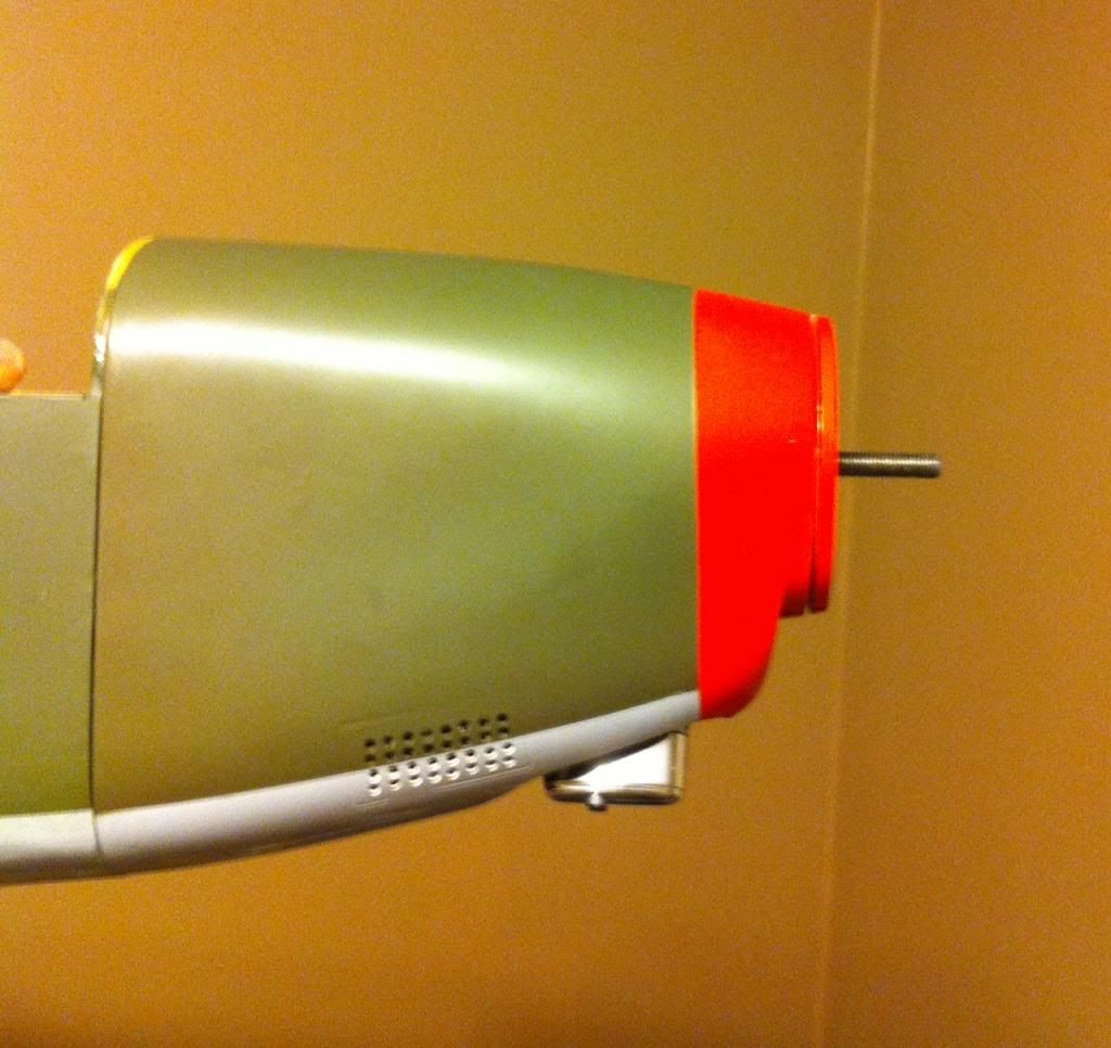

The spinner offered some challenges. I had to hack-saw the collet-thingy flush off the backplate and drill out the bolt-hole in the spinner to allow use a dave brown adapter. I also had to grind down the bolt sit flush in the front of the spinner. I had to drill out the backplate center hole to fit a spacer that I had laying around from a dubro spinner. I hope the ******* is balanced.
The color mis-match of the wing flarings and the hatch-cockpit have reared it's ugly head. A few people have mentioned it in other threads. Cannot see it in the posted photos but under my fluorescent lights it might have to be addressed. Not sure how yet...

I have taken a palm sander and removed the upthrust on the new firewall. I also took the sander to the front of the cowl and added downthrust angle. It sanded through the lip on the bottom and most of the side. I will see how that works out later.
I had some Olive Drab flat lacquer and lightly sprayed the cowl, hatch, fuselage and inner parts of the wings and horizontal stabs, blending it a bit. This was after rubbing the entire surface with steel wool. First impression is wonderful.

Here's my attempt at downthrust and the cowl front to accommodate it:
