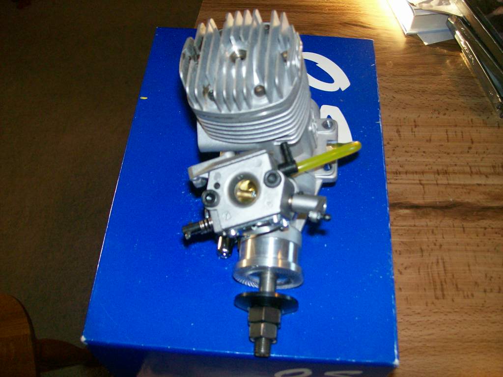

I finally got around to doing the conversion on one of my OS-160 FX engines, I am still waiting for the IGN to hit so I can't add the magnet and time it, but I think the rest is finished. The parts was some leftover materials I had on hand, Alum & delrin. I also went with the 1/4-32 plug for now I can always change it later if need be. The carb is from Davesmotors it is a WT-499 11.1 MM bore. I modified the stock hub for the magnet and put the pulse hole in the side and not at the rear like some I have seen.
I would like to thank w8ye for his input on this project the man knows his walbro carbs and much more.
If they will load here is what I have so far.
P.S. Just how does one turn the inlet fuel barb W/O breaking it off?

The fuel inlet has a brass barb inside.
If you try to do anything with the fuel nipple it will break off leaving the little brass stub sticking out.
So the usual proceedure is to break it off and pull out the stub with pliers
You can get new ones either plastic or steel from Horizon, Bennett, or several other places.
The new one taps in with a small hammer

Hi Karolh, thank you.
I have done this type of a pulse set up for many glow engine useing a pump or regulator, Only I sunk it in some to make sure it was nice and flat for a good seal and to also prevent it from being knocked off in case of a crash. It won't weaken the mounting lugs and will clear the mount ok. I get a nice strong rush of air each time I turn the engine over by hand where it is at, so I think it should be fine
I originally was going to put it in the rear on one of the top bolts, but I didn't have the neccesary hardware on hand to do so, and to make it is not feasible for what they cost.
BTW that side of the carb is getting rather busy with the pulse, Gas, and throttle hookup on it but all will clear now so things should be good, however I am still thinking about a different throttle arm, that one is to long and sticks out a mile and it would be less work to change it than to mod the one thats there now.
I was able to turn the fuel fitting but it took alot of pressure with pliers, I will get a all metal one headed my way in case of leaks.
The throttle hookup with the exsisting arm on the other side was almost impossible to make work in its original configuration and be a pull throttle, and a push throttle I don't care for on a spring loaded carb such as a Walbro.

My Ign hit here today so I had a chance to run the 160, after a good warm up and some initial needle tweeking the engine would maintain a steady 1700 idle RPM with a high of 8850 -8900.
My set up was this
20-1 penzoil aircooled
88 octane pump gas
18x6 wide blade APC prop
Timing set at 28 Degrees BTDC.
Jtec exhaust diverter, not a muffler actually and made for a 108 to boot.
Elev. 4500 ASL
(Sorry no density altitude I forgot to call) But it was trying to rain*L*
New Bearings
New Bowman ring.
The engine before took a little to wind a 18x6 wide up, now its almost instant acts like a wood prop, the thing I really noticed is the smoothness of the engine, it seems as smooth as it was on glow fuel.
After some more run time and minor needle tweeking to get it dead on I really think I will enjoy this engine.
The low tick over at an idle is something to behold, I let it idle for a few mins while I walked outside and when I came back and nailed it, it was top RPM's instanally, no sag or flooded condition.
The low end needle is a little bit on the sensitive side but should be ok, the high adjust like a typical gas engine.
I did notice something, the ring looking thru the exhaust port is completly shiny now, I did get a little of the black splatters out of the exhaust which is normal, but the ring seated in very fast.
Compression feels good and it was one flip starts with no sign of a kickback.
All I can say is so far is that I am very pleased with the conversion and the amount of gas it used was considerablly less than glow fuel.
