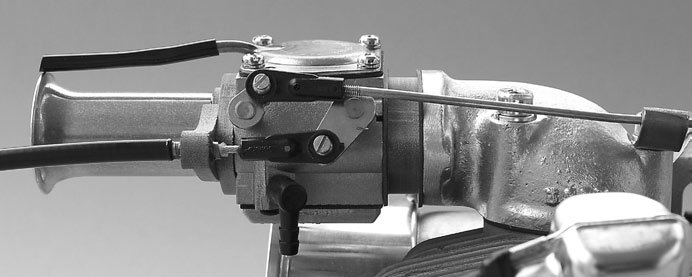

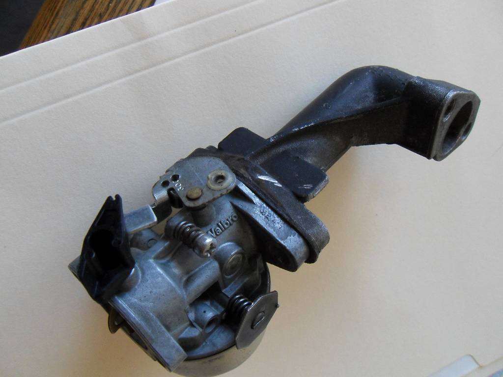

RE: How sensitive is intake mani length on a little 4 stroke?
Thanks, great ideas there.
Here's an elbow from Clark's. Gives me the right idea.
And here's one from my pile'o'parts bin.

Going from the small carb bore into the larger intake is going to cause problems. I wouldn't move carb unless you don't have a choice at all.
