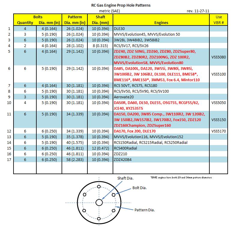

1. How are the six prop retaining screws drilled while the hub is still in the lathe chuck?
2 Should I make up a drilling guide first? Out of some thick steel plate or round stock?

in the lathe you would need some way to index the spindle and live tooling to drill and tap for the prop screws. that's why i prefer to do the prop screws on the mill in the same setup i do the counterbore for the mandrel...concentric without the need to even check it. you could get by with a drill jig if it had hole sizes for both drilling and tapping but then you are going to need one of the above mentioned methods to make the jig.
edit: one of the commercially available jigs would work fine after bushing the holes down with brass tubing or similar. would be a good idea to drill and tap on a drill press and not free hand. the 10mm center shaft is responsible for centering the prop so no worries if your bolt circle is a hair off.
hobbyking probably has a jig for cheap. six M5 screws on a 29mm circle would be the default choice for an engine this size.
