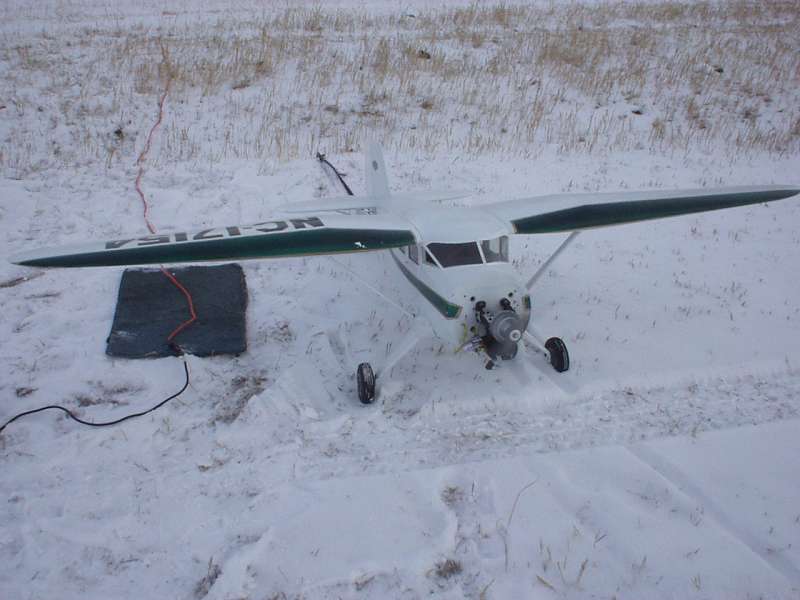

    I flew the TF stinson with the 33cc homelite today! Woke up this morning.looked outside and it was snowing and only 5 degrees F. -BUMMER! Luckily it cleared up by noon so I hauled her out to the field and fired it up. What a difference in power! The plane broke ground in 40' even with 2" of fresh snow on the ground and climbed right out! I flew it for 10 minutes and then landed because thats all my fingers could take.(10 degrees F with a lite breeze). Thanks for the input on the homelite. Can`t wait for the weather to warm up a little... Ron

    Just out of curiosity, how much does your Stinson weigh? Did you use the 18-10 prop? My DR1 weighs 15# max and it will leap into the air if I'm not careful, then I can cruise at half throttle. I figure my Me110 will be in the 30# range, so the two 33s should work well.

    Jim, acording to my bathroom scale the Stinson weighs 21# minus the cowl and wheelpants, as flown today with the the homelite 33cc and 18x10 prop. This combo has plenty of onions for this plane. after all with 100.5" w.s. and nearly 1500 sq. in. of area the Stinson is just a glorified Piper Cub,ha,ha. speaking of multiple wings my curtis hawk is sitting upstairs just begging for a new homelite 45cc conversion.... That bipe flew like a big trainer with no bad habits and was very aerobatic, I even made several helicoptor-like landings in a stiff breeze... I think twin 33`s in your ME 110 at 30# should scoot along just fine. BTW how do you adjust the needles on you tripe? I used a pair of hemo-stats and turned em a little at a time, not the best way I`m sure but I did get em close. Ron
