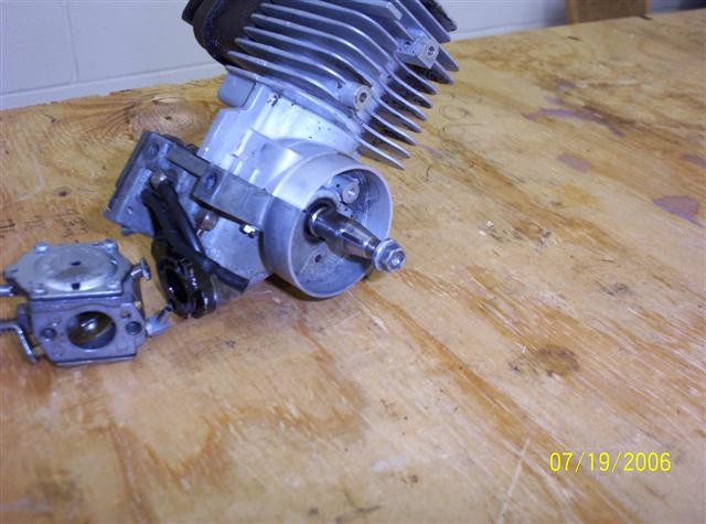

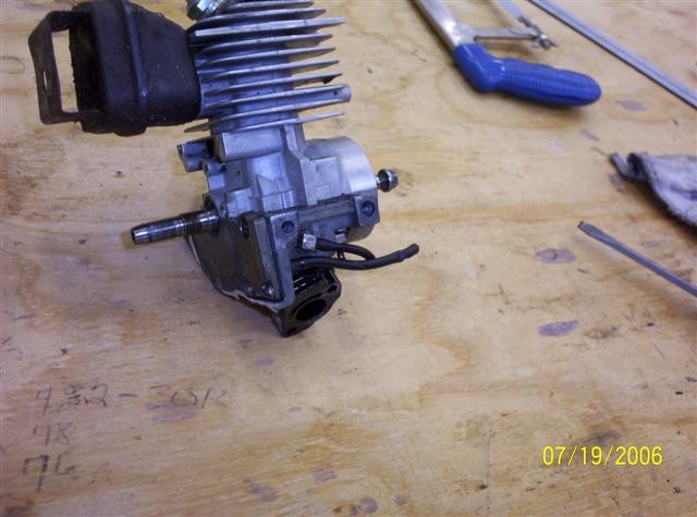

Join Date: Dec 2004
Location: W-S, NC
Posts: 121
RE: First conversion pick a engine 5-choices?
Hey Dave mine does look like your rear exhaust bottom carb, but it has the side beam type mounts. It also has a real short Keyed shaft, that will have to have some kind of spacer to mount prop with. I assume I just plug the crankcase vent that runs the oiler or does it need to be vented somewhere?..
Also after I took a good look at the carb it only has a low needle so I guess I'll need another carb..Right?
I could steal a carb off the MAC but they are MOC brand and look really old.
I'll take a pic tonight and post it when I get home
Thanks for your help guys..
My Feedback: (29)
Join Date: Jan 2005
Location: San Antonio,
TX
Posts: 1,402
Dale,
I guess AV8TOR was right about the beam mounts. That is great. I can't seem to visualize the keyed shaft. Usually you have a taper for the flywheel followed by threads. All extra holes in the case, except the pulse port for the carb must be plugged. You can tap and fit with a screw or fill with JB Weld. A carb with two needles is best. You can test it with a single needle carb. Some older carbs have a second needle recessed and covered over with sealant. If the Ryobi has good compression, it could be converted quickly for a few bucks with parts from Wackerengines.com
Dave
Dave

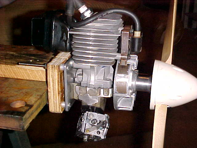

Join Date: Dec 2004
Location: W-S, NC
Posts: 121
Ok so I finally got time to work on this thing, and got all my parts together.. I chose the homelite 32cc . I got it mounted and after some effort got it running on the glow /gas mix, one time I had 7500 rpm on and 18x8 master airscrew. Is that pretty decent.
I just got started messing with the needles and getting the transition set when my motor mounts bolts backed out,, so I shut it down to tighten them and guess what I striped not one of them but both bolts on the left side... DUHHHHH.. So now I'll have to figure out a way to remount the engine..
I see Dave used a back plate and cut off the side mounts, I check and see if I can do the same..
I'm not sure of my fuel mix, the only car fuel I cound find @ the store was the Traxxes brand and it doesn't show the oil % but the owner said he thought it was 12%. So if that is right I'm running about 25 to 1 mix. a little rich but it ran pretty good..
ANy comments on the set-up will be greatly appreciated..
Thanks guys.
Thanks guys.
Dale,
Below the exhust you will find som aluminum boses. These can be drilled and taped for a radial mount. Just attach a plate mount with flat screws and spacers if needed. The side mounts can be cur off. This will save weight all the way around. Use locktite. My Homelite 26cc, lacks a needle bearing at the top of the conrod, like the early Quadras. This means that you need to use more oil. Maybe 32:1 or 4% minum if this is your situation also.
Dave
Dave
