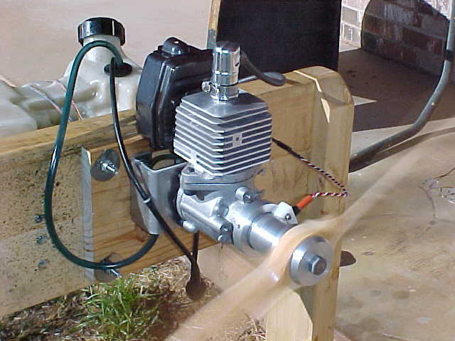

WALT: If you got a Ryobi you can make a mount similar to this. Or just a plate on back with four standoffs. Use dowel or aluminum rod for standoffs. Easy! Capt,n
My Feedback: (16)
RE: Engine identification help!
Capt'n,
That Ryobi look so clean that one has to admire it, I wish they came in bigger displacement with the same inline design.
I see yours has electronic ignition, would like to expand on it?, what size prop are you using on it and what rpm are you getting? have you installed it on an airframe and flown it or are still admiring it on the ground? Any idea how heavy and what size airplane this engine would be able to handle comfortably?. It is kind of difficult to make up the type of mount you have on it, but as you say a flat plate mounted with metal tubing spacer should do the job on almost any installation. And yes, my weedeater is a Snapper with a Ryobi 31 cc, that runs very well, only gallon and a half fuel through it, I am ever so tempted to disect it!! (Isn't it a sick thought?)

WARNING: FURTHER REPUBLICATION, REDISTRIBUTION, OR REPOSTING PICTURES OF FLIPFLOP MOTORS WITHOUT THE EXPRESSED WRITTEN CONSENT OF FLIPFLOP IS STRICTLY PROHIBITED AS THEY ARE PROTECTED BY A MULTITUDE OF NATIONAL AND INTERNATIONAL COPYWRIGHT LAWS.
Hahahaha Guess he likes my motor.
The mount on the engine pictured is a B&B mount, it works but it's a pain in the neck to mount to the firewall and there isn't much room to make your throttle connections. There also isn't enough room for any of the larger aftermarket carbs that you might want to try. The latest version of my mount has enough room for just about everything short of a 650 Holley.
