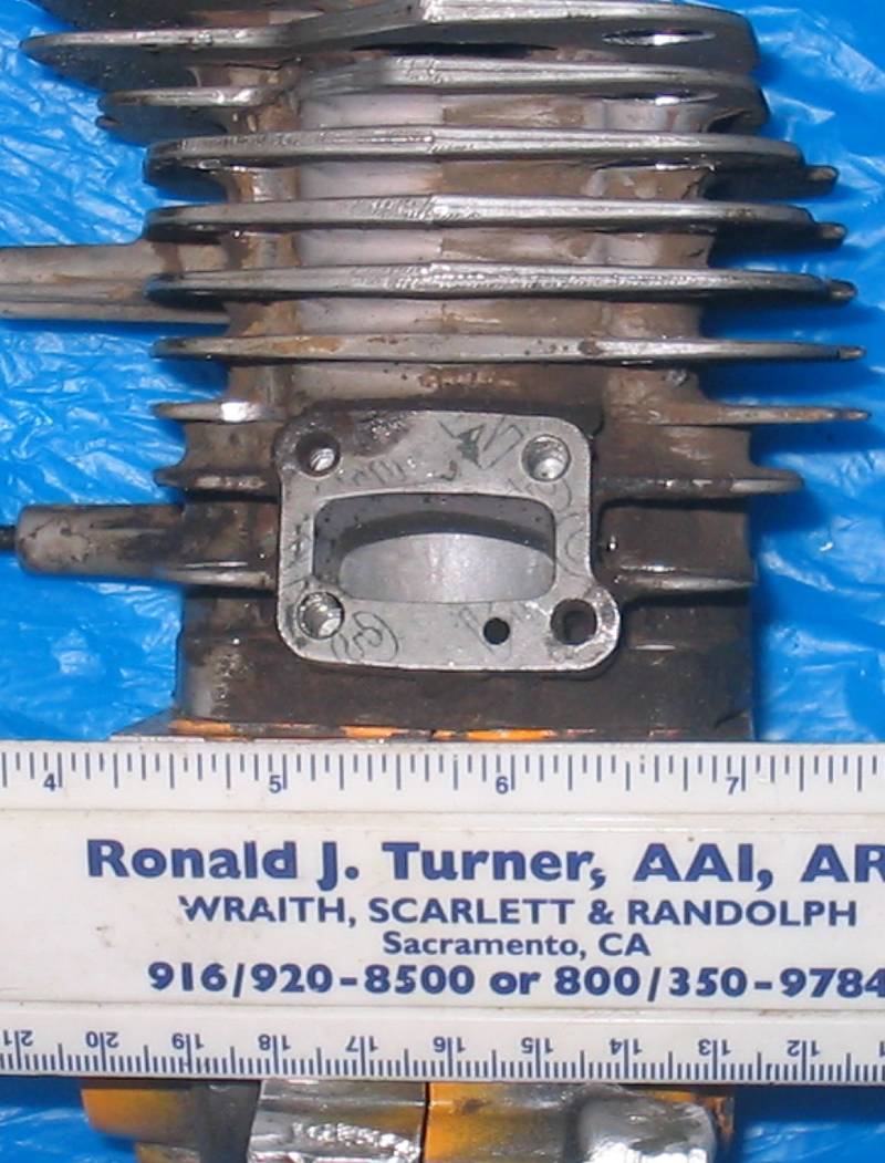

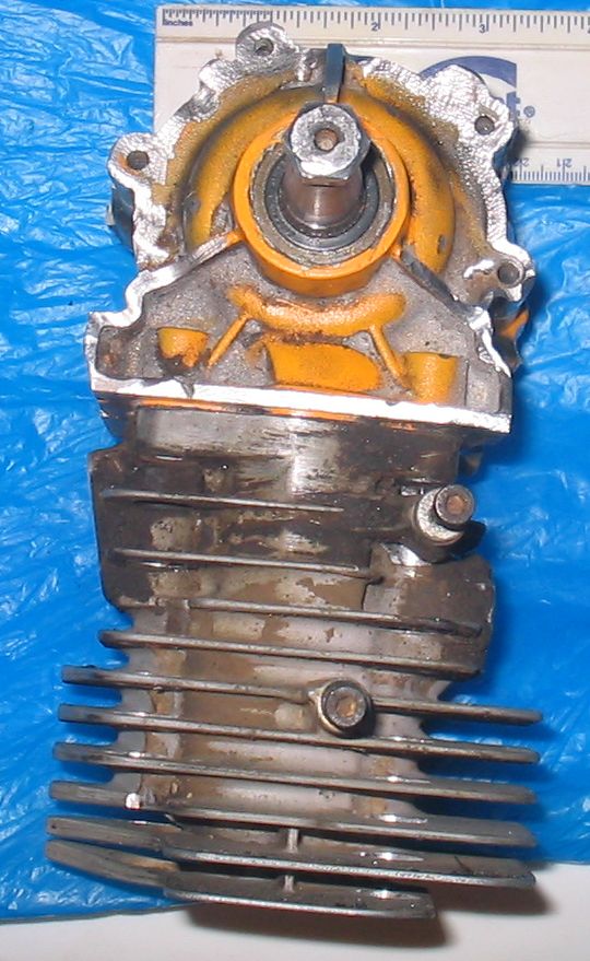

I was given a Partners K650 cement saw to do a conversion with.
So far it looks realy good.
It's a 72cc engine I'm hopeing to run on gas-glow.
I have cleaned up one case and am getting ready to do the other half.
So I decided to stop and take some pictures before going any further.
I'll try to keep everyone updated.

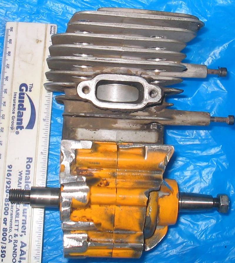

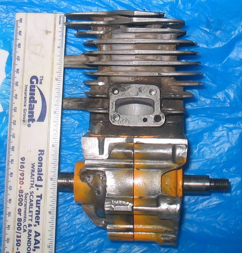

You can see the piston through the exhaust port and carbon on top of the piston
so you know it has not been cleaned yet.
Did I mention 3 pounds and 6 ounced stripped down.
A prop hub some stand offs and some Gas-Glow mix and it will be ready for a test run :-)

The bolts that are being used are about 1/4"dia. and have a built in washer that is 7/16 in diameter.
So I'll need to turn down the last 3/8 of an inch of the 1/2" stand offs-offs to 7/16.
I'm planning on using 5 stand-offs.
