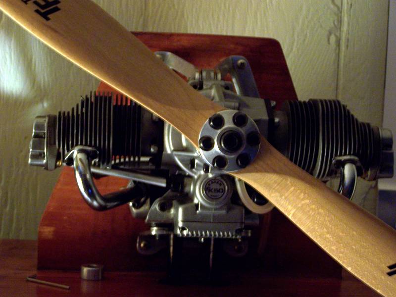

Here is my four stroke engine I am going to place in a J-3 Cub or something simular. Going to fly easy with this one!!! Its a scale model of a Contnental Aircraft engine! Kavan K-50. P.S. Hi to a new friend..named Geroge. Best Regards Capt,n
