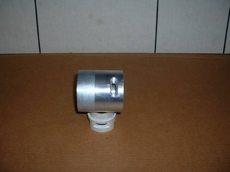

Hello,
My son gave me his old digital camera.(my first)
I thought I try to show the beginings of a lathe/mill project
I’m starting on. An Echo 23.6cc. for bicycle pedal
Assist.(If this is too out of place here,say so, and I’ll
remove it.)

Hi,
The 3”aluminum round stock will be the new finned cooling jacket for the
cylinder in the third pic, that one had it’s fins turned off.The plan is just a real light press fit for good heat transfer. Basically this is just for fun. Plus I wanted to get away from the "fancooled" look of the cylinder.
I’ll make up a head button like are used in R/C cars for a little CM-6 NGK
plug I picked up.Not sure how many cc’s to set the head up for yet.
I’ve picked up the exhaust port location on that stock, and will mill a flat and port to mount an exhaust stub tomorrow.
This is a pic (if it loads)of the head button style I have in mind. (not mine)
There is no practical reason for doing this I’m afraid…

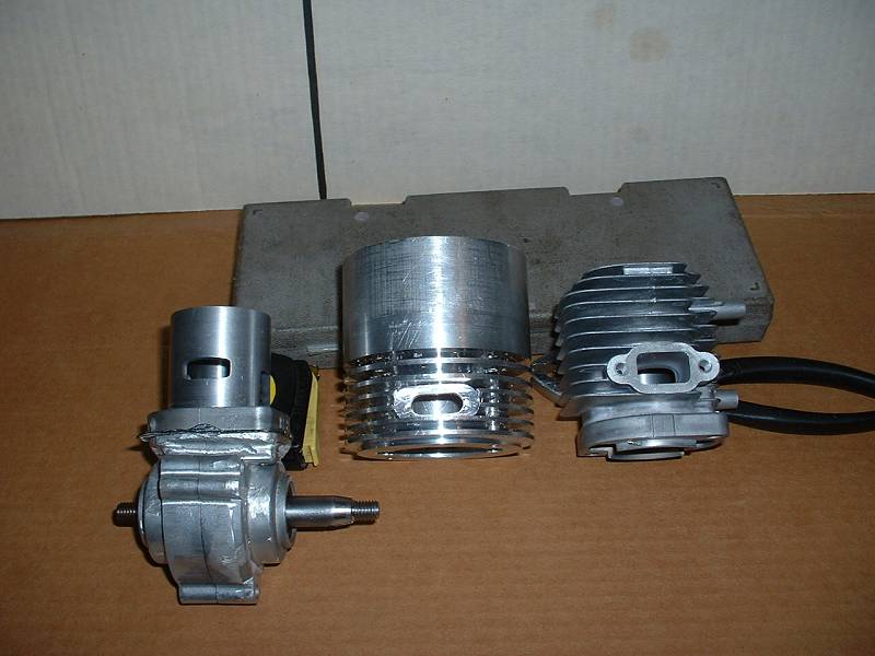

Hello,
I made a little more progress.
I believe the aluminum stock is
starting to look like a cooling jacket now.
Next is to final size the jacket bore and
part off the extra stock.

Default RE: Echo Lathe/mill project
Looks very good. You are making good progress.
