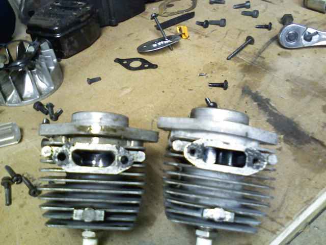

hi everyone. i am building a rc airboat and i have a 31cc ryobi on it and i was wondering what engine work i could do to it to make it swing a 16X10 3-blade really well. i understand that 8000rpm is a no-no. so i want to keep it under that. what i am looking for is torque. if that is possible without too many rpm. i bought one engine and took it apart today to see what the insides looked like and took some pictures. but when it went together i didnt see the pins arount the piston groves for the rings. so i broke them. i just picked up another engine and took that apart too. so what im gonna do is make one good engine and buy rings for the other. so where should the new rings come from and any advice what i should do. here are some picts of what i have parts on the right are from the new engine.

I use this engine in an airboat. I have done several modifications with to find some more power. Get yourself a Bowman pistonring, it will increase the compression, change the carb for one with 11+-mm venturi, widen the exhaust to at least 0.65 of bore and do NOT touch the bridge in the middle, set exhaust timing to approx 158+-, ditch the base gasket or get a thinner one to get a piston/head clerance of 0.5mm, then you will have a lot more power.
Personally I took it a little further, I widened the exhaust to 0.75% of the bore, used a exhaust timing of 162, if I remeber correctly, turned down the end of crankcase in a lathe to decrease crankcase volume, opened up the reedvalve and used 0.15mm shimmetal to make a new petal. I also opened up the transfers and matched it to the case and made a moussecan pipe. The pipe increased the rpm with 800+ or something(dont remember exactly) It turn an MAS 18x8 at 8900, and 18x10 at 7800. If you are conserned about the tourqe, start with a lower exhaust timing.
My engine was originally form a Stihl FS weedeater, but it is the same engine as the Ryobi, accept for the rearplate with the reed intake. I have the conrod on the right and the right cylinder from your pictures. Wich one is the best, I have no idea. Do the right cylinder also have the cuts in the transfers, if not I would use that one.

yes they do have the slots. what are they for? why should i leave the bridge alone? and does anyone know ehere i can print off a degree wheel?

I've heard the slots make for easier starting, or lower emissions or something
as for a degree wheel, I did a google image search and came up with a few

I believe the slots are for cleaner combustion with lower emissions like rangerfredbob says. I really dont understand why there should be compression reliefs for an engine with already low compression. You can remove the bridge completely if you want to, but dont make it much thinner. When the bridge is too thin it might overheat and score the piston. I think the piston ring is pinned on the intake side, but check it before you remove it. Usually the safe width of the exhaustport is 0.65 of bore when you use a brittle iron pistonring, otherwise 0.72 is ok, some even go to 0.75. If the exhaustport has a bridge, you can go even further. I widened the exhaust to 0.75 and left the bridge where it is, because it is better for the pistonring.

no. the 11.11 walbro carb fit exactly to the back of the manifold. i just made a spacer bc the carb throtle would hit the backing plate. but the spacer was good cause of the added torque it added. but as far as the reed valve goes. if you take the backing plate off you will see the reed valve and a bent piece of metal on top of it. take pliers and bend it away from the valve just a little. i have heard 1/8 of an inch. i just bent it till i thought it looked good. lol. but DONT touch the reed valve. this allows the valve to open further and allow the fuel to rush in smoother.

I also believe these engine are best left pretty stock.
But which or what is stock?
There are high compression Ryobis out there.
I would like to see a Ryobi chainsaw.
A good squish band, free flowing exhaust and a proper size Carb. will wake up
most any engine with no bad side effects.
Start with these 3 things and if need be add to them.
7500rpm should be concidered the top rpm for this engine.

I also adjusted the reedstop to 3-3.5mm.
I dont know what rpm Ryobi recommend, but the Stihl FS36 manual says 10 000rpm max.
