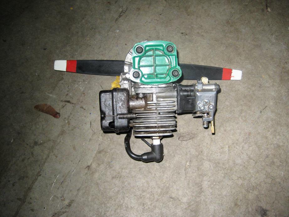

turns out what is pictured is a 21cc, oops. Took it apart to do some porting and measured it and it's not what I thought it was, while I was there I ported it anyway. Exhaust timing was at 135 stock and intake is at 110. While there I widened the exhaust port a little for good measure.
now to grab an actual 18cc and get it fixed up
EDIT:
pulled out a real 18cc, their intake duration is the same as the 21, but the exhaust duration is a pathetic 120*. I had thought the 18cc and the larger engines were the same jug casting, but the 18cc is built lighter, the cooling fins are smaller in some areas. I'll get a comparison in weights tomorrow.
EDIT:

I just got a SRM200 echo, will tear into that here soon, maybe tonight
man, jumping from 120* to 150* duration can REALLY try your patience... the port height nearly doubled. I will see if I can get a stand made up so I can test run these things.

You have lots of extra material on that engine. It needs to go on a diet, like the one I attached as a photo. Even so it is to heavy. I am thinking of suing mine on a swamp buggy.

You've got me worried about that comment.... raising the port so much. It shouldn't be that much. Each little bit you take off the top of the port raises the timing "double" because the port opens sooner AND closes later. Are you sure you are measuring the full duration from opening to closing??

well, maybe it seemed like doubling it's size, probably 1.25 to 1.5 times but it started out TINY, yes I did go from open to close. it didn't even go to the piston top at BDC. It probably just seemed further because I was using a chainsaw file (to go slow and more accurately) instead of the dremel... and I checked my progress like 4 times...
