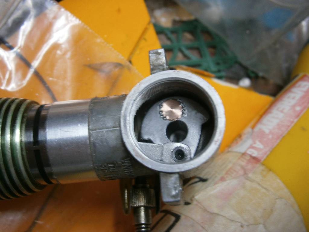

Fiery , I ran up your donor engine , its not too bad , I got sub piston induction by mistake and made about 3 pistons to get the fit and 2 goes at lapping the cyl , , It just would not seal , the plane is about 1/3 finished , The piston is very thin and the conta piston has 1mm between the combustion chamber and the tommy bar screw and its hollowed out , With this radial porting it looks like the transfer charge just goes straight out the exhaust, I might try a real steep domed piston or deflectors on the piston top ,
#80
Join Date: Oct 2005
Location: ACTAustralia, AUSTRALIA
Posts: 393
RE: Silver Swallow Pulldown
It didnt come up very well after the run in its a little loose , its got a lot of taper on the cyl and too much exhast timing and also sub piston induction that I dont want , I will fly it next week in the same model as my No1 Silver Swallow and see how it goes
its out to about 1.8 cc 's with a long crank like the first one and the 11mm longer conrod made it heavier
Its got a bigger counterweight in the crank shaft

I have given my Silver Swallow a flight clearance for this weekend
with a shaft timing like an OS 45 and 155 degrees of exhaust timing and an 8x6 prop it should run
I have already heated the piston to red hot and quenched it in oil 2 times , it was high tensile cast iron , I dont know what type
Its a bit loose but should start , I have to use an exhaust ring as most clubs have a muffler rule
Unless I fly down by the old steel rolling mill
The vibration is OK , its got a crank web cutaway and a 6 by 2.6 copper counterweight and a smaller piston pin than stock
I have run a 2.5 mm piston pin for a few tanks, on the ground, in a steel piston ,and it was OK but I made this one 3mm , in a cast piston
For my next cyl Im going out to 13.1 from 12.8
and in this one I have the biggest crank I can fit
I had to cut out part of the case as the rod was hitting

Thanks for the Photo Loctite,
they can be dissapointing , mine took about 45 minutes to start this morning and when it did it ran OK but not the power of my first Silver Swallow ,
its too loose and leaking and the exhaust timing is high , for a big prop
I will make another piston and move the cylinder down 1mm and remove the sub piston and recut the shaft timing to what PE says is a good sport diesel timing 130
155 is too much
and from what I read shaft balance is a waste of time on 1.5 diesels, that dont rev , so I can leave that off
The hard part is the gas tight fit
the rest can be rough enough, and will run
The cyl ext might come off and I will put the engine on a diet and get some weight off
155 is too much

I should have one ready by Sun
It will have a 2.5mm piston pin
and Ive hogged the bore out with the lap 0.5 mm very messy and long
and removed the cyl spacer and the new piston will drop the exh timming way down near 130
with no sub piston, induction
Im hoping to get a seal so it takes better than 45 minutes to start , that was tedious

Yes Mr Ragla , I like pain , and there is plenty of it here
its the 1.5cc , Im doing by the way
the ones Fiery sent me
With a new crank ,rod, and piston and contra this one might run , its got 140 exh timing and 25 degree cone on the piston top , stock is 21and no sub piston induction the fit is loose half way up compression and then its good the rest , it burps in the garage so I think its a goer
Its got a tiny 2.5 mm piston pin that might break , but Im hoping ,
Im running it tomorrow

Amazing , It was quite tight over the top and no seal above the exh for about 3mm but it runs OK and with 7 flights its still tight , It had to be heated to start , no cold start
Tunes well doesnt sag or get hot , and this one start at full comp I dont have to back it off like my first one
