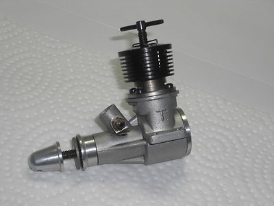

I had the Tyro out for a run yesterday, after a long stint of bench warming.
It started straight up, as expected and pulled the model strongly for about 1/4 of the tank, then it gave the impression of the comp going soft.
On closer inspection the bolts securing the cylinder had come loose.
Back in the workshop, a good clean and a liberal dose of Locktite has it back together. We'll see later if this is a permanent fix.
Disappointing as I love this little motor.
Greg

Greg,
I'm guessing that the Tyro has the same self tapping cylinder screw system as the Series 12 and 13 Taipan diesels?
They were fine till the first strip down then they needed to be drilled and Tapped for 5-40 UN socket screws. The latter needed their head diameter skimmed.slightly.
!/8' Whitworth also works but the socket headed screws are harder to get.
Ray

Ray,
I was thinking that, but on inspection the holes seemed OK.
Time will tell. I plan to give it a run soon and see what the damage is.
The drilling & tapping part is the easy bit, grinding out the hardened cylinder flange is the tough part.
Any thoughts on that?

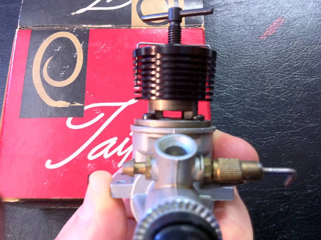

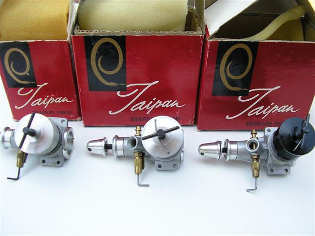

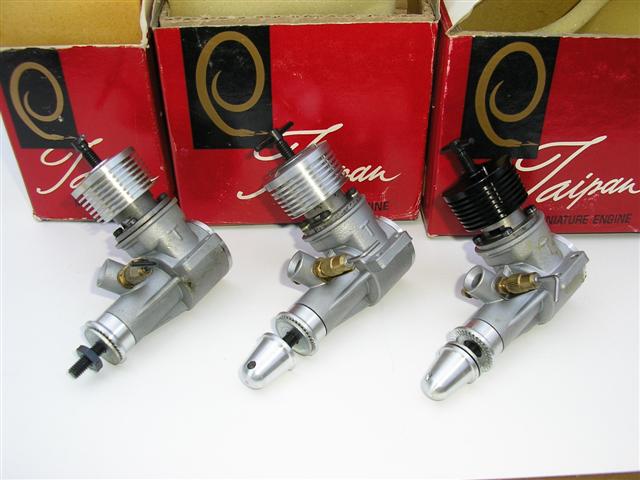

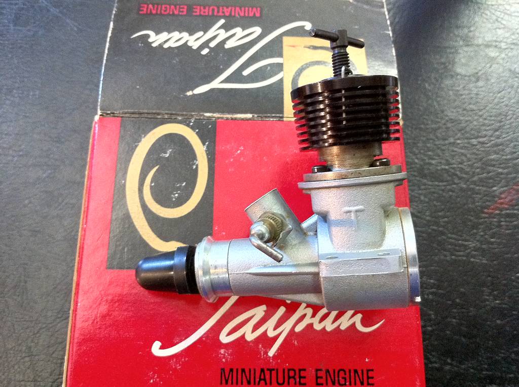

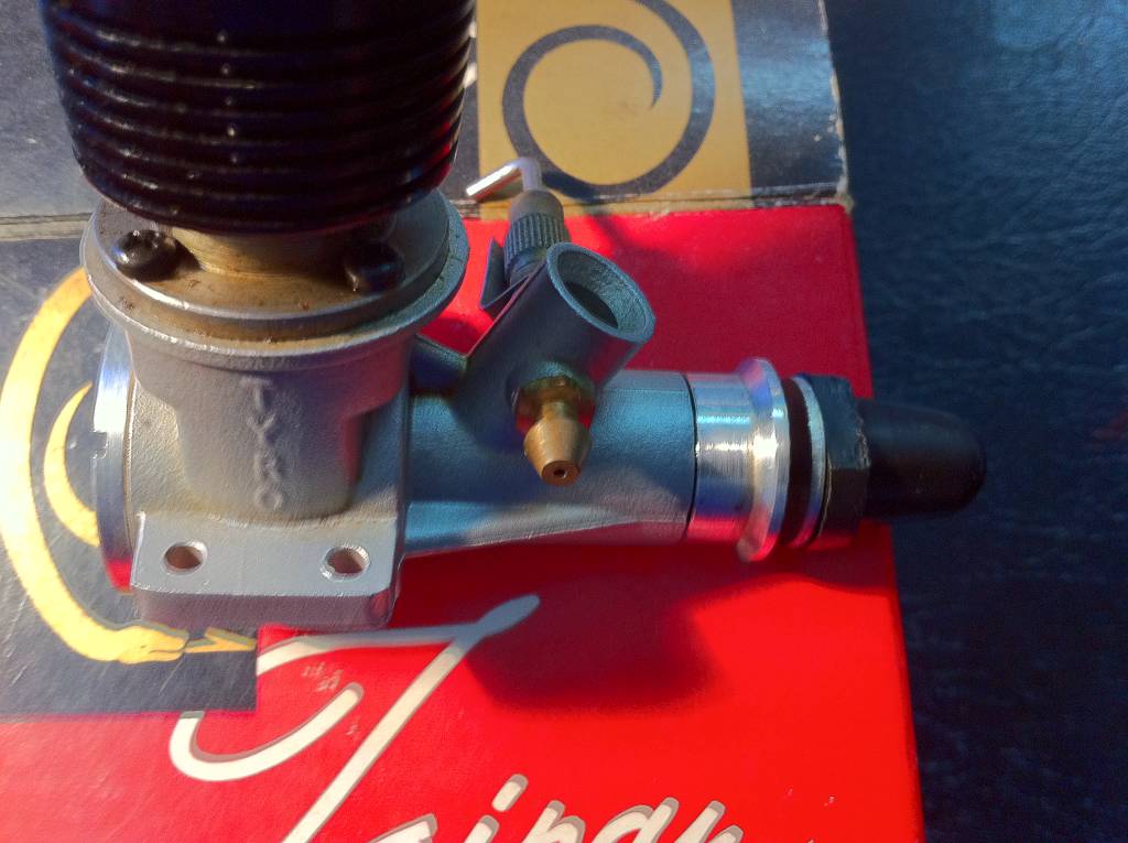

A late production example. Also three NIB Tyro's from different stages of production, early, mid and late.
Lastly, some photo's of my unrun example and box. I have an exhaust manifold/collector ring for it NIP.

Greg,
if you mean because the screw heads are in the way, then you reduce the screw head diameter as much as possible.
Ray

No Ray,
I mean the diameter of the larger screw itself is bigger than the hole that exists in the cyl flange.
I have come across this with the Mk 12/13 I have. (No, not your one!)

Aha bro!
Just stick Mr Liner in Mr Three Jaw Chuck, tighten gently, and drill out holes with a twist drill mounted in an 'lectric drilling machine.
Twist drills are much harder than Burford liners.
Ray.
PS don't turn on Mr Lathe while drilling!

Ran the Tyro again today. Happy life.
The Locktite was enough to hold it all together.
Thanks for all input.

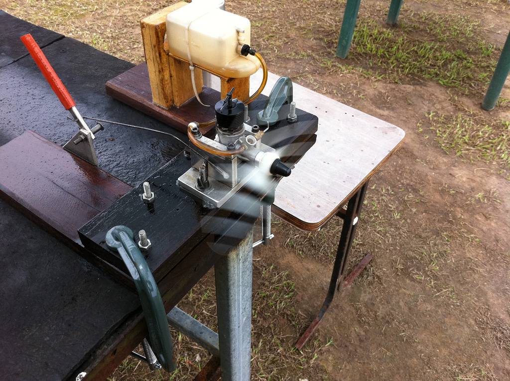

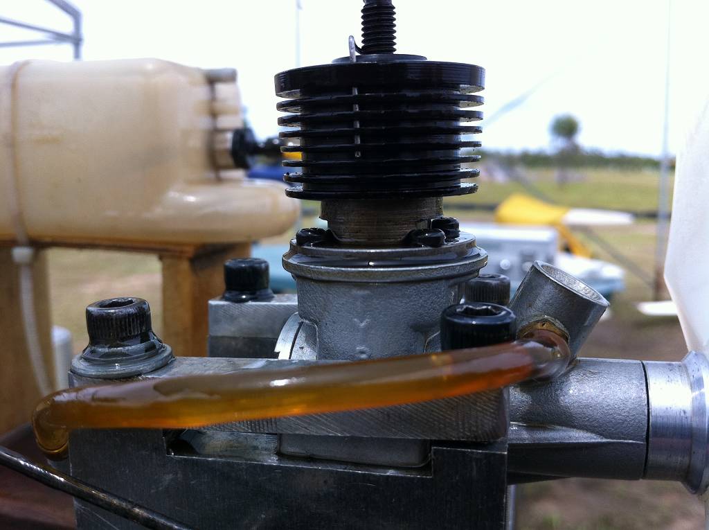

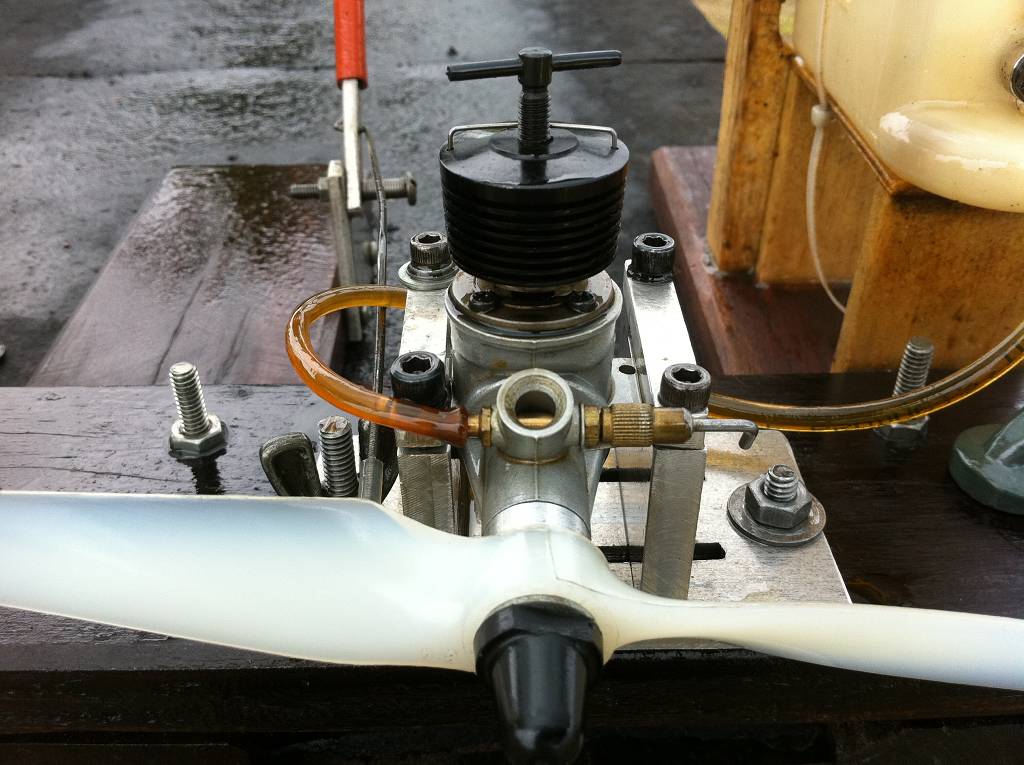

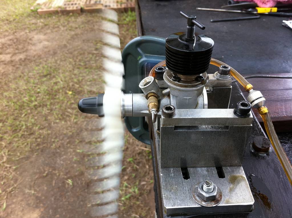

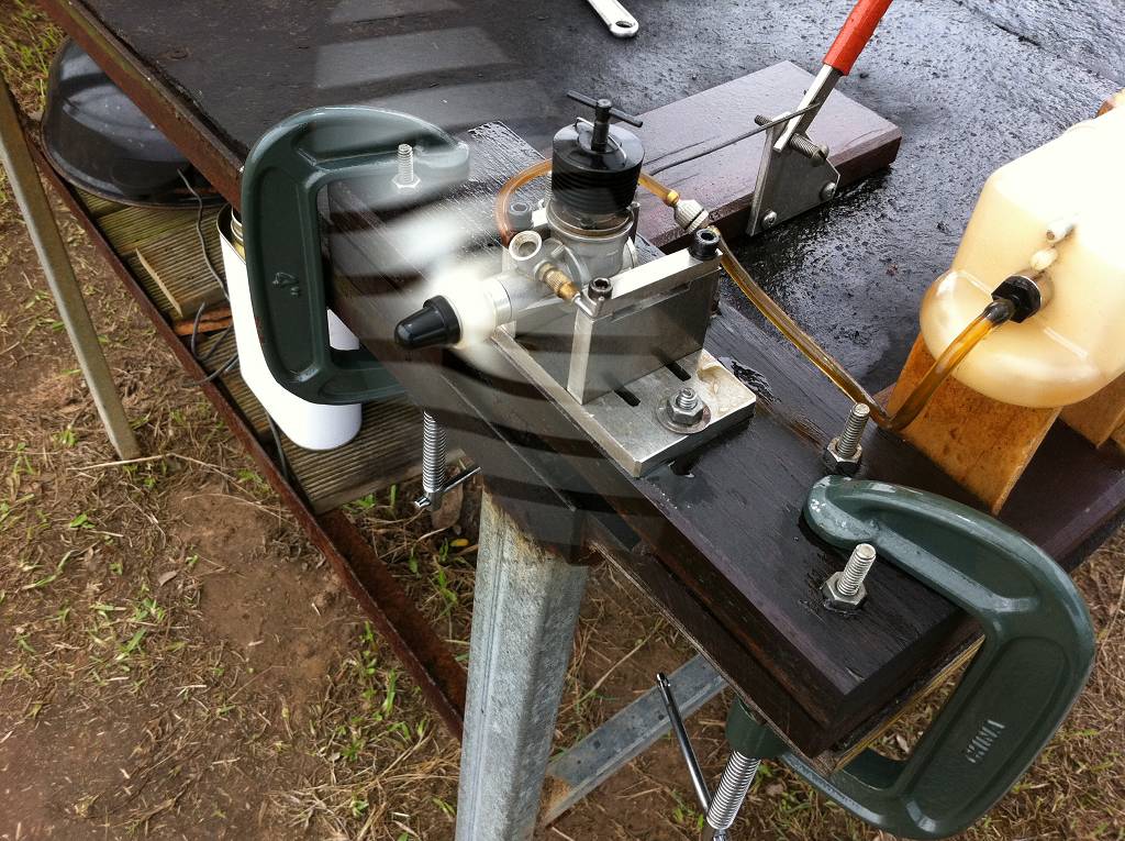

Decided to give mine it's first run. Very happy with it.

sounds nice quiet guess you are running rich for the first start good idea martin
