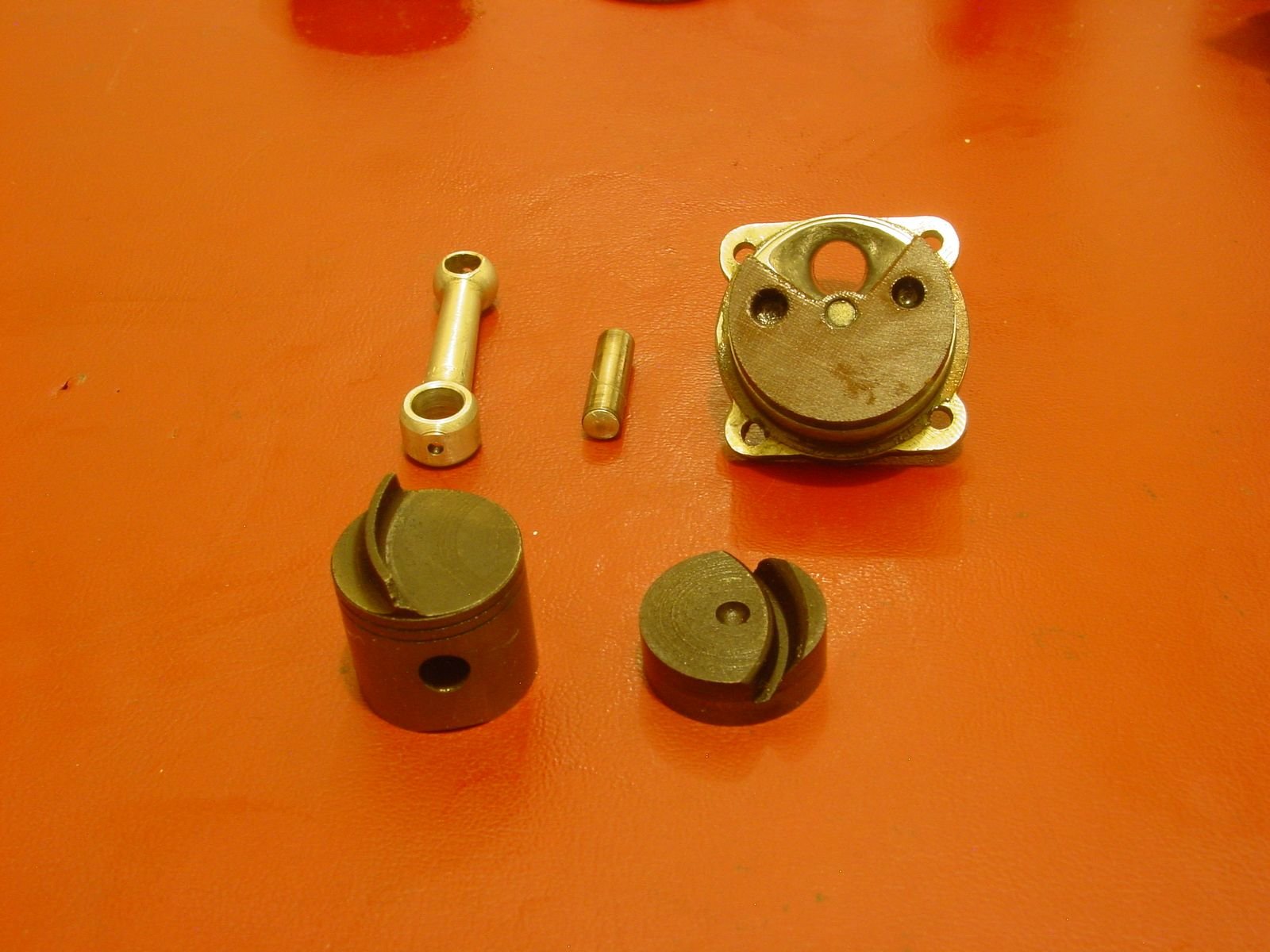

Thread resurrection can be fun. Love your descriptor.
This is an interesting thread.
The dissassembled example is mine. Sophisticated and rare. It will be renovated.
Note damage on the tip of the crescent baffle. You can just see where it has hit the recess in the contra piston.

So much intellectual effort expended in this thread!
Yes I noticed that. You could just clean it up and reassemble. Suouldn't make that much difference. I'm wondering why they went to so much effort to add that feature in the late 1960's. It doesn't look like a high performance engine, and there weren't any secrets in running a crossflow, flat topped piston diesel by then. What stops the contra from turning?
The baffle and head fit reminds me of the deep piston skirt groves in backplates like in say Rossi engines.
I love those hex headed head bolts. You can still get those in BA sizes at local "Live Steam" Model Engineering suppliers like Earnie Winter at Bathurst.

Yes.
From what I can find, it appears power was in the order of .35 hp or thereabouts. Not stellar performance. A good Miles Special 5 c.c. has more.
There was a glow version that was much more powerful. It was used by Polish competitors. It put out a reputed .5 hp.
The hold down screws are metric in mild steel. Exact pattern replacements will be machined from a high tensile steel bolt.

Doesn't surprise me with no obvious attempt made to pin the contra against rotation. Likewise I can see no reason for the holes in the topside-unless it was some misguided attempt to balance out the thermal heat capacity somewhat...

A close sliding fit 'peg' dowel coming down from the top of the jacket can engage a hole in the contra piston throughout its useable travel to effectively stop rotation.

Clever! Love to see a youtube video of it running :-)

Ray
That is the intention. Bottom end is good. German races are nice and smooth. The pulverisation of the baffle tip caused particles of cast iron to lap the cylinder. It needs a rebore. I have asked Mr Fletcher (whom I trust implicitly) to do that and to look at replicating the curved baffle. He supplied the photographs shown above. Anodised parts will be cleaned back to bare and re-anodised.
As grandad told me when I was a pup, you don't spoil the ship for a ha'porth o' tar.
