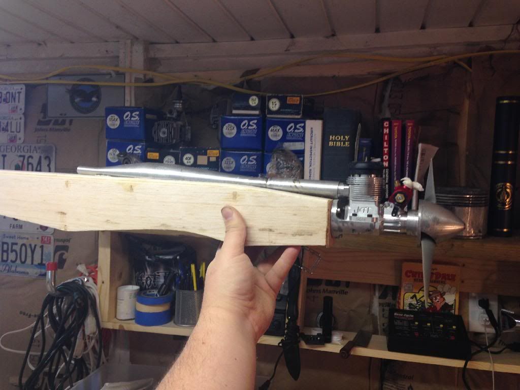

I've not been very active in R/C in the past several years, but now that I've bought a house and built a room just for the planes, it's time to build!!!
A few years ago, I called up Jett and had an engine built. I thought I would have the time to build, but then I changed jobs, moved five times, and all but abandoned the hobby. That dark chapter is over and I'm ready to fly. I started with cutting a few foam cores that were 6%-8% in thickness, double tapered. I ended up tossing out most of those attempts because I just didn't like the way they were coming out. So I've decided to go in a much easier and quicker direction and modify an existing design just to get something in the air. I'm calling it Project Voodoo without good reason. It sounds cool, I guess.
Engine: Jett BSE .56LX F.I.R.E.
Airframe: Modified Hobbico Viper RTC
Planned modifications: Clip wings to 40" span, no landing gear, modify fuselage to accept a rear exhaust and tuned pipe, built-up 3/4 cowl, significant carbon fiber and fiberglass strengthening.

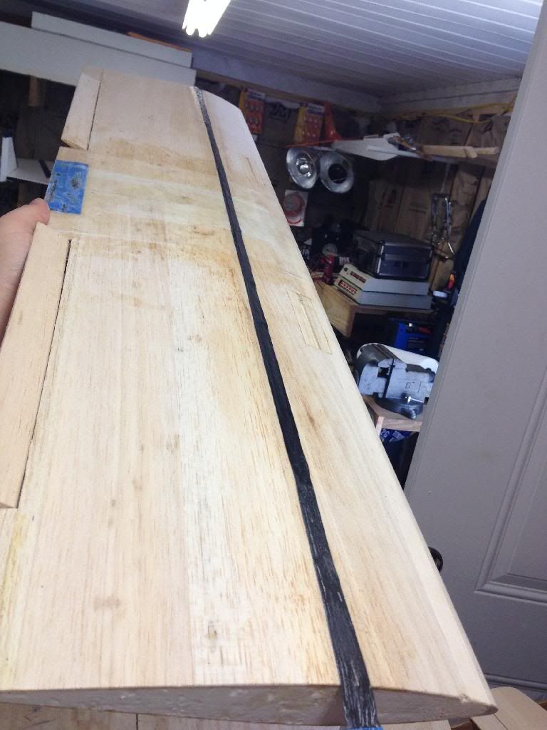

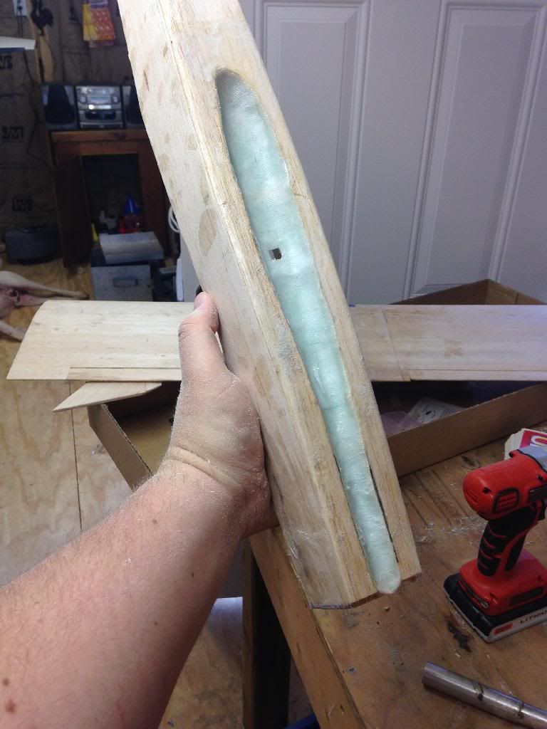

I started with the wing. While the fiberglass is setting on it, I started on the fuselage. I cut out the shape of the tuned pipe on the top, then put in some insulation foam. I used a dremel tool to shape out the curve, then I put in fiberglass. When it has cured, I'll go back and get the foam out with acetone.

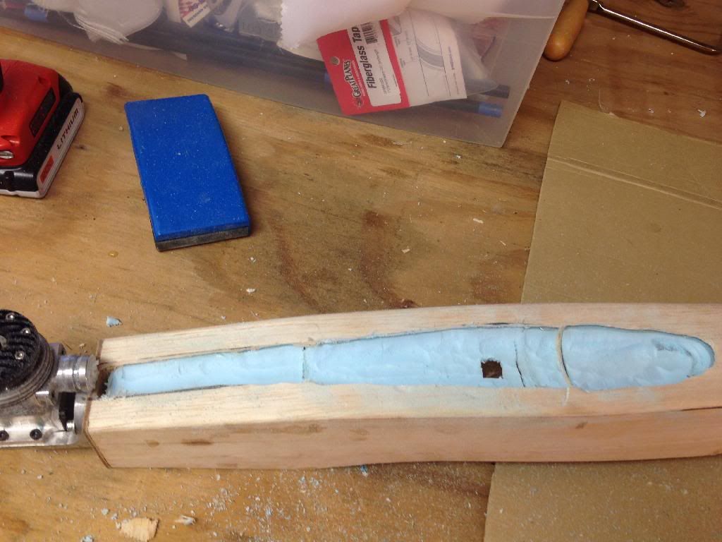

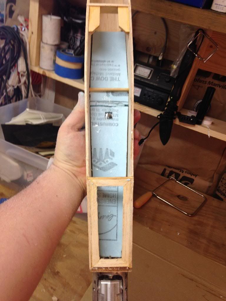

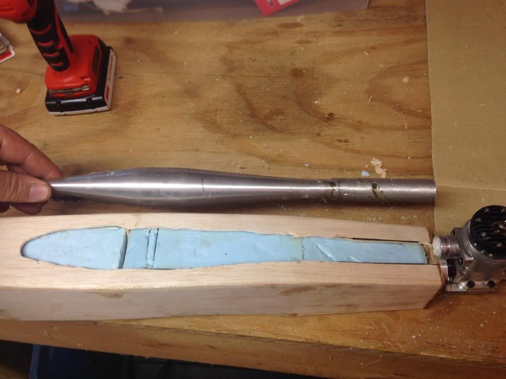

I thought I had acetone for the foam, but I guess that was lost in my last move, so I used my heat gun to remove the foam.
Here's how the underside of the tuned pipe tunnel turned out. I think there should still be plenty of room for my radio gear and fuel tank.
