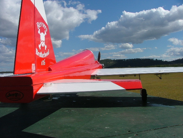

here ya go. These were provided to me by Tony Asmus over in Australia.
Its a nice plane. Comments on this particular one were that it flys very well.

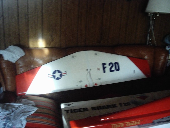

SOme pic Of my f-20

The photos that Bob 27s posted was my F20, but she is no more unfortunately.
If you are serious about the 20, make sure you replace the control horns supplied in the kit as this is what let go on mine. It sheared off where it "T's" to the mounting plate, with the aweful sound of elevator flutter just before a large bang.........& nothing left. The elevator control linkage is a funny angle, & I think this may have something to do with it as well. As Bob said I had to reshape the engine mount to fit the SJ 50 into the mount as well.
The model itself was well put together but just had a few little things that I would change now in hindsight.

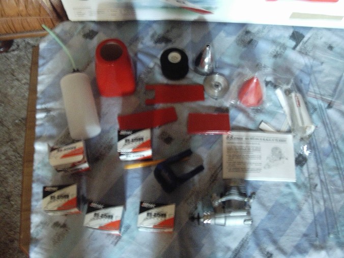

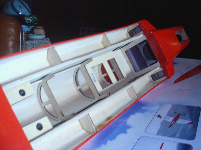

Hey Flip , I started my build last night dont know if these photos help.. but I think the quality is good, my only other phoenix plane was a trainer which I was very happy with.. the only thing I dont like is some of the hardware I think some of the metal push rods are to weak so I will upgrade to2-56 and the only other mod I have done is to purchase Robart control Horns after the above mentioned failure.. and seeing as this isnt an all out speed plane at the very last second I changed my engine choice. I did buy a Jett 46 for it, but have now opted to fit an OS 50 sx.. I'll save the jett for my Diamond Dust which is going to be my next project on the table

Thanks for the PICS HaveBlue. Does it look like a fast building ARF, my Phoenix Sukhoi went together in about 6 hours using 5 minute epoxy. I see you also purchased an aluminum spiner? Keep me posted, mine will prolly arrive this Thurs. or Friday. Unfortunately I will not have the engine back for it for prolly another 2 weeks ( I had to send it back for warranty).

yeah I think this is a quick build , and could be done in 6 hours ..its typical of todays arf's. I bought the aluminium spinner as I did intend to use my jett 46, but even with the 50sx I will use it just to play it safe.
the wing panels could easily be modified for retracts , something I might do a little down the track especially if the nose gear is compatible to accepting a retract unit but I havent had a good look at that yet
I might add wing tip missiles too, even though it's more drag I think it will enhance the looks a little.
I didnt get much done today , just hooked up the aileron linkages but hopefully will get her ready for the weekend maiden flight..will let you know how it goes..although I dont seem to get much time to go fly nowadays, I'll see what happens.
hope your's will be a quick build and keep us posted of how it goes
as for the wing panels though I would use at least 30 minute epoxy for a strong joint, some like to glass the center section but I dont think this one needs it

This Bites, I got my F-20 Thursday but because of work, college, and a baby on the way I didn't even get a chance to open the box until Saturday. I seen the cover on the fuselage look like it wasn't sticking all the way on toward the back, so Sunday morning (today), I broke out my iron and started ironing the covering down on the fuselage. As I kept trying to iron it down I noticed it looked like it was a funny shape. I looked down in the fuselage and notice it had 2 cracks in it like some one had squeezed it and cracked it and that's why the fuselage covering looked funny. Also, the covering on this model was NOT close to the quality of the Phoenix Sukhoi. I have to wait until Monday to see what Tower Hobbies wants me to do with this.

Crash, thanks for the info on the spinner. If you read my last entry you'll see I have to send my f-20 back, but I will definitely get that spinner when I get the plane back.

How annoying.......
Hopefully Tower will do the right thing by you. With my 1, I couldn't fault the covering, it was alot better than other companies offer.
Goodluck,
Tony.

good to see you back Crash, and a bummer about your F20 Flip hopefully Tower will do something about that..
there was nothing wrong with the covering on mine , hopefully an isolated incident
