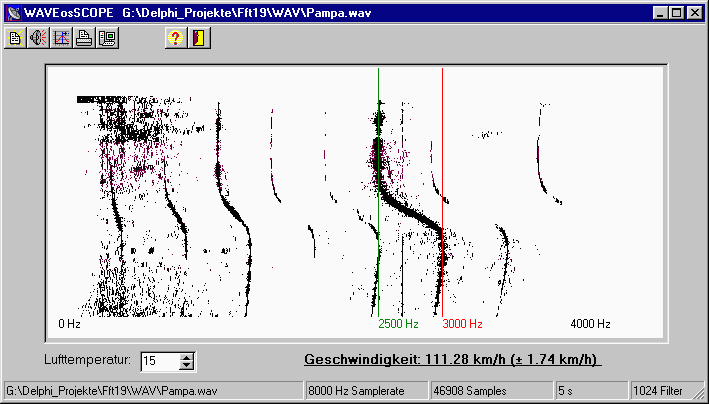

Hi all,
Does anybody know WAVEosSCOPE ? I found this software yesterday, it 's more convenient than the usual excel sheet.
It seems fairly simple and accurate (I've tested it against know speed sounds).
Major drawback is that it's in German. However, it's possible to have an english version for those interested.
Any users here ?
http://www.sprut.de/electronic/soft/scope.htm

And by the way.. it says on the site 10 seconds are enough for a good measurement... I don't know what speeds these guys are doing, but 10 seconds for me on a straight line would be a plane out of sight.
My experience in this matter is that you need about 1 second for a good pass, providing you do a good low pass (about 3 to 5 feet) over the camera... the lower and the straighter (the means constant altitude too), the better...

I used this program last year when I built my Patriot with YS45.
This is the translator I used;
http://babelfish.altavista.com/
Just copy & paste what you want translated.
I made three passes, the program said it was going from about 124mph low to a high of 137mph. This program will also give you a readout of the rpm which said I was at about 17,000 rpm on these passes, I was launching at about 16,400 rpm so when it unloads it probably is right around 17,000 rpm. Don't know how accurate this program is but I'm pretty sure I'm doing at least 120 mph.

The wav files delivered with the software are way shorter than 10 seconds... I don't have any wav files. However some french friends confirmed its accuracy (tested against well know speeds).

Where do you place the 2 vertical lines (the red and the green one)?

Post #1 is pretty clear in where the placement of the red and green lines should be the data line, but what is not shown is that it dosnt matter what data line you choose to analyse, they will all give you the same result - try it, you will soon see you get the same number. The ones further to the left however will give you a higher error than the ones further to the right. So you basically want to pick the clearest one furthest to the right for the best result.

OK. I must be making a mistake - not surprising since I know no German. I downloaded the software and tried their .wav files. As you move across the screen (moving red and green lines) I get wildly different speed results. What am I doing wrong?
As Gilda Radner used to say - "Nevermind"...... I was trying to measure from one waveform to the next. You actually have to measure each waveform individually. >Thom

Indeed, you have to measure one single waveform at a time and put the red / green line on the maximum along the horizontal axis. It works very well for me.

Hi,
Can someone tell me exactly what I am looking at, when I see those vertical curves (waveforms). I can see that the X-axis is sound frequency. Does this mean that all the vertical curves (waveforms) are harmonics? Are they all occuring together to produce the sound (i.e. all the vertical curves are being played at the same time, rather than sequentially)?
My main question would be this....
Is the Y-axis time (with the top of the graph being the beginning of the file and the bottom of the graph the end of the sound file)? That would make sense to me, as the Doppler shift does go from low freq to high freq as the plane approaches us.
Mike
My follow up question would be: Someone advised earlier to choose a clear waveform furthest to the right, as that waveform had the least error in terms of speed measurement. What is the physical principle behind that?

Hi Nick,
Let's number the 5 buttons from left to right (1,2,3,4,5)
Button #1 is the File Open button.
Button #2 is the listen to current file button.
Button #3 is the Update Graph button (that is a VERY VERY important button, it updates the graph after you've made changes to the Setup Button (Button #5))
Button #4 is the Print Graph (I never use it)
Button #5 is the Setup Button (after clicking this button, set the slider to 1024 FFT-- the graph will always looks best at this setting)
After starting the program, use button #1 to open a file (if that's not working then maybe the file u r looking at is not a .WAV).
If u have an error message, there are 2 possible reasons.
1) If the error message is "Fehler bei Bereichsprufung", the file is too long (the program won't work for audio files over a certain number of seconds/samples (like 14 seconds or so).
2) Or you get the "Division durch Null" error (which means "Division by Zero"). In this case you need to clip a tenth of a second or so off of the beginning of the audio file (using audio editing software), and then re open it (it always works for me after doing this quick fix). If the wave amplitude of the beginning of the audio file is too low (or zero), then the program errors out. A tiny clip off the beginning will yield a better place to start the file.
After the file is opened:
Hit button #5 to set the slider to 1024 FFT (leave the other boxes checked and keep the GraphMode in 2D)
Hit the Yellow button in the Set-up window to exit Set-Up.
Then make sure to hit Button #3 to Update the graph!!!
Then find the clearest, most complete waveform (that's furthest to the right), and place the red and green lines on the extreme left and right portions of the waveform.
Voila, you have the speed in km/hr! (multiply by .62137 to convert to MPH)
-Mike
