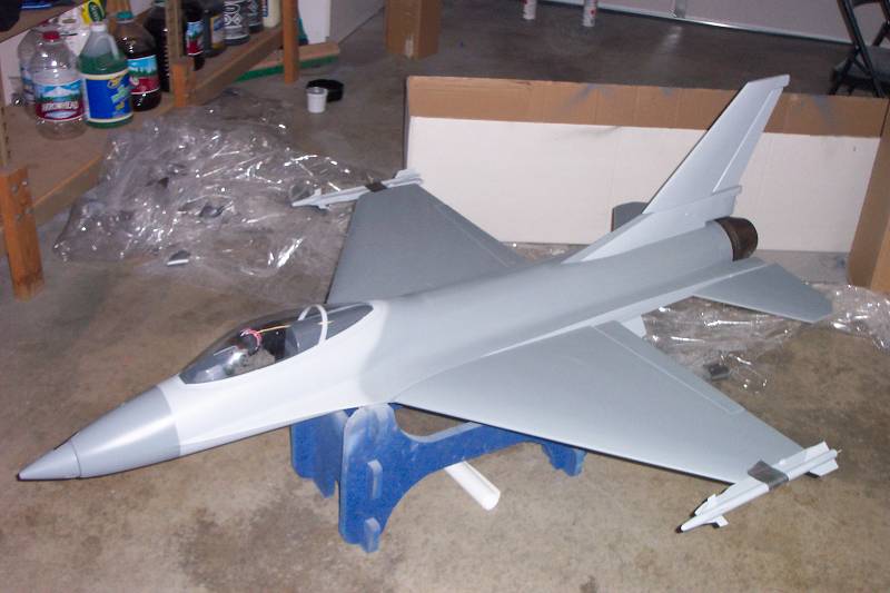

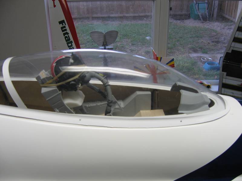

ive posted some of the workings of this plane in the other thread but i wanted to start a new thread up for this. Here is what i have done so far. obvioulsy the covering was ripped off and the wings have been fully sheeted. the wings, stabs and vertical fins have been glassed with 3/4 ounce cloth and sig finishing resin. the new botton fins are made out of 1/8 pyl and formed to the fuse. i used robart hinges for the ailerons and rudder. for the gear i used a robart strut for the front, and covers for the back. I have finally got everyting primed and ready to paint. hopefully next weekend if it is hot enough. The weight of the plane so far with the retract servos and steering servo installed is six pounds. more to come later. oh yah i have to give credit for this idea to my brother who is also working on one of these. this is my first time glassing a plane and he has been helping me through every step over the phone 2500 miles away. thanks bro.
ken

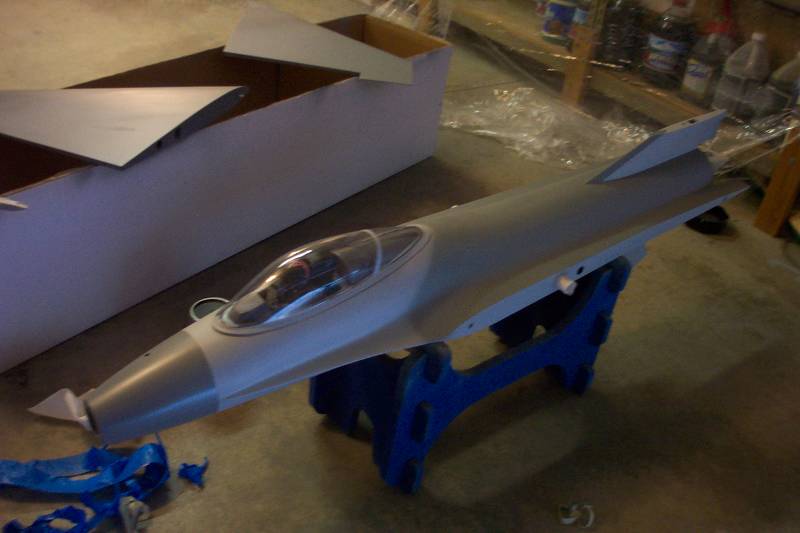

more pics

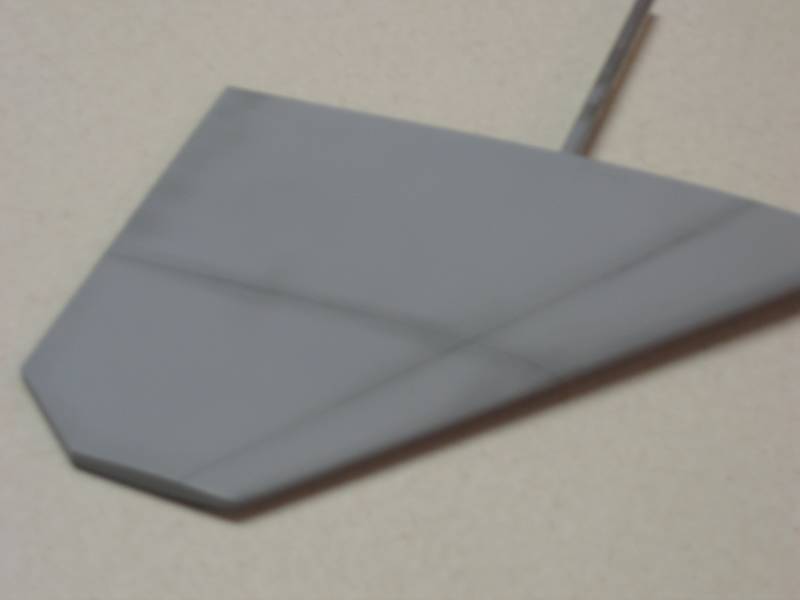

more pics

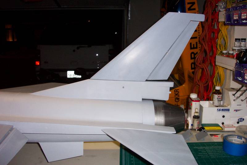

last pics for now

Geez, that really looks good in the grey primer! [sm=thumbup.gif]
Dust on some flat black Air Force stencils and it will be finished!

im goint to paint in the two tone grey and i have a full set of stickers for it.

Default RE: my cermark f-16 project,fully glassed
Where did the cockpit come from?

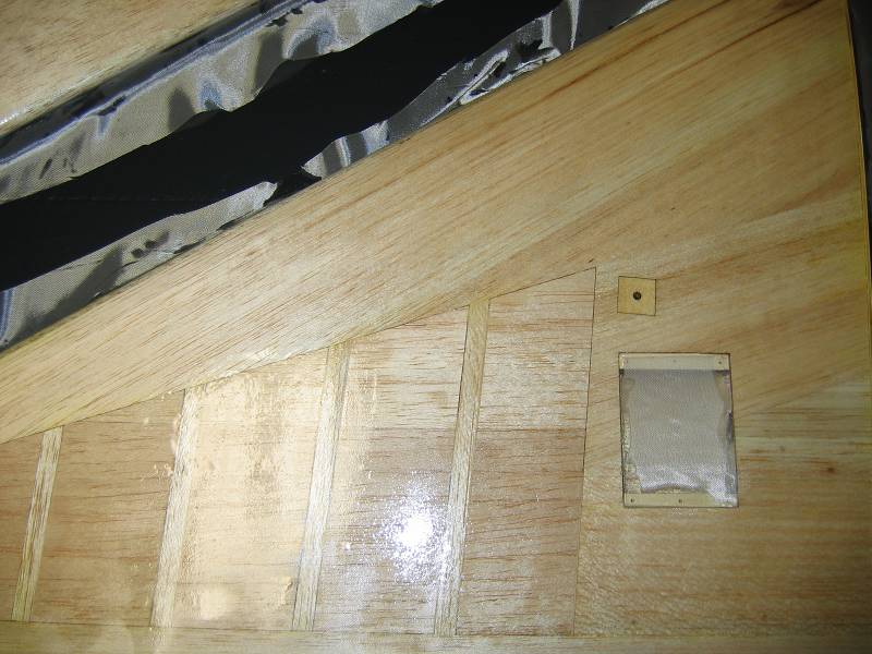

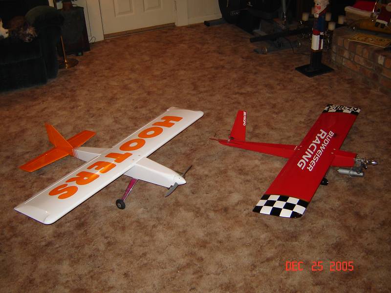

I know it may seem a bit off subjet not being a jet but I like to re-do arfs also. It takes a little elbo grease sometimes but it is worth it in the end. The white and orange hooters plane was a really ugly "ugly stick" no pun intended, that I completely rebuilt/ modified and covered. It will do all of a solid 100-105 mph believe it or not, fast airplane but it doesnt really look it. I cant stand cookie cutter planes so all I usually see when I get an ARF is a blank canvas, fun to fix up.

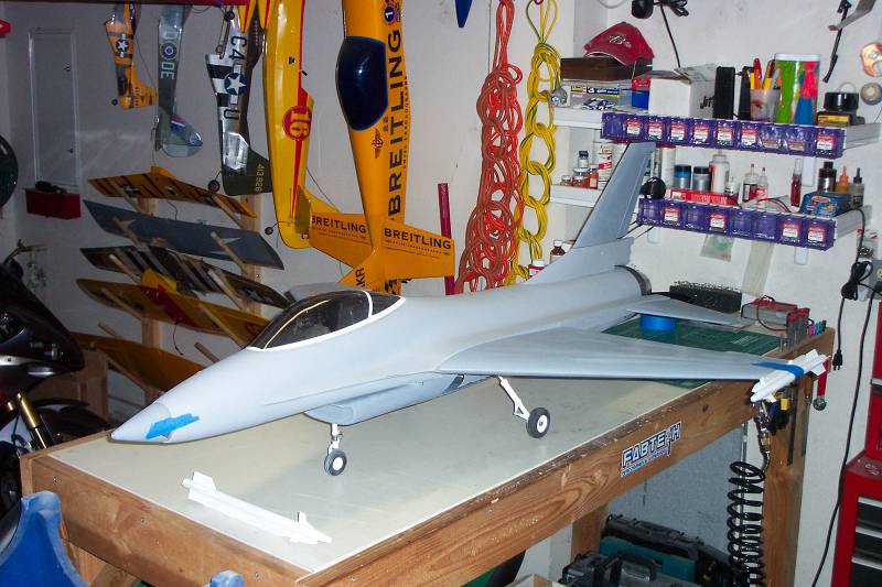

GUYS, The landing gear is just robart strut covers. the nose gear is a functional robart strut. The wheels are also robart with holes drilled in them. If you want to glass your patriot you will just have to finish sheeting the wings. We use 1/2 or 3/4 oz cloth with either Z-POXY or SIG finish resin. It takes time and patience but the end result is well worth it. For the cockpits my brother( Buddude8) is using pieces from a killer cockpit kit. Im using parts from an Italleri model kit. The pilots are from k B toys.
yes you mount it to the wood. I doubled up the mount with 1/4" ply. these pics are dark but if you look close you can see what i did

Default RE: my cermark f-16 project,fully glassed,now painted
just finished painting the f-16. I used ppg and used a airbursh. next will be the sticker kit, some weathering and clear. tell me what you think.
ken
put everything together and took a couple of pics. good thing this is a flat paint job. a couple of imperfections showed through, but for my first time airbrushing im satisfied.
