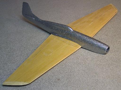

Currently we're building two Stiletto speedmodels at my local club. Maybe you're interested also, and therefore I came to the idea of starting a topic here at RC-Universe. Lots of speed fanatics are gathering here and it's always fun to follow somebody building a plane. Hope you'll enjoy it also!
The Stiletto is original a Club20 pylonrace model, powered with a .20 size engine with side-exhaust. Since I don't participate at Pylon-competitions it was possible to exchange the wing for a faster example. It's the same wing that is used on the Kasumi from Corvidae / Jet & Speedmodels.
The models were made from fiberglass and carbon to consolidate the model. Color was sprayed on in the template before adding epoxy resin and glass. Peter Pankras, who has made these models, has added glitter powder to the paint to give it a 'bling' effect. (Just like what they like on MTV )This gives it a very nice finish and looks very cool.

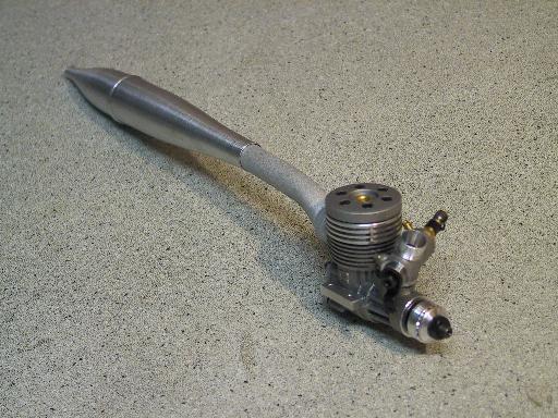

The cowl for the tuned pipe to reduce drag.

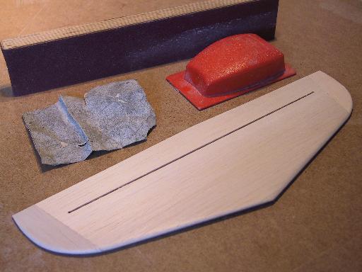

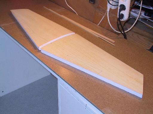

CNC milled parts from the stab's. It's made of 2 layers balsa with 0,3mm plywood in between. Laminated with epoxy and hinging material was added.
All the components. Styropor core with glass reinforcements between the top layer and core. There is also hinge material added between the top layer and core.
The stabilizer finished.

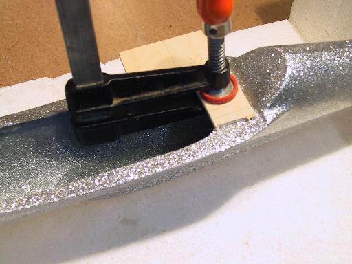

Jorrit's Stiletto. Quite a hell to make with the silver glitter material. After 5 minutes of laminating you lose track of what you're doing.

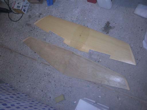

This is where the wing is made of. The 24 hours epoxy will be rolled on with a roller.
The epoxy after 15 minutes. It's a sort of foam that fills the gaps completely with a very strong wing as result.
The next day the epoxy resin is cured.

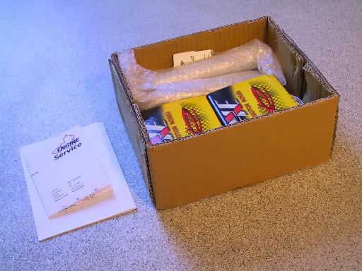

And the Stiletto's ware delivered. Both fuses are very nice. Great finish! Should be looking very cool with the colorscheme I have in mind.
The box, large package.
Unwrapped the materials.
2 masterpieces!
Package of small components with the wingtips, carbon strings, heavy glass, plywood CNC material and an aluminum engine mount for the Rossi 21.

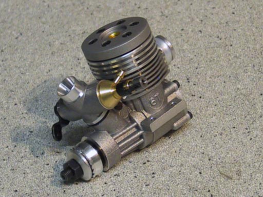

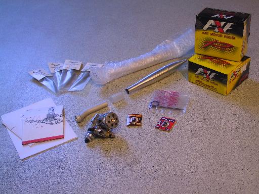

Both Rossi R21 engines arrived! Great service from RC-Technik! 4x APC 6,5x6 props included and 4x Rossi glow plugs R5 and R6.
Package with receipt.
All components gathered for the picture.

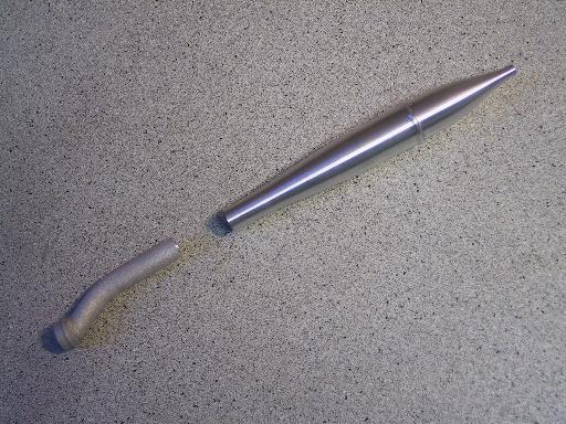

Silencer, which silencer? Open tuned pipe!

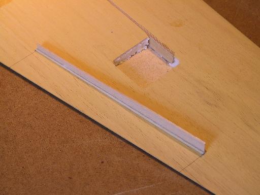

Pine-wood leading edge. Less fragile compared to balsa.

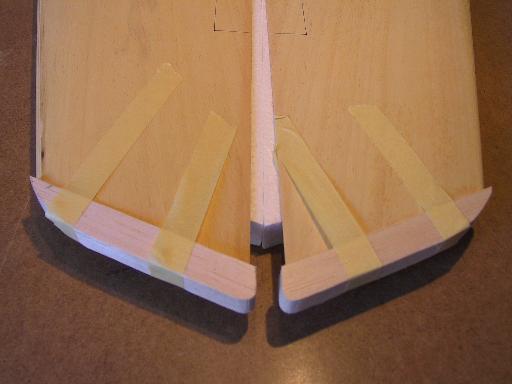

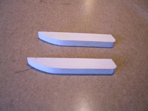

Wingtips sawed off and sanded into shape.

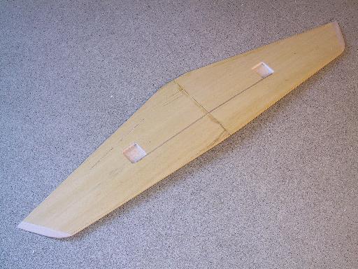

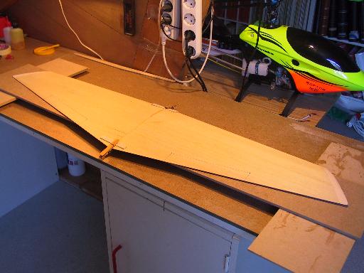

Both wings glued together at a 3° angle with some 30 min. epoxy.

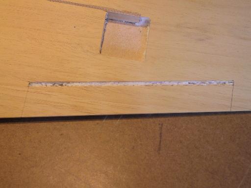

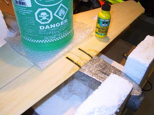

Gap for the wingspar.

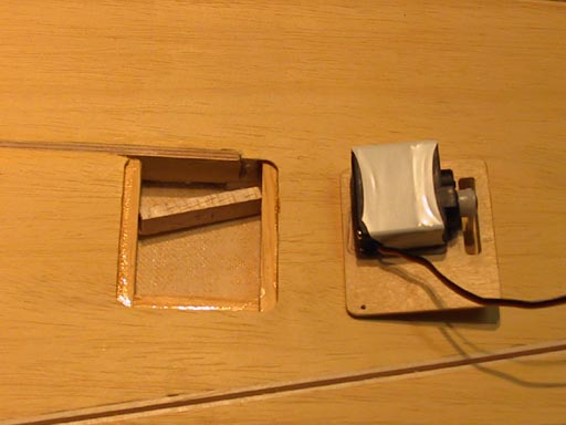

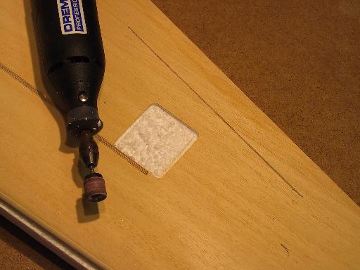

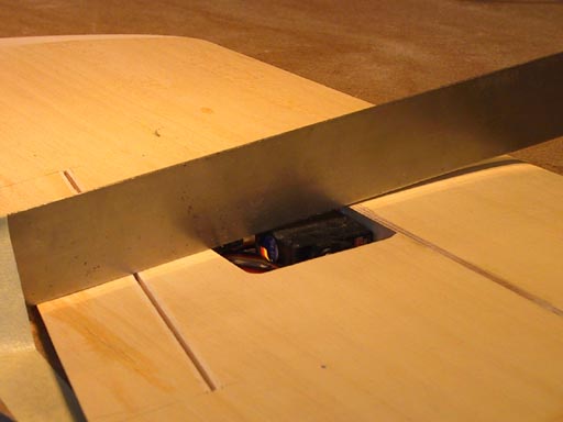

Milled holes free from styropor to fit the servos.
Both holes empty. Only problem is the location of the holes. The Hitec HS85-MG servos are too thick to fit inside the profile, and to fit the hatch on top. The hatch will be sticking out of the profile. The only solution I can think of is using aerodynamic pushrod plates.
Use personal protection while using G4. It's not good for your health.
Added some 80grams fiberglass to reinforce the wing.

I bought two Hitec Hs81-MG servo's because the Hs85-MG was to big to fit nicely.

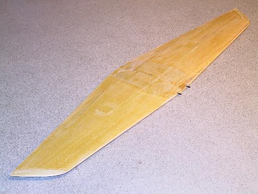

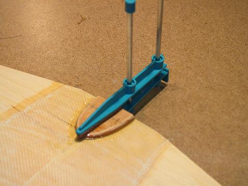

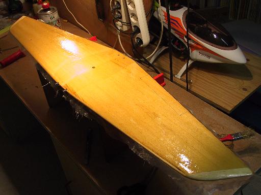

The wing, bottom view with fresh G4 and glass. I'm very sure this will work out very well instead of Epoxy.

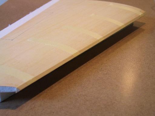

Upper side is also covered with glass.
Wing sanded and mounted at the fuselage.
Very nice result, very smooth.

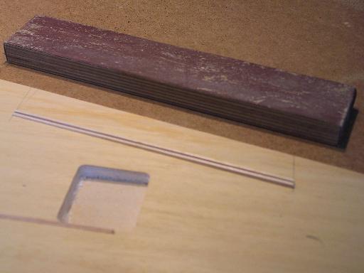

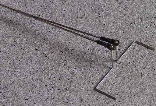

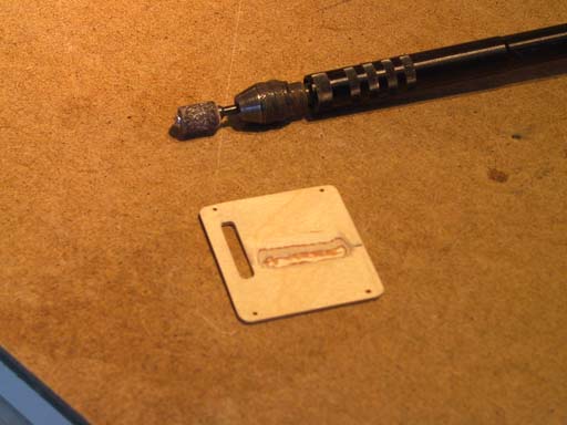

I was thinking about how to control the elevator. Using a Y-link is possible, but you need to attach 2 rudderhorns on each side of the elevator, which causes extra drag later on. What do you think about trying to fit the steering rods inside the fuse? It isn't possible to do maintenance after fixing the stabilo with epoxy, but therefore I want to use ball links. What do you advice? I'm not sure about the setup I'm planning to use.
Does anyone have any pictures or ideas how to get this problem solved the best way? I would be very thankful!
Simple drawing. Yellow is epoxy to fix the bended rods.

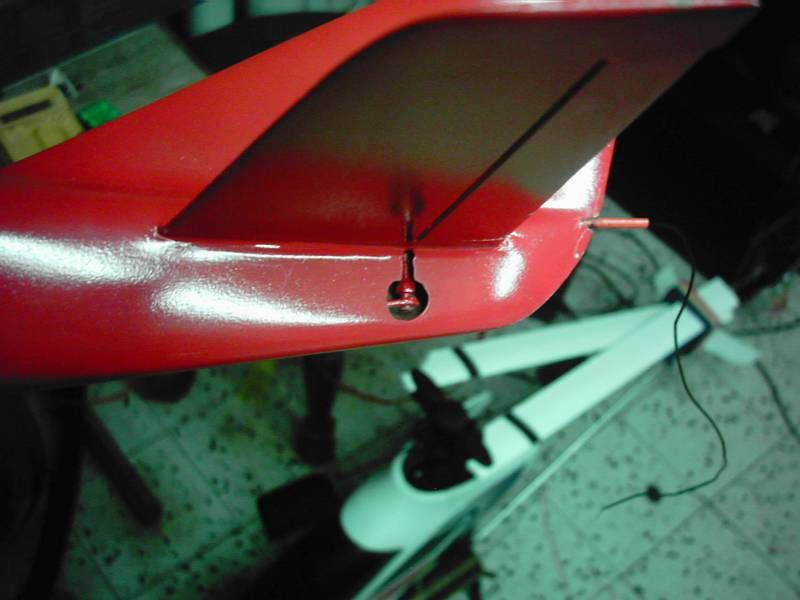

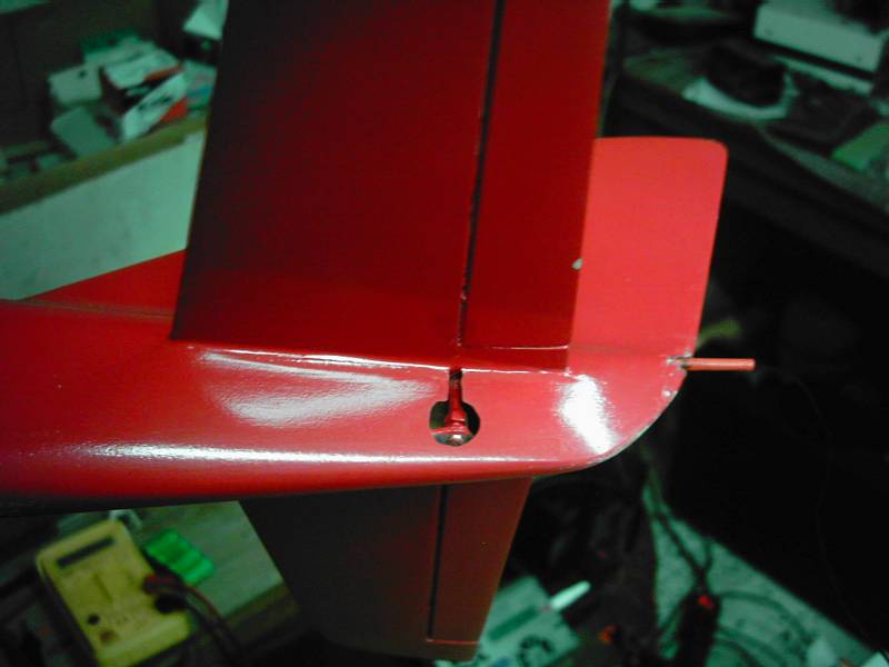

Do you have to have everything hidden inside?
If not, just put one pushrod to one side of the elevator and join the elevator halves with music wire the old fashioned way. You can put a fairing over the pushrod.

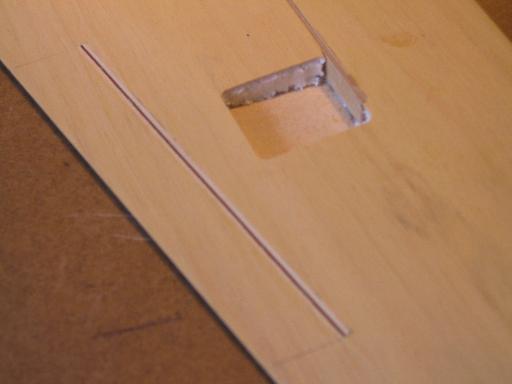

You don't need a split pushrod, do you? All you have to do is cut a slot in the side of the fuse, so you can insert the complete elevator assembly (with its "horn"). Solder a "ball link" ball on the elevator horn.... that way you can just push on the plastic piece of the link, which is connected to your pushrod, onto that ball...

Yeah, that is possible indeed. But I'm not sure about cutting a slot in the side of the fuse. Do you have a picture for example maybe?
My idea was to build in all the complete elevator assembly as shown below. Is this going to work out well on a model which should exceed 300km/h or 180 MPH? Isn't it going to cause 'flutter' because of any slop that may occur?

That would work, providing you use silver solder... don't use plain soft solder, because that is setting yourself up for a disaster.
But you would still end up cutting a slot in the fuse, wouldn't you? So you could just as well use a single pushrod...
Here are some pics... this is the elevator linkage on a Club 20 pylon plane. Works very well. The same type of elevator linkage is also used on bigger and faster pylon planes, so it is pretty much bullet proof. Just cover the slot with some tape when you go flying.

Thanks for the photos! It makes it all clear to me. I'm changing my plans and use a single ball-link. Since I don't have much experience with silver soldering I'm going to ask some people at my club to help me. I will try to build in the assembly without cutting a gap in the fuse side, but I'm not sure if this will work out well. We'll see. I always could cut a gap afterwards if it isn't working without.

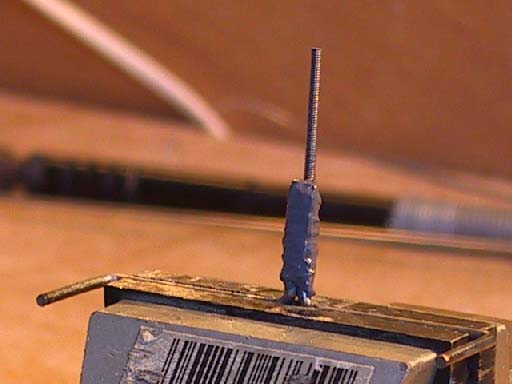

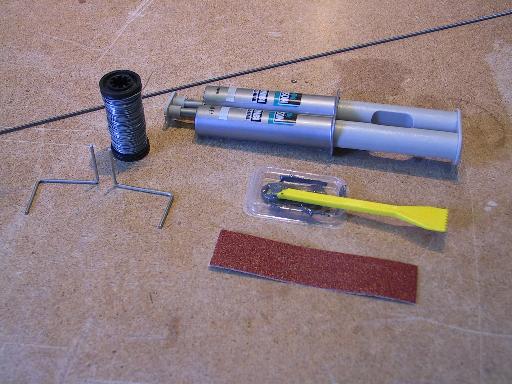

This morning I went to the local DIY-shop to look for a burner and some silver-solder. The cheapest items that I found were pretty expensive. The burner costs €23,- and silver-solder was about €7,- (about $37 together). It’s a lot of money for one simple elevator assembly. So I went for plan B, and bought a tube of Bison Metal Epoxy. Maybe this will work out as well. It should be resistant to vibrations and could cope with a lot of stress. We'll see. I'll test it firmly before mounting it on the Stiletto, but I think the M2 thread is going to be the weak link... If it isn't quite meeting my expectations I will solder it though.
The ingredients:
First I'd make small cuts with a wire cutter to generate more grip. Then I'd grind all components and clean them with some thinner. Afterwards I'd add the Metal Epoxy onto the parts and wrapped steel wire around firmly to give it extra strength. After adding another coat of Metal Epoxy on the outside I was quite confident that this is going to work out, don't you think?
j0rrit is offline

Thanks!
The Hs81-MG has a smaller casing compared with the Hs85-MG. The Hs81 has double ball bearings and metal gears, but produces a lower torque at 4,8v. The output torque is 2,6kg, and the 85-MG delivers 3,0kg torque.
Hitec Hs81-MG specs:
* Speed 0.11sec/60° at 4.8 volt.
* Torque 2,6kg * cm at 4.8 volt.
* Weight 16,6 gram
* 29,8x12x29,6mm (Width: 12mm instead of 13mm)
* Metal gears
Hitec Hs85-MG specs:
* Speed 0.16 sec/60° at 4.8 volt.
* Torque 3 kg * cm at 4.8 volt.
* Weight 19 gram
* 29x13x30 mm
* Metal gears
It should be fine. It has been used very often in Stiletto's and all other speedmodels from Corvidae / Jet & Speedmodels.

Default RE: Stiletto from Corvidae.net
I don't think I would trust the metal epoxy. I would go with silver solder.
buzzingb is offline
Reply With Quote
Old 04-17-2006, 01:29 PM
slowmo777
Join Date: Nov 2005
Location: Broichweiden, GERMANY
Posts: 69
Gallery
My Gallery
Models
My Models
Ratings
My Feedback
ORIGINAL: buzzingb
Ditto. Silver solder is a must.
Also please switch to M2.5 or better M3 thread size.
Just my two cents worth. Putting partial cuts in the surface of the elevator horn will induce stress risers which, under extreme vibration, will potentially end up with metal fatigue and a catastrophic failure. Don't do that!! Better to lightly sand the surface with fine (400 grit at most) wet-or-dry sandpaper. This will provide sufficient "tooth" on the surface for the epoxy to bond to. Better yet, use silver solder.
Regards, and good luck. Nice looking aircraft.

I'm going to look for some 6,5x6,5 Graupner props, but I like to compare some setups with each other. I hear Stiletto owners are quite satisfied with the performance of the 7*6w from APC. APC is still plastic, and with that amount of RPM's I like to go for carbon props. The Club20 guys here (same persons that make the MB40 engines) are making their own carbon props in moulds. When I meet them, I'll ask about the possibilities and measurements of the props. The carburetor is for the braking in of the engine, I will use a venturi while flying eventually.
The TruTurn spinners arrived today! They ended up quite expensive. Dutch customs added an extra fee of €20 euros to the whole package. I think they cost about €50,- euros per spinner right now. [] And they don't even fit! The crankshaft thread of the Rossi is 6.15mm (almost 1/4" ), and the TruTurn hubs have metric M6 thread which is causing problems. It is impossible to screw it together, so the spinner isn't going to fit. Even the aluminum bushing that came with the spinner is perfectly 6.0mm, so that is also a problem because it doesn't slide over the crankshaft threads. Maybe it's possible to modify the bushing untill it fits, but that doesn't solve the adapter-problem.
Maybe it's possible to get an unprocessed adapter from TruTurn and send them over to Rossi, so they can custom drill and tap the right thread?
Hits and tips are very welcome right now.
Hi J0rrit,
I believe the newer 3.5cc AXE Rossi's and Novarossi's have a 1/4"x28 threaded crankshaft, while the older 3.5cc Rossi's have
a 6mm x 1.0mm thread (M6). Even though 6.15mm seems too small a diameter to be 1/4" (1/4" = 6.35 mm), you may have
1/4"x28. The '28' is the number of threads per inch. A 1/4"x28 has a finer pitch thread than 6mmx1mm. The 28 threads per
inch corresponds to a pitch of 0.907 mm, which you can check with a caliper, or even check it is finer by just holding your
crankshaft against a known M6 screw. I can't believe Rossi would put a unique exotic thread on their crankshaft, it is almost
surely 1/4"x28. TruTurn also makes adapters for 1/4"x28 and a matching turned bushing for the spinner backplate is included
in the adapter kits, so there should be no need to customize an adapter yourself. 1/4x28 is very common here in the USA for
most engines from .21 cu. in. (3.5cc) through .50 cu. in. (8.3cc), and the adapters are also easy to get. If you have real trouble
to get them in Belgium, send me a PM; the adapters are small enough to put in a padded envelope and send with regular mail.
Just check / verify if the pitch of the crankshaft thread is indeed 0.907 mm, then you will know what thread adapter you need
for sure. Also measure the crankshaft diameter, as some engines have a larger diameter crankshaft stud at the drive washer
that then "steps down" to the thread size. TruTurn makes the right bushing for your engine too!
