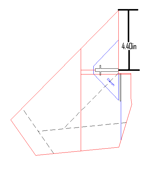

Full Flying Stab/Airlerators
The original kit uses epoxy bearings and control rods to move the elevators (See Figure 1)
Figure 1
My design will use 1/4 dia aluminum torque rod epoxied in the stab itself (See Figure 2). This is the same design as [link=http://www.savagelight.com/]savagelights'[/link] SU-27 ailerators but it's smaller so I scaled up the dimentions. Almost bought that one over the AKM but it's electric and I'm not ready to go there yet. The aluminum torque rods will be enclosed in a 1/4 in ID carbon fiber glide tube epoxied into the fuse.
Figure 2
I'm going to use control horns purchased from Cermark. These are the same milled aluminum control horns used in their F-16. I have not seen nor heard of a better control horn for high speed full flying stabs. Surprised they don't sell them commercially [sm=confused.gif]? Here's a pic of the control horns installed in the F-16.

Default RE: AK Models SU-27 Build Thread with many Mods
I'll put a link to this thread over at the old thread so all off us can see your progress.
I plan on doing the same stabilators set-up as you so I'm very interested to see how yours works out.
I do have one question, though. You say you're going to use the Cermark aluminum horns but you say they don't sell them. Did you get them out of a crash F-16? Or did I misread what you wrote?
Thanks for the thread
ORIGINAL: jetpilotrich
How did you come up with the location (forward and aft) of where to place the aluminum shaft? The weight and aerodynamic balance of the surface is important.
Rich
I started a thread in the aerodynamics forum to pick their brains on the best method. If you want to check it out: [link=http://www.rcuniverse.com/forum/m_4225798/tm.htm]CLICK HERE[/link]. They gave me a little insight and a good place to start, but I wanted to be sure so I broke out the calculator and got to work. My calcs showed it to be in about the same place as suggested. Did some more digging and found the best (and easiest) method by far on [link=http://www.airfieldmodels.com/information_source/math_and_science_of_model_aircraft/formulas/mean_aerodynamic_chord.htm]www.airfieldmodels.com[/link]
Here's a screen shot (Figure 1):
Figure 1
The rod must be placed 20%-25% on MAC to be effective. All three methods above yielded a distance of 4.40 in from the tip of the L.E (Figure 2). I shouldn't need to balance it since the rod will be located 25% on the MAC, but I am anyway just for grins . What's the point of going to all this trouble to do a half a@#ed job. I then plan to fill in the crevis created by the rod with 30 min epoxy. Lastly, seal the entire stabilator with medium weight fiberglass.
Figure 2

The Stabilator Mod
I've spent the last three days designing the stabilator mod and spent the entire day woirking on it. I think it might work.
Got the tail section assembled.
Once I squared the stab with the fuse, I drew refernece lines on it so I can quickly do it again later (Figure 1).
Figure 1
Drew another line where I plan to separate each stabilator from the stab (Figure 2).
Figure 2
