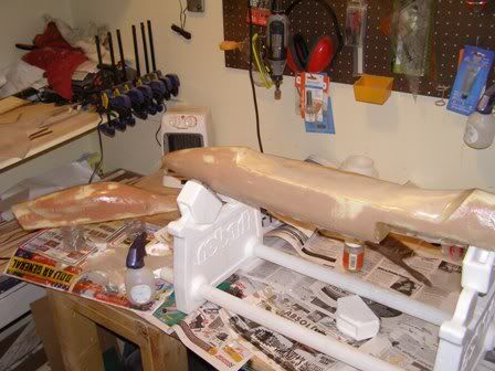

    Fuse Plug 5
    Summary
    I know what you're thinking; he's building on Christmas? I'm expecting my first child any-day now so I'm getting all the work in I can while I have the time [sm=wink_smile.gif].
    Began work on the boom plug and figured out that belt sander is one of my best friends. Using the sander and templates cut down the rough shaping stage to about two hours. I did finish glassing the fuse plug and should be able to shoot the first coat of primer tomorrow.
    Construction
    First, I glassed the underside of the fuse plug with another layer of 5 oz fiberglass (figure 1). Then, printed out a few full scale images of the tail boom (figure 2).

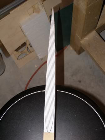

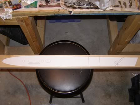

    Second, I cut out the boom shape, minus the fin, and glued it to a stick of 1" wide basswood (figure 3). Then, I cut around the outline using the belt sander (figure 4).
    Figures 3 & 4
    Third, I printed out another template of the fin and glued that to the top of the boom plug and sanded it to shape (figure 5). Here is the boom after two hours (figure 6)

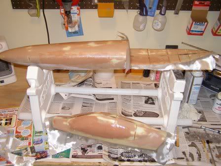

    Fuse Plug 6
    Today I applied a few coats of K & B Epoxy primer to the fuse plug for weave filling (figures 1 & 2) . I mixed 1 part white paint, 1 part white primer catalyst, and 1/2 part reducer to achieve a spray able texture. I used the K & B reducer, but after one smell I noticed that is just high grade lacquer thinner; so I'll probably try using that next time since it's cheaper.
    Figures 1 & 2
    My spray set up is typical with the 8 gallon compressor and HLPV spray gun (figures 3 & 4). Both were purchased from Harbor Freight, but the gun was half off at the time ($32.50). Both worked great for this activity.
    Figures 3 & 4

    The plug now has more definition and the hatch seam is almost invisible. I learned the "invisible hatch" technique from Mike James' website www.Nextcraft.com. He is a master of composite fabrication and his site has a virtual smorgasbord of information on the subject. I highly recommend it.
    Construction
    The plug as been rough sanded since the first coat of epoxy primer, so I figured it would be best to tackle glairing hatch gap before going any further in the plug making process (figure 1). First, I applied a layer of Monokote iron on film to the bottom of the hatch and applied two coats of Part-all wax to the film (figure 2). This was followed by a thin coat of Vaseline as a ghetto style release agent.
    Figures 1 & 2
    Next, the hatch area of the fuse plug was masked off leaving approximately 1/16" space from the edge to allow for feathering (figure 3). Then, a large batch of west systems epoxy mixed with colloidal silica was applied to the hatch area of the fuse plug (figure 4). Lastly, the hatch was positioned on the fuse plug and the excess filler was removed. The entire plug was sanded again after the epoxy reached full cure (figures 5-8).
    Figures 3 & 4
    Figures 5 & 6
    Figures 7 & 8
    Then, a razor blade was passed along the seam making sure to keep the edge perpendicular to the vertical (figure 9). A coat of primer was applied to view any imperfections created by the above steps (figure 10).
    Figures 9 & 10
    After both components were separated, I tack glued the hatch to the fuse with four drops of thick CA in each corner. The hatch will not be removed again until the last coat of epoxy primer is applied just before the mold is made. Just to give you an idea of how well the hatch fits, here is a view of the hatch installed and then removed. If you squint, you might see the seam and it will only get fainter as the sanding continues.
