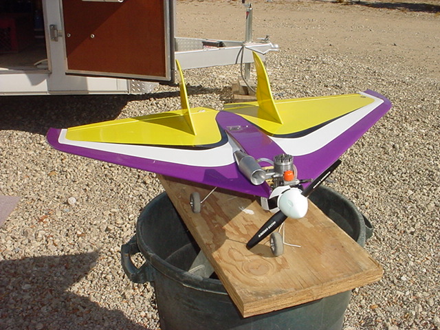

It appears that the engine thrust line is excessive. Has anyone changed this closer to zero, zero? My shrike was at zero, zero with my Jett 46, it flew ok.
Just wondering if the angle of thrust is needed? I know at slow airspeeds and quick throttle up, r thrust helps.
thanks,
rcs

The plane is very short, having no fuselage. It also has a closely spaced landing gear.
Add to that, it has no rudders. I think the right thrust is necessary. Normally I don't
incorporate much right thrust...a tad perhaps with a tail dragger.
I maidened my Mach Racer a couple weeks age, and it seemed dead-on.
....I would leave the right thrust the way it is.

I'd leave the right thrust alone... it seems dead on to me also.

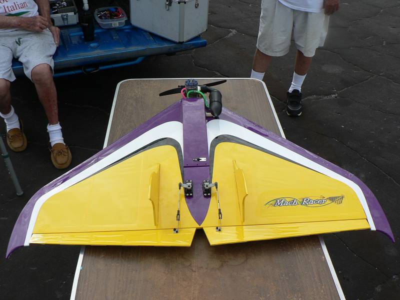

My original question--It appears that the engine thrust line is excessive. Has anyone changed this closer to zero, zero?
I have answered my own question. I removed the right thrust and maidened with a Jett .46.
No wheels, moved the elevon servos topside, sealed the gap on the control surfaces, used a 10 oz. fuel tank and it weighed in at just under 3.5 lbs. I also changed the control surfaces to solid 1/4inch stock. Only beveled the LE.
Good flying plane.

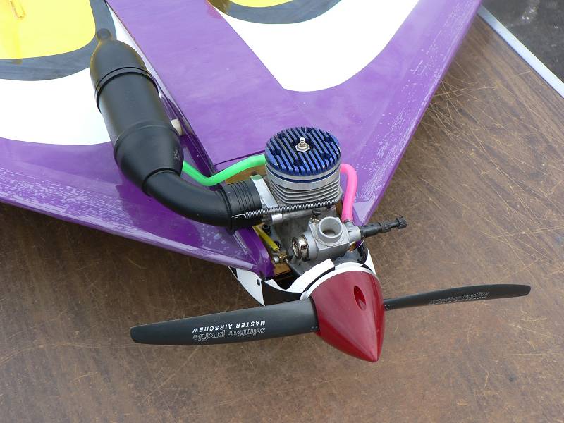

I didn't mess with the thrust angle... seems to fly just fine like it is.
I don't know why, but I never seem to pay attention to the recommended throws. I just follow the TLAR method - "Eh, That Looks About Right". But, I wish I had with this one... my gosh, the first roll was absolutely BLINDING fast and actually startled me. I just took it easy and got 'er down, then promptly tuned the throws down to 70%... now that's better.
I am having fits with the motor on this plane... I'm running a Magnum 46XLS with a 9x9 prop and the Tower muffler. No matter what I do, the darn thing leans out about midway through the flight.... loss of power, then usually a blown plug.
I can think of several reasons:
1) Air leak (Mags are known for this)
2) Tank position... the tank stopper seems to be about 1 or 1.5" below the carb spray bar on this plane... certainly can't raise it easily.
3) Seems to be worse with the Tower muffler. I notice that the pressure fitting hole seems smaller than the stock one? Enough pressure going to the tank?
The airleak option just got handled with a fair amount of RTV around the carb base, needle valve seat, backplate, and everything else I could think of. I'll test that this weekend. But, the tank position... has this been an issue for anybody else?

Well, the Magnum 46 ended up blown anyway. Running it on the ground, after a few mins the engine leaned out badly didn't respond to the HS needle at all (started backing that thing out like crazy till it darn near fell out), and ended up overheating so badly it smoked the oil residue off the head. [X(]
I pulled it off the plane yesterday and found no compression without the plug, a very badly abused liner with no TDC taper left at all, and a missing backplate gasket (odd that the parts breakdown shows one, but it certainly didn't come on my engine). I suspect a major air leak was the culprit, as it seemed to only happen after it warmed up... perhaps that unsealed backplate?
Just broke in a new TT 46 Pro... seems to be a great little engine, we'll see how that does on Sunday (weather permitting).

Well, I can honestly say I did NOT miss that Mag 46 on Sunday. I've now officially swore off of their 2-strokes for good (their 4-strokes are pretty decent IMHO).
The TT Pro 46 with the Tower muffler ran flawlessly and really hauled the Mach around very well.... spins a 9x8 APC on Powermaster 20/20 fuel at 15,700 rpm. On my last few runs, broke out the Cool Power 30% heli fuel... oh wow. Didn't tach it as I lost my flying buddy (what do you hold onto to keep this plane still during a high power?), but had to be in the 16k range for sure... it was screaming.
Just based on prior radar clocking of some of my YS-110 fitted warbirds, I estimate somewhere in the 130mph range straight and level with plenty of vertical.
What a nice engine... now I know why everybody seems to like them so much. Certainly not a Jett 50, but at $85 from the LHS, a real bargain in my book.
