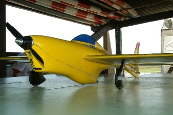

Just as a baseline, a very basic Q-500 design (box fuselage, rectangular 12.5% wing, 500sqin, 3.5 lbs .... nothing difficult) with a stock, well broken in Thunder Tiger .40 pro (or alternatly your OS46AX) and a simple 9x6 prop (10x7 for the .46AX) will easily hit 120 mph. And it has fixed landing gear.
Again, as a point of reference....
Right now, the fastest "40" size planes are the FAI racing aircraft, specialized engines, computer designed composite airframes - those hitting 200-230 mph.
Beyond that, there are endless design considerations and powerplant options.
From your original question.... it sounds like you wish to build a simple airframe with given size constraints. You will find a number of suitable designs in this forum (look up Angel's Rifle, and some of the delta threads) Also, look at some of the pattern aircraft designs (pattern, classic pattern forum). There are a few of the older .40 size designs you will find in there, and most of the .60 size designs scale down well.
One parting though..... the MAIN thing you can do with aircraft design to get speed out of it, is addressing the engine installation. You will want a cowled in engine, and cowled in exhaust system. The engine/muffler/pipe... what have you.... sitting out in the breeze is a HUGE amount of drag. Not always easy to do, not alway pretty.... but done right can result in the best speed gain. Look at the Phenom thread for a decent example, and the FAI and older F1 designs for more refined examples.
Bob
Sorry to sound critical, but I would think that the Phenom wouldn't be such a good example as it looks like it still leaves a great deal of the engine exposed in the breeze, especially when compared to the speed cup contenders.. although I still think it's the best looking delta bar none

Critical is ok. You have a point, it is far from optimized, but provided as an example of where to start. Keep the frontal area to a minimum, keep the airflow as clean and useful as possible.
Compaired to a Whiplash or diamond dust, or a QM40 for that matter.... the Phenom design at least paid attention to cleaning up airflow over the engine.
Even most of the guys flying speed cup could do a bunch more to optimize.

Hi guys,
This is a photo of Chirs Callow's World champs '05 F3d Evo. You can see the engine & pipe cover & how small the air inlet is around the engine. It has a baffle shape to it to direct the air down past the engine through the cowl, out past the pipe.
F3d has a cross sectional fuse rule & this is the reason for the bulge like fuse, so you could remove the cockpit area to clean up the airflow.
The 2nd pic ic Chris Graham's new Evo for this years worlds, & this gives a look at the current thinking in F3d as far as aircraft plan form.
A good way of going quick compared to the rest of the crowd would be get hold of a second hand QM40/ F400, & putting a strong sport engine in there. Gives you throttle for getting used to it, & will still move along well. The Jett website has a few of them with SJ50's in the nose. The AX 46 wouldn't be too hard to get in there, it would just have to be balanced deferently with the heavier engine, than the Nelson/Jett that it was designed around.
Seeing as TheRaven is in Victoria, the AMPRA pylon Nats are on in Cootamundra this weekend. If you want a drive, you will see some of the fastest models in the country going around.
Tony...
p.s. I just like posting pix of my mates really fast planes
