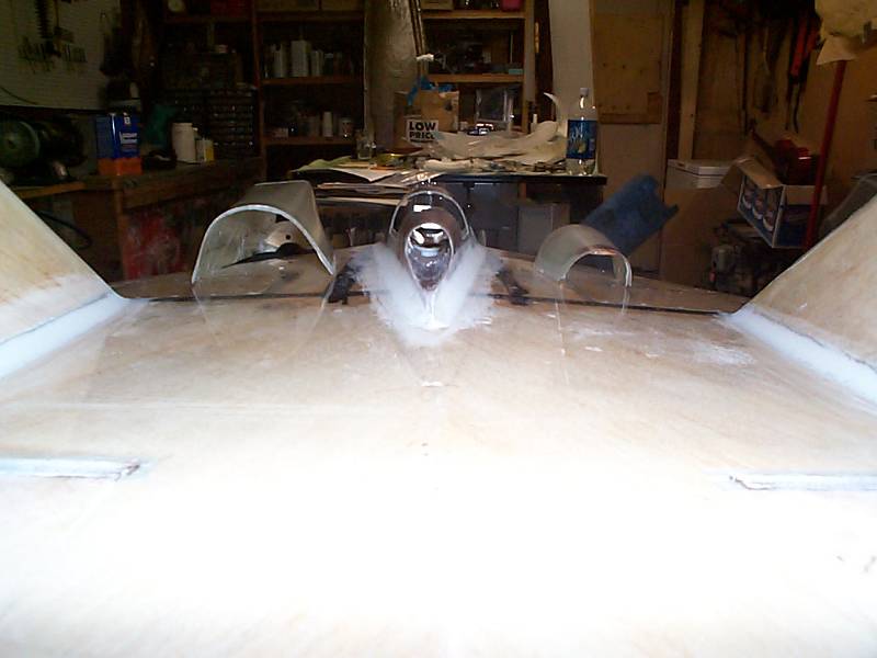

Default We call Her "Slip-Stream"
More
ID:	815198   Click image for larger version
ID:	815199   Click image for larger version

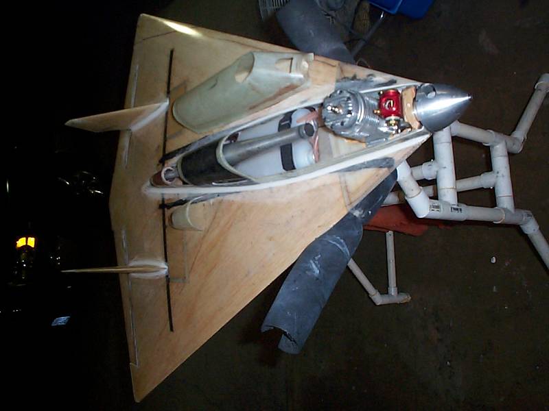

Default RE: We call Her "Slip-Stream"
Yup.
ID:	815203   Click image for larger version
ID:	815204   Click image for larger version

Very nice... should be a screamer..
What you using for fuel tanks there?
And whats the black strap you have holding the pipe down

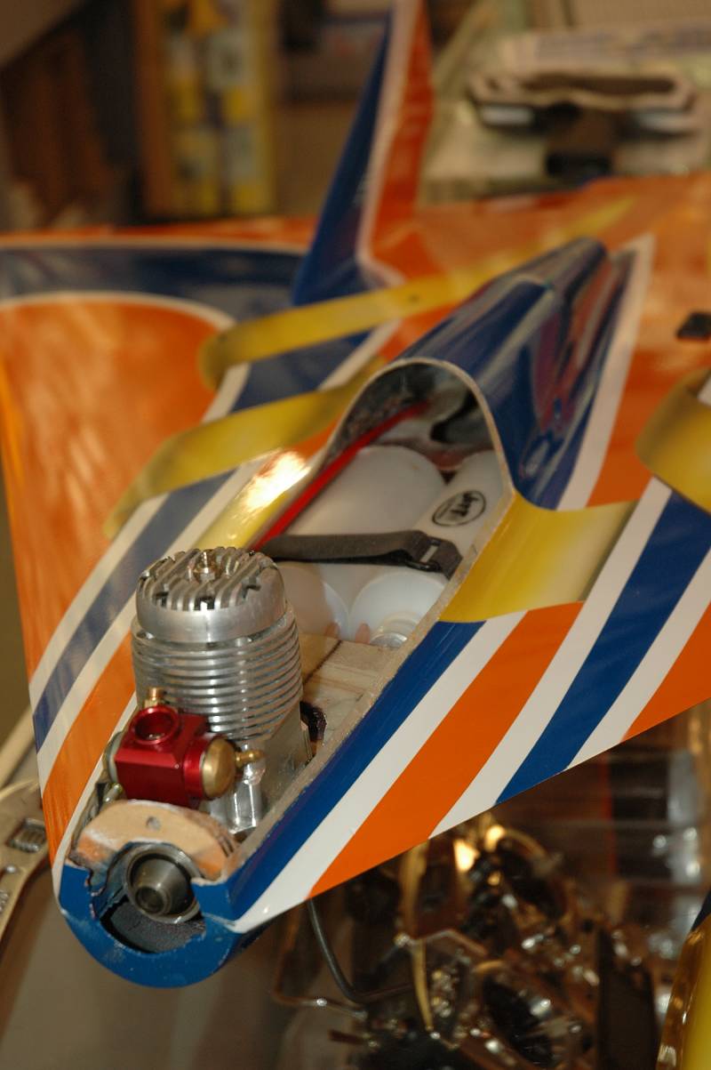

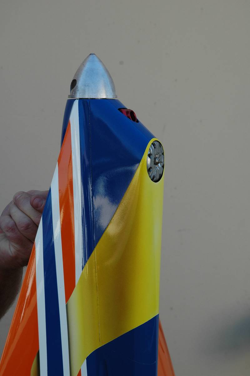

And God said "LET THERE BE COLOR"
ID:	815942   Click image for larger version

THATS INSAIN!
Who did the paint???
Must look GREAT in the air [X(]

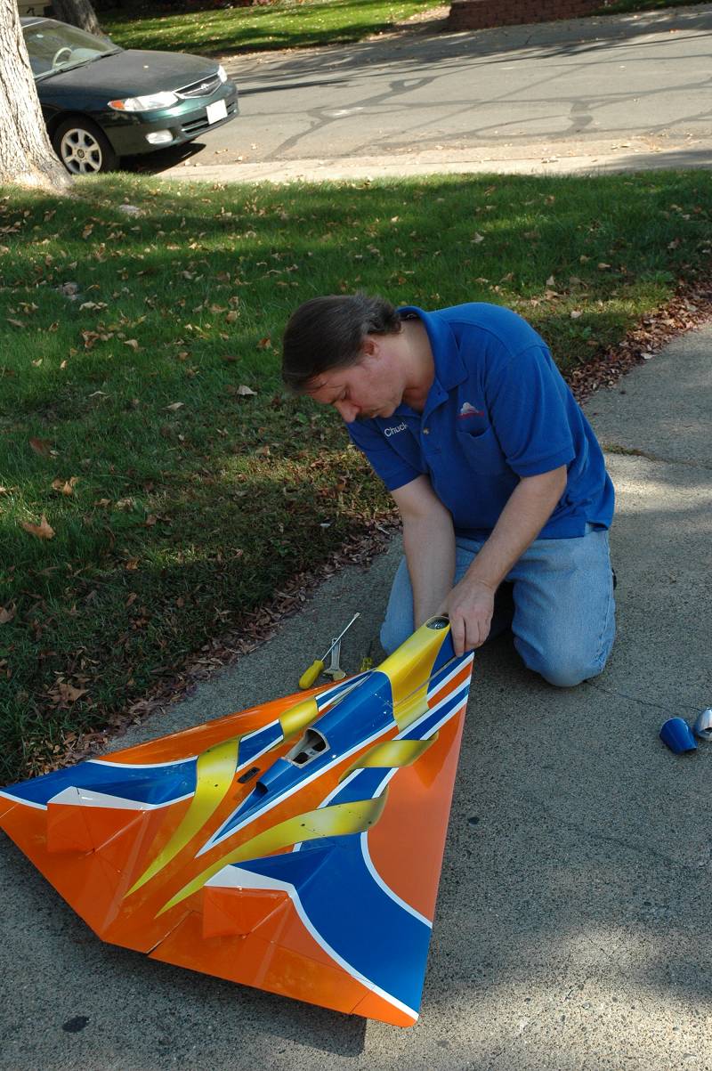

Why Yes, Yes It Does Look Great In The Air! My partner (the master moulder) in this team effort is the artist as well, he chooses to remain private at least for now. He insisted on 2 weeks of sanding, filling, sanding, primering, sanding, filling, sanding, primering, sanding...etc...etc...etc... before paint day. Paint day itself was a 28 hour push working straight through, my main job was to hold a 3ft 2 bulb flourescent light fixture opposite him and the paint guns and keep moving to get sprayed as much as possible (If I ever put myself through that again I WILL be wearing the absolute best mask that money can buy). And then I had to go to work at my job........... MAAAAN that was a long day[sm=what_smile.gif]
Here is a little tidbit for you, his system is Deltron PPG and I did'nt even have to buy quite all of the concoctions involved because he had some stuff still stocked from years ago that he still trusted enough to use on our pride and joy, BUT at the paint shop I still spent $444.44 to paint a 40" x 40" airplane.
ID:	816457   Click image for larger version

The tanks are 2 Bubble Jett 8oz bladder tanks plumbed in parallel. They have among other things as part of their mounting system a particularly strong black velcro strap robbed from a 90 sized heli. As far as the big patch of black you see in the area around the apex of the marine tuned pipe in the pictures of the airplane before paint, that does not touch the pipe (although it does get TOASTY warm in my hand when I launch the airplane) It is just carbon cloth in the lay-up of the molded streamliner tunnel to re-enforce it so I can squeeze it hard enough to hold it back without breaking her. Also notice the patented "Opti-Grab Handle" finger tip recess. (apologies to Steve Martin and
"PlaneBender" Dave Sullivan)
