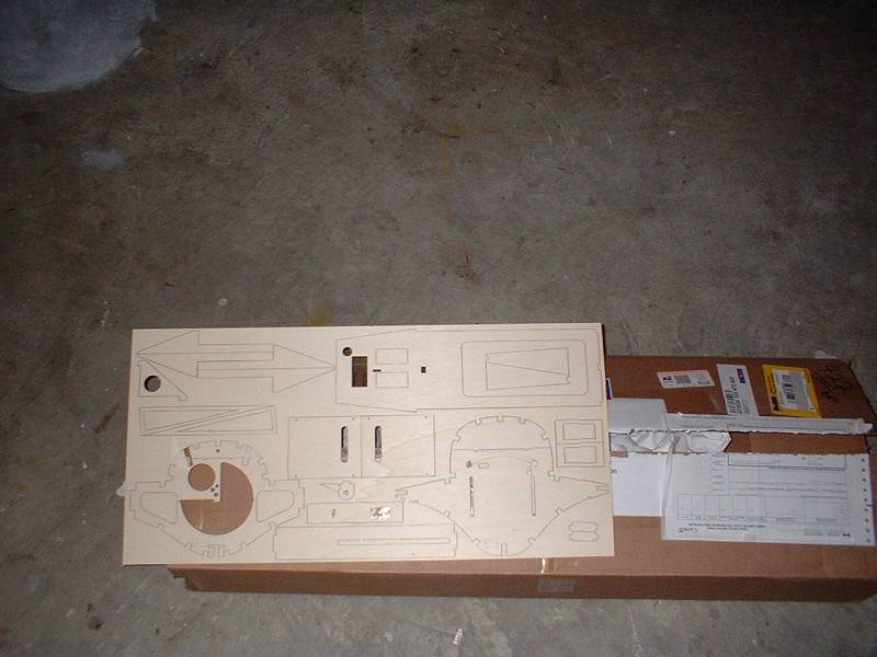

I have been asked ( build and test fly ) and now received from Alex his up and coming F-16 Laser cut kit ( and what a great job well done on the wood quality and Laser cut as you will see ).
I have been asked to stick with the plan, take building notes, notes on problem areas and to ASK for approval on any MODS that may be done.
I am still awaiting approval from Alex on adding to this build thread as I build BUT he may want me to hold off till after the test flight will let you know.
If there are another four builders ( I may be on my own with this ) on this project they may added to this build as well.
I will post one picture just to wet your building skills of the Laser cut formers for now .
I have been PMing to Bob27 on engines trying to decided on going big block or small and want to throw out to you guys a idea of using a OS 55AX with the Jett muffler turning a APC 11x6 around 14500 to 15000 = 9.88 Static Thrust lb. ( I really do not want to hang $375.00 engine on a test plane ..just is case "Gulp" well you know )
I have built both the MIG29 and SU27 from AK and both came in at about 8.5 to 9 lbs but used big block and had to add lead to balance them and I think I can with the use of a small block keep it down to 7 lbs ( or less ).
Cheers for now and let me know what you think.

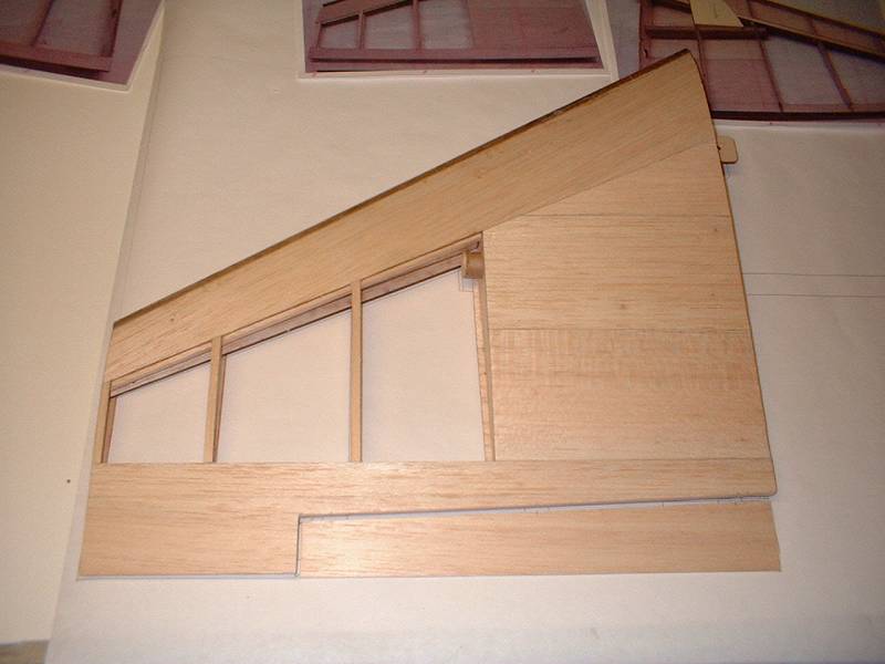

Here is one wing panel that is almost done ..need to shape leading edge, install servo, hinge aileron and make some kind of missile rail. I think the rail will be 1/2" wide as I want to be able put a drill hole in the bottom so I can add bird shot to adjust the lateral balance.
Over the stock plan I added 1" x 1/4" tri stock to the top of the slide in wing hold tang on the inside of W1 and W2.
The Aileron was cut from 2"x36" aileron stock and the left over cut out was added to the TE. The stock plan left the design of the aileron up to me ..if this style is used I am sure Alex will be able to laser cut from stock strip.
If you would like to see the build sequence for the wing up till now let me know..it is pretty much straight forward.
In making the wing paper sleeve for the main spar I found a neat way to make sure the rap is not to tight to slide in. I will have to take a picture or two if you are interested.
Need to finish both wing panels before moving on ..... wing span with out rails 48" with 49"

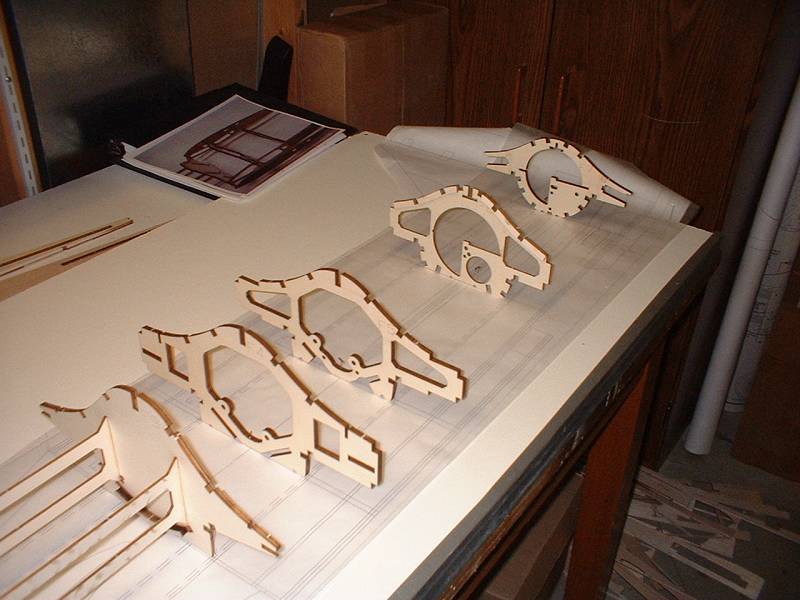

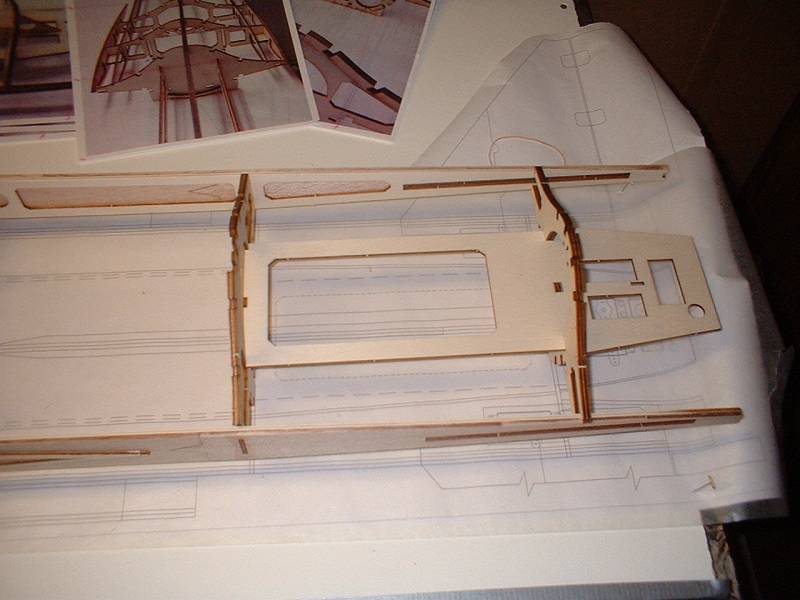

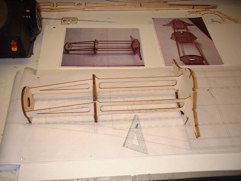

[X(] The quality of the laser cut and the placement of the notch's on the formers is ( top notch ) pun ...as you can see I started out with F1 to F3 pinned into place and checked with tri angle ...they are spot on except F1 which seems to have 2 deg down built in and no side thrust angle ( have to check later ).
Pinned F4 to F7 into place oops don't do this ..you need to place the fuse side and doubler onto F4 and F5 then pin to the board ... continue with F6 and F7 and check for fit and angle to the work top ...again spot on.
Working from F3 to F6 glued all joints and notches ...make sure you STOP gluing at F6 ..you have to slide into place on F6 the ply servo tray holder and ply bottom rudder support then add F7 ,,,,,, almost made this mistake . both F6 and F7 have locking tab that you have to slide over and I do not think you would ever do it if F7 was glued. well with out hacking and cutting
With just the Fuse side / doubler glued and locked into place it has kept the formers evenly spaced and at the correct 90 to the work bench with out a lot of fuss ..this has been so far one of the easiest fuse lay ups I have ever done. Good work Alex.
Well more work to do ...hmmmm. make that a lot of work to do yet
Hope to see most of the hardware I have ordered come in this week. I will be using some NEW products that I have not used on a build and will point them out as I go
