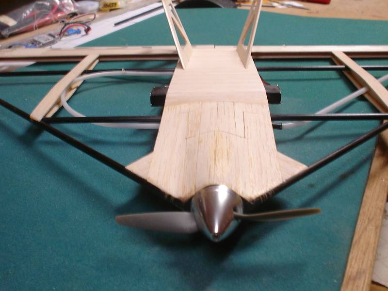

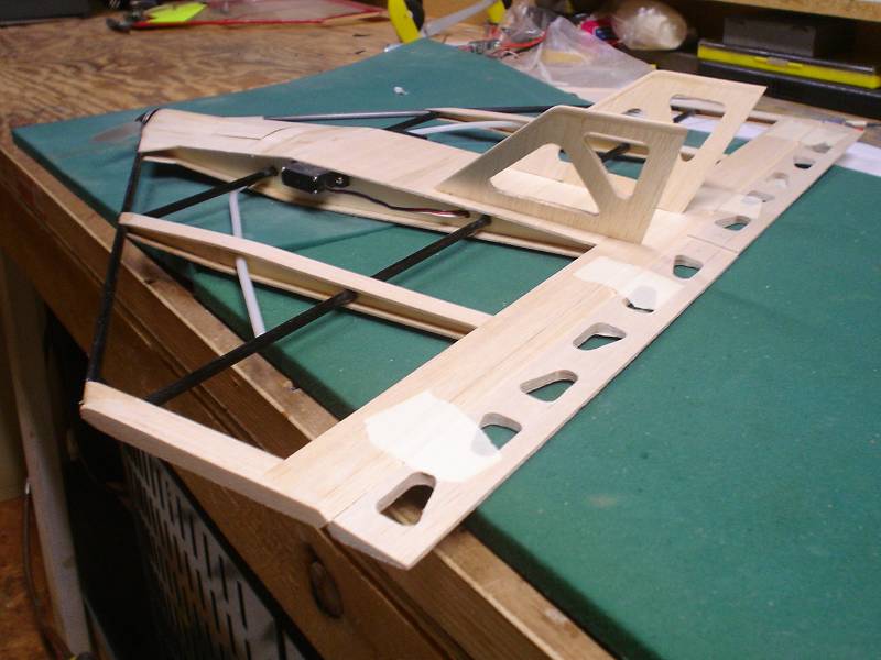

With the lack of a new plane and the economy I decided to build a new plane from scratch. Based on a Diamond Dust, it's scaled down (to a 24" span) and has a Mega 16/15 in it. I have a 16/15/4 in it building it but have a spare 16/15/2 and 16/15/3 too. All up 1lb even, should be fun...

Evan - would you tell us a bit about the scaling down? Did you draw new plans?

I had smaller plans for the .061 that I did at Kinkos. Just hit what % you want and it copies them. I took those and enlarged them on my home copier, taping together about 6 sheets. Since the ribs are on the plans I used them to cut them out. The DD is an easy build having four ribs... I used carbon arrow shafts for the frame work.
