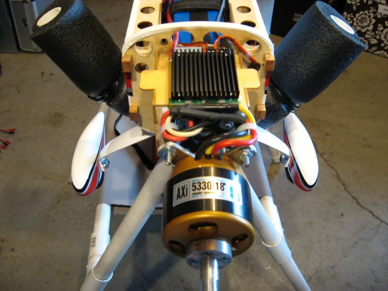

ORIGINAL: rmenke
Webra 55with 10X10 16,900, fat.
Good to know, that a Webra 55 is stonger than a Jett 90 LX, since the Jett will turn an APC 10X10 at only 16,300.[:-]
10% fuel max and a 9X8 for break-in(on ground) and a 9X10 APC on a clean plane or around 10X7 or 10X6 APC on a SD or Revolver is what I'd use on a Webra 55GT
