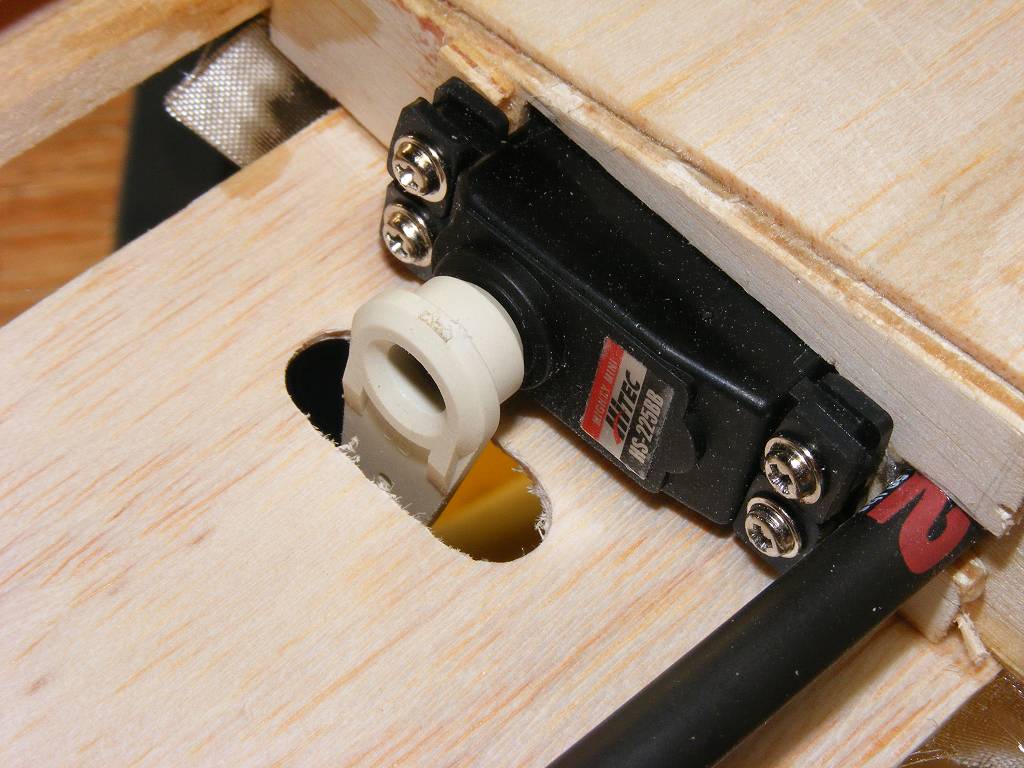

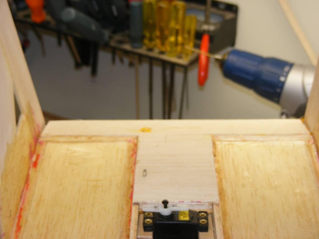

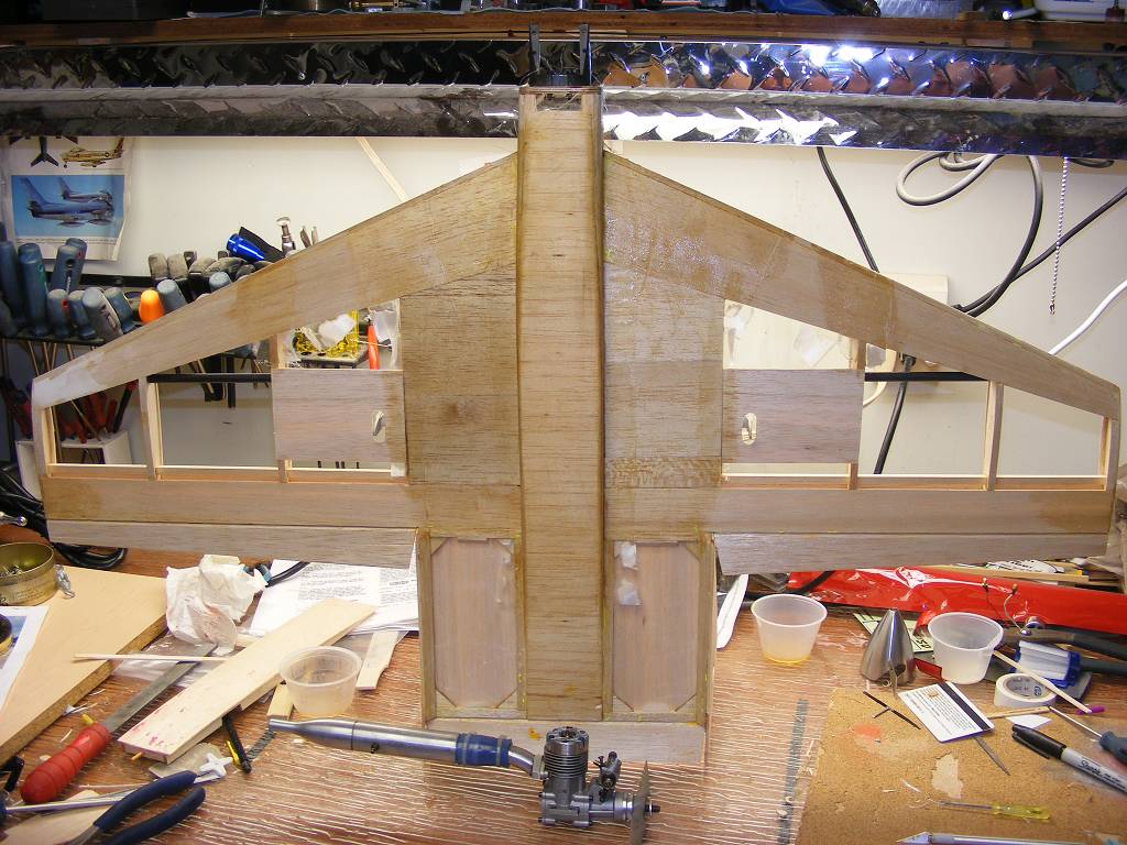

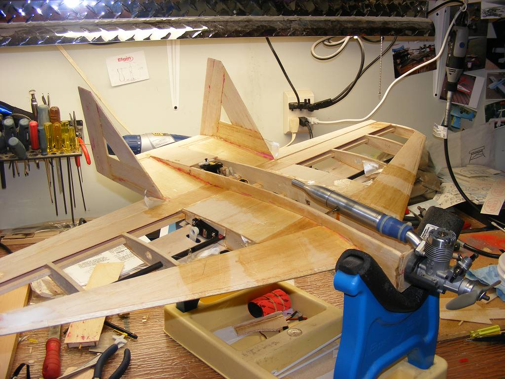

Started back on my Shrike .10-os .25 vrdf project, mainly because the f-20 is basically done, time to move on to something else, shoved an extra spar in (CF arrow shaft) and glassed some areas, Hs225 in the wings and elevator, rebuilt new firewall .500" back from original position, and re-hinged with an extra hinge added in each control surface, thought about making a cowl for the engine/pipe set-up, but I just want to finish it and fly it, should be FUN!

No, this plane was given to me from a fellow modeler thats had so much trouble with his eyes he is not able to fly anymore, but it was built for a .15, and the covering was coming off anyways so I stripped it and modified it a little.

i have the same exhaust system for most of my small motors, i drill thru the edge of the header for a 6-32 pressure tap, been successful since i first tried while working at mac's products, anxious to hear about maiden flights., BTW did you remove head shim yet?[8D]

Running with no head shim.

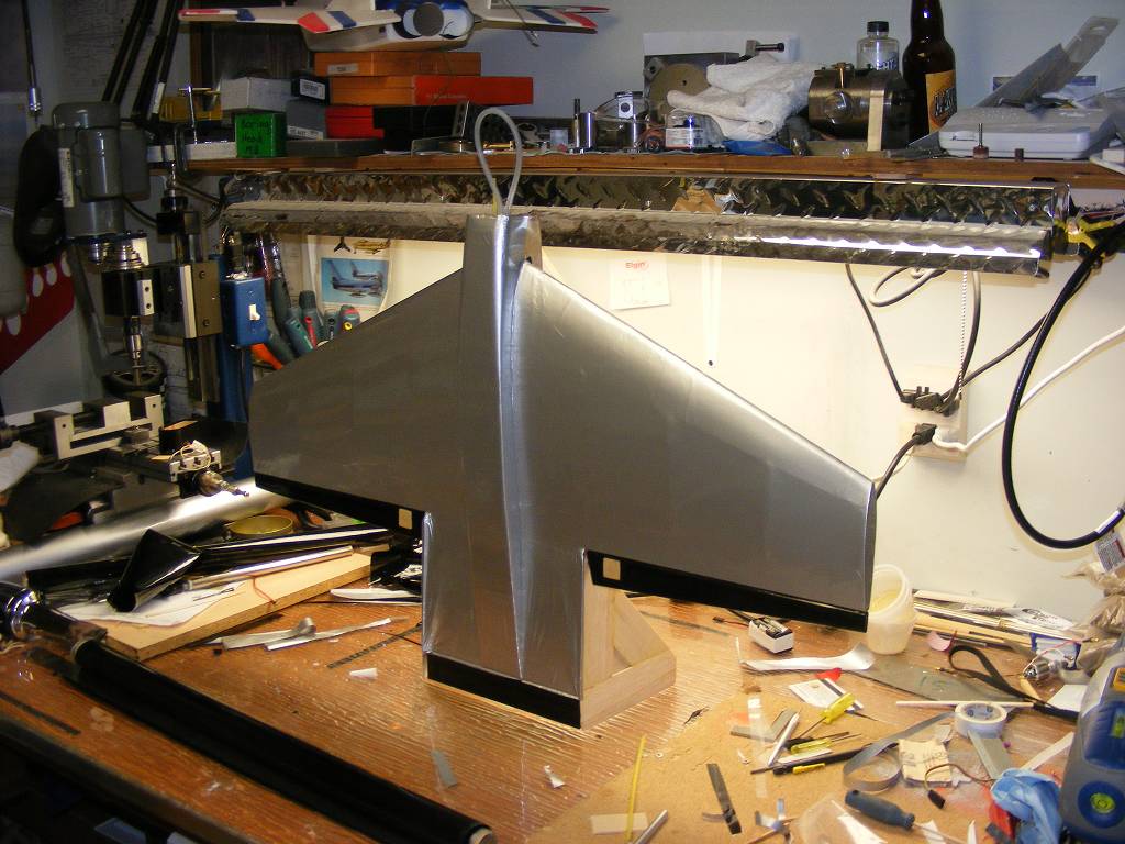

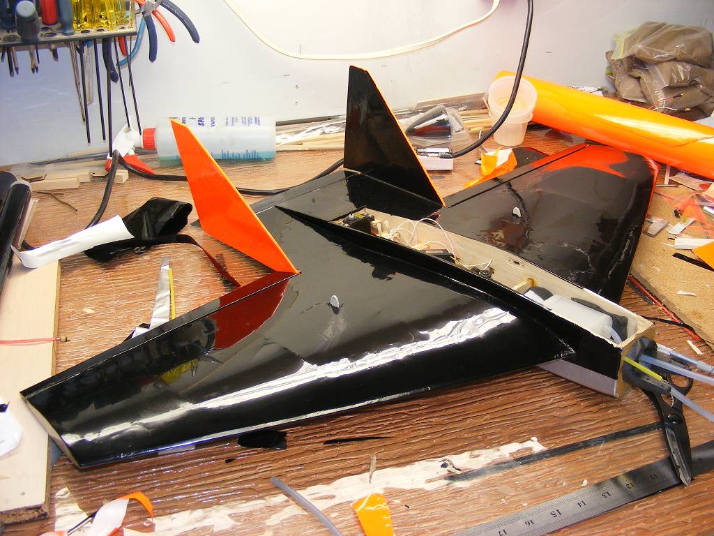

ARGGGGG%#@##*[>:], sometimes you just have to walk away, I'm trying to cover right now, lots of angles a contours, oh well it might not look the prettiest I've done, but it'll be fun.

Had a couple of hiccups in the build, like modifying the top forward fuse for header/pipe clearance, that was a pain, probably won't maiden till next week now.
