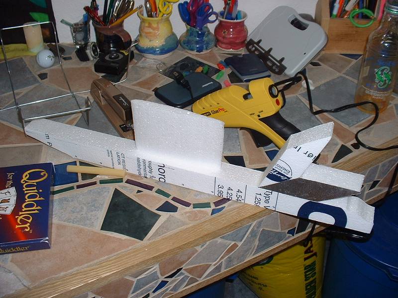

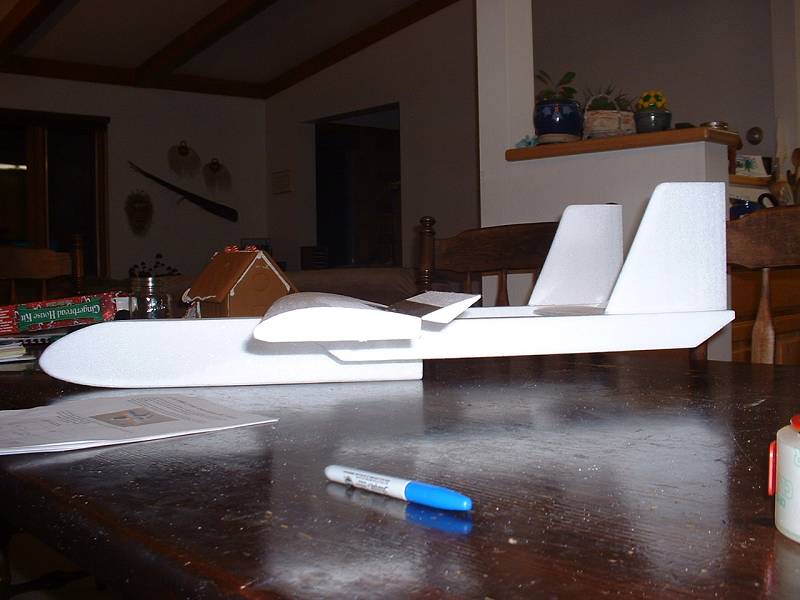

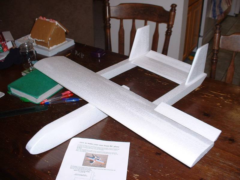

I found another site with all kinds of good info on cutting the foam and even got a free demo version of a software package that lays out the airfoil (CompuFoil). The demo version gets you a Clark-Y airfoil as suggested by Foamflyer. Only difference is that there is some curve to the bottom side of the wing which is not detailed on Faomflyers plans. His wing shows a flat bottom side. If it truly is a flat bottom then it would be even easier to cut but it would be nice to know just how he shapes it. I look forward to his updated pages.
Only other modification would be to add rudder control (that would come later on version 2 or 3) so you can steer on the water. Not sure you would need any other floats on the wings since the tail booms would give you some roll stability on water.
This is a good way to communicate and keep excited about building one of these.

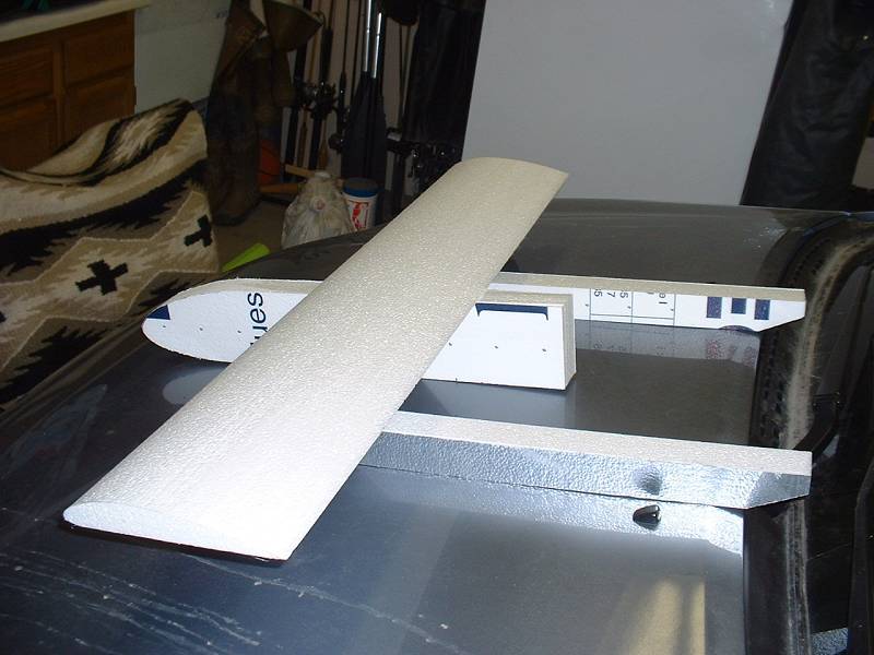

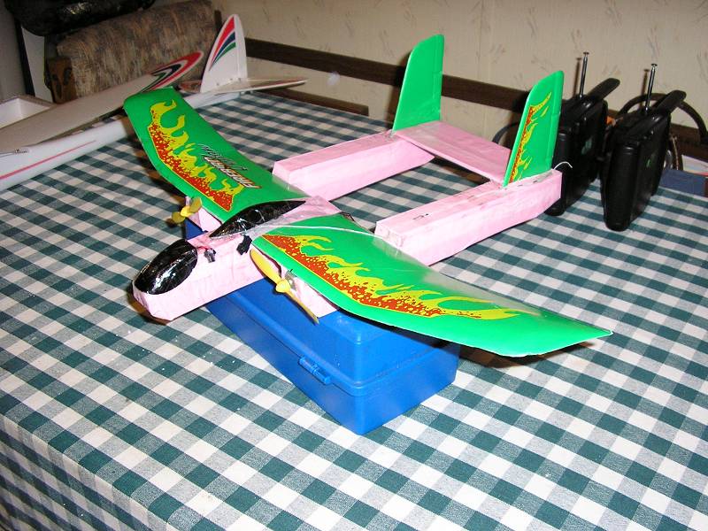

Critter and Fisher,, hey guys not to butt in but I love to try to build from scratch and have built about 5 planes now most not very successfull in flight but when I saw this one I couldn't resist. Good job finding and posting this one Critter. anyway I decided to go a little different way on this one, I decided to make it 2 channel first to see if I could make it fly, then go to scale or larger and go all out 400 motor full ailerons and elevator and make the booms just a little wider so it would make a water plane, I figured I'd put CF tubes on bottm for landing on gound and for strength. Here is a pic of my 2 channel attempt which by the way fly's real good. I have found that due to the twin tail rudder size is very important as it seriously effects the turning of this design. If it is too tall or wide the turns are very labored or slow to react. I think ailerons will solve this problem. in the pic the lower cockpit is the battery and the one on top is the electronics, I know it's a little crude but I get in a hurry sometimes but I will say this one is worth taking your time with. I wouldn't do the water rudder unless you don't think the ailerons will make it turn on water. mine is made using wing and tail from an old FB outlaw
I have since lowered the top of the booms to make them even with the wing, wing to rudder and it did improve flight stability
I can't wait to start the full size version, but I don't think I will try to build the wing I think I'll just buy... maybe a Cub wing or something like that to use. Not that good at this building yet but I love trying
I will watch the post here because I would like to see how you guys do with this little bird, maybe pickup some new ideas

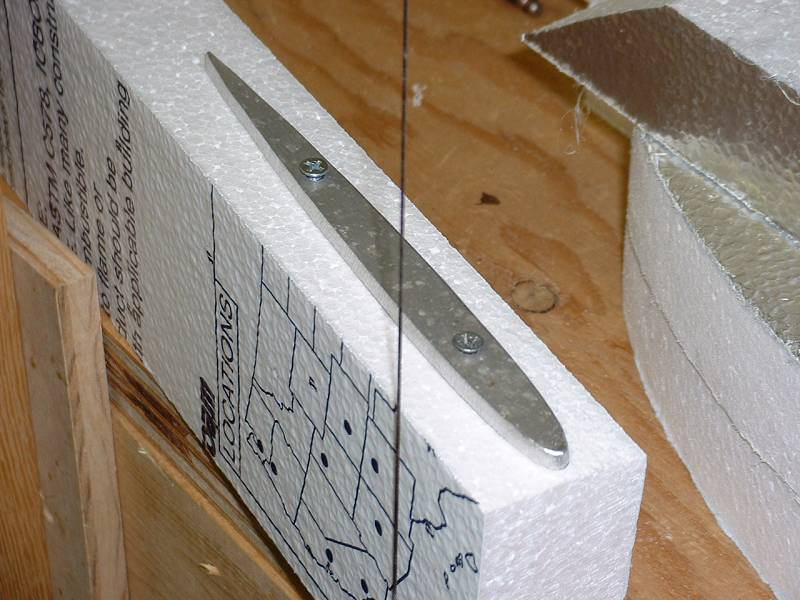

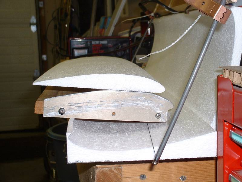

I neglected the family for half a day and got quite a bit done on the wing. I built a hot wire foam cutter with an oak 1" x 2.5", two music wire arms and some fishing leader. Powered it with a battery charger set on manual 12V 2A. Cut two templates out of 1/8" aluminum and bolted them to a base. Used some very light EPS foam and got 3 wings cut in 10 minutes. I e-mailed Foamflyer to ask for more detail on the booms vertical stabs etc... He said he might get more detail posted on his page sometime in the next few days owing to the holidays.
I chose this hotwire cutter design since it was so simple and easy to build. Everything has to be simple and easy for me to build or it will not get done. This foam I used was just what Foamflyer recommended and it is really light and not all that strong. I am assuming this design is for much more sedate flying then we have been doing with the Stryker. Nice and easy. Keep it light or it may rip apart. Adding the strapping tape spar will definitely help but I doubt this plane will take too much abuse (Speed). A little more tape should help. Maybe a couple of carbon fiber rods from an old Stryker Fuse too.
You seem much further down the power plant curve than I am. I will be looking into all electronics etc. once I get the main plane built. Probably won't get much more done until Foamflyer posts more detail.

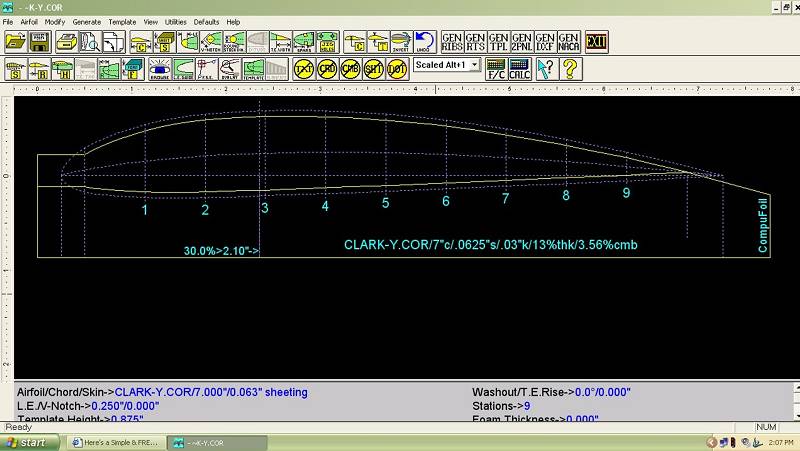

As for creating a template for the shape of the wing, down load Compufoil. The demo version lets you set the wing shape perameters and gives you a printable template to use for making the profile forms. You simply cut the templates out with scissors and attach to plywood, formica, aluminum etc... and cut it out. You can either pin the templates the either end of the foam block you want to cut or mount them on the ends of a base plate like I did. I am not being much more specific than last time since all this is well illustrated in the attached links. Foamflyer gives the exact specifications for the airfoil on the first view of the plane. You just have to figure out how they are entered into compufoil.
The light EPS foam (seems almost too light) is what Foamflyer was using. I took one of my new wings out and taped a makeshift fuselage to it and it flew OK just like that with no tail. Did a great loop and then fell to earth without damage. Crashed it severl times with no damage since it is so light.

Default RE: Here's a Simple & FREE First Foam Build Plan! Cool Looking Plane Too...
Critterhunter,
I have made some progress this evening. I have 4 good wings, 2 fuselages and 2 sets of tail booms complete. Now I need another piece of foam to cut the vertical and horizontal stabilizers. I also tried out my Stanley hot glue gun with dual temp glue stick on this foam. Unbelievable strength. I just stuck some scrap foam pieces together and they are stuck tight. See photos of airfoil templates and cut pieces.

Critterhunter,
Well I put in a few hours today and now I have a complete airframe! Just ordered two BP21 brushless motors and a 15 amp speed control. They were out of 30 amp controls. Now I just have to get the electronic install done correctly and I will be ready to fly. This will probably take another 6 months until I figure it all out.

I apologize for only now just getting back on the computer. I've spent the last five days from sunrise to well after sunset working on my truck. Not a toy, but the real thing that I work out of. I normaly enjoy working on my own vehicles but this was a week of pure problems. I couldn't believe the kind of luck I was having. Being self employeed I had been working out of a car for the last month, not wanting to tackle the truck problems right away...until the timing belt went on the car. In other words, I'm just happy to be alive right now. What really burned me was I couldn't go out for deer shotgun season here in Ohio this week and today is the last day. Already took a buck with a crossbow but wanted to use a slug on a doe. Still go two more months of bow season to pack the freezer, though.
Back to the subject....WOW...Great job there! I'm envious that you are plowing ground well ahead of me on this project and thus I'll have to be creative to find something new on this plane to pioneer. Couple of quick questions for you...is that foam the cheap chunky stuff at the local home improvement store? I saw what I think is the foam you are working with and thought..."This can't be it, it's too flimsy and chunky looking". It'd help if you gave the exact name of this stuff and any other label specifications so I can be sure what I'm working with. I would have thought the pink Owens Corning foam at the store would be much better as it's smoother, stronger, and doesn't way all that much.
On the BP21s....Good for you on getting those. You'll love the power and speed they produce. Match'em up with a 7x6 prop...or atleast that's the best prop for it on a Stryker. Did you pick up some lipos yet? If not, try Dymond Motorsports website as they are about half the price of anybody out there. The 3 cell 10C 2000ma packs work great with the BP21 and hardly get warm after a long flight. At $35 a pack you can't go wrong. I also bought a Celectra 1 to 3 cell lipo charger and am very happy with it. From what I have read there isn't much difference between lipo chargers out there. In other words, one doesn't really get you any better of a charger on a lipo over another. Let me know how you like those BP21s! Two? You aren't planning on a dual motor version to beat me to that punch too, are you? [>:]
As money provides I'll not be starting on this project for at least another week or two. Fixing my truck took a good bit of cash out of my pocket, not to mention I haven't been working this week to bring in some more money. Oh well, Monday is a new week.
