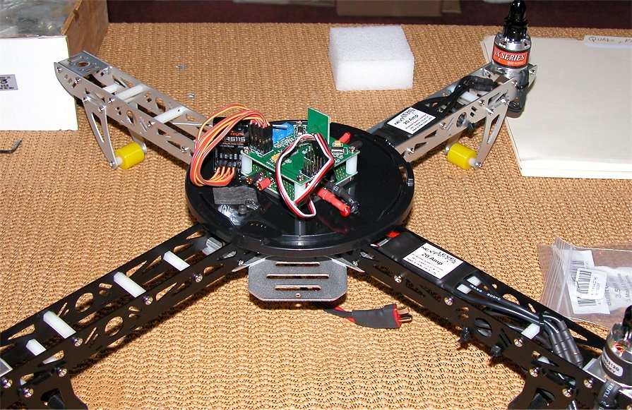

Here are the parts that I am using to complete my ST450.
ST450 Components:[ul][*] ST450 Frame and Parts at [link=http://search2.hobby-lobby.com/psearch/svc/search.php?uid=2&q=st450&x=0&y=0]Hobby Lobby[/link][*] Hobby King Quadcopter [link=http://www.hobbyking.com/hobbyking/store/__23140__Hobby_King_Quadcopter_Power_Distribution_ Board.html]Power Distribution[/link] Board[*] HobbyKing Multi-Rotor Control Board [link=http://www.hobbyking.com/hobbyking/store/__19534__HobbyKing_Multi_Rotor_Control_Board_V2_1_ Atmega168PA_.html]V2.1[/link][*] iFlight iPower [link=http://www.rcdude.com/servlet/the-Brushless-Motors-cln-iPower-MultiRotor-Motors/Categories]2212Q[/link] Brushless Outrunner Motor[*] Next Level Multi-Rotor ESC - [link=http://www.rcdude.com/servlet/the-Brushless-Controllers-cln-Next-Level-Multi-dsh-Rotor/Categories]20 amp[/link][*] Turnigy 3600mAh 3S 30C Lipo Pack ([link=http://www.hobbyking.com/hobbyking/store/uh_viewItem.asp?idProduct=14966]USA Warehouse[/link])
[/ul]
My KK2.1 controller board has been reflashed to 4.7. I protected it with a short DVD case.

My flying erector set is ready to test. I'm using GemFan 10x4.7 props. My 3s 3200mAh pack is simply held in place by two rubber bands. I'm using an older pack until my new Turnigy pack arrives.
I did find out one interesting change when using the newer v4.7 firmware. The pot settings for calibration are reversed so that you turn them full CW instead of CCW to calibrate various settings. The information on this starts on post [link=http://www.rcgroups.com/forums/showthread.php?t=1458663&page=5]73[/link] of the long KK Multikopter thread on RCG.

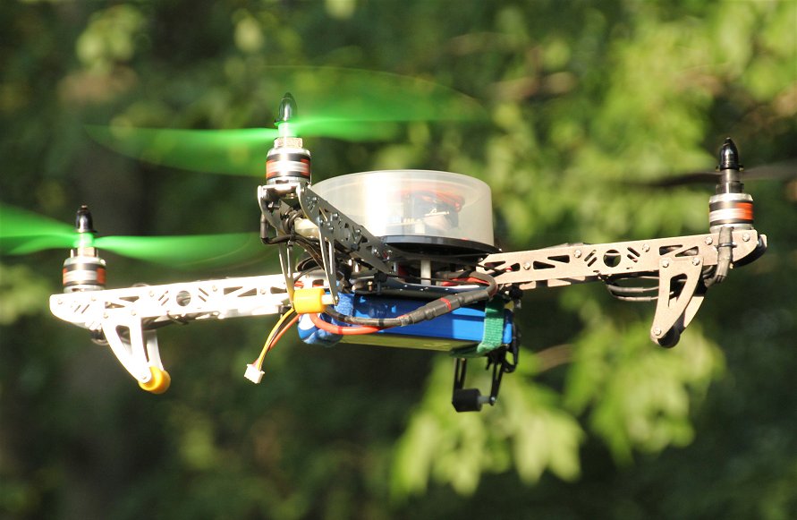

Here are a few flying photos of my ST450 "Erector Set" Quad. Even with the arms bent in slightly different directions, the KK1 board with v4.7 firmware keeps it quite stable. The ST450 just has too much hardware to come loose and the arms can be bent out of alignment. I expect my replacement Flamewheel 450 clone to have much less maintenance.
