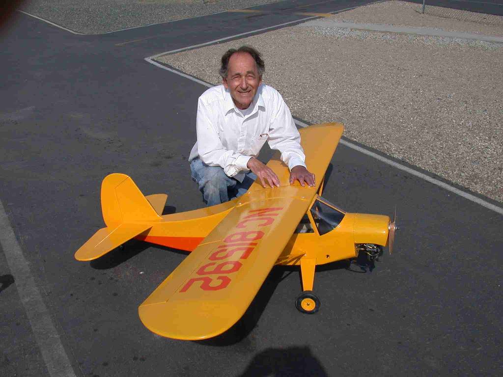

My Champ is over powered with a Brison 2.4 swingining a Zinger 18 X 10. The scale is about 1/4.5. Dan.
