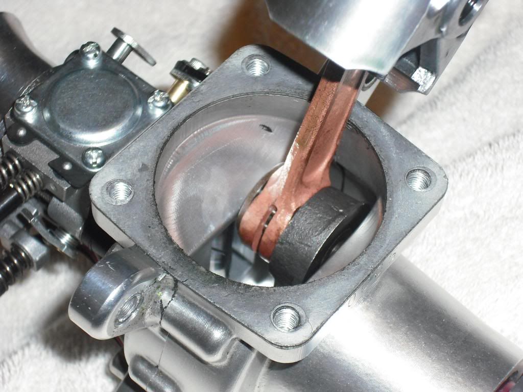

Has any body else had a look at the porting of one of these? I was given one to put new bearings in (third set) and do a polish job on the ports for a friend.

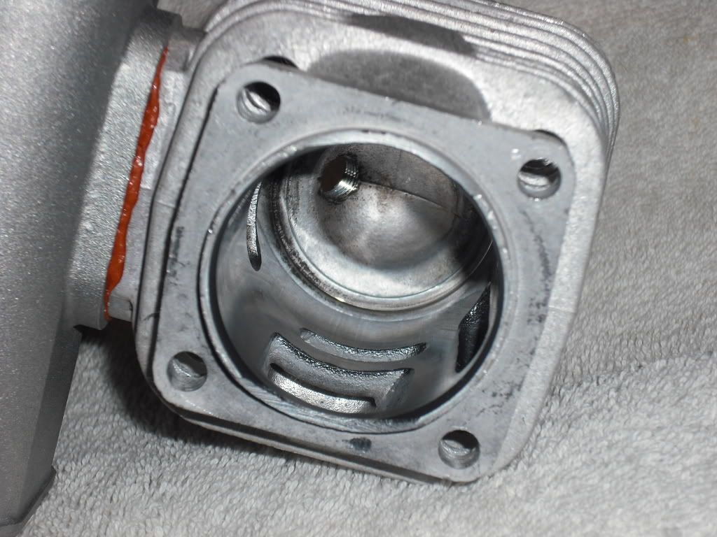

Talk about rough casting!! Most of the weed wacker engines I play with are a lot cleaner/smoother than this thing by far!
Already spent quite a few hours just smoothing the port castings out and still not ready to do a proper polish on them, so many pits, dags, high spots I couldnt believe it.

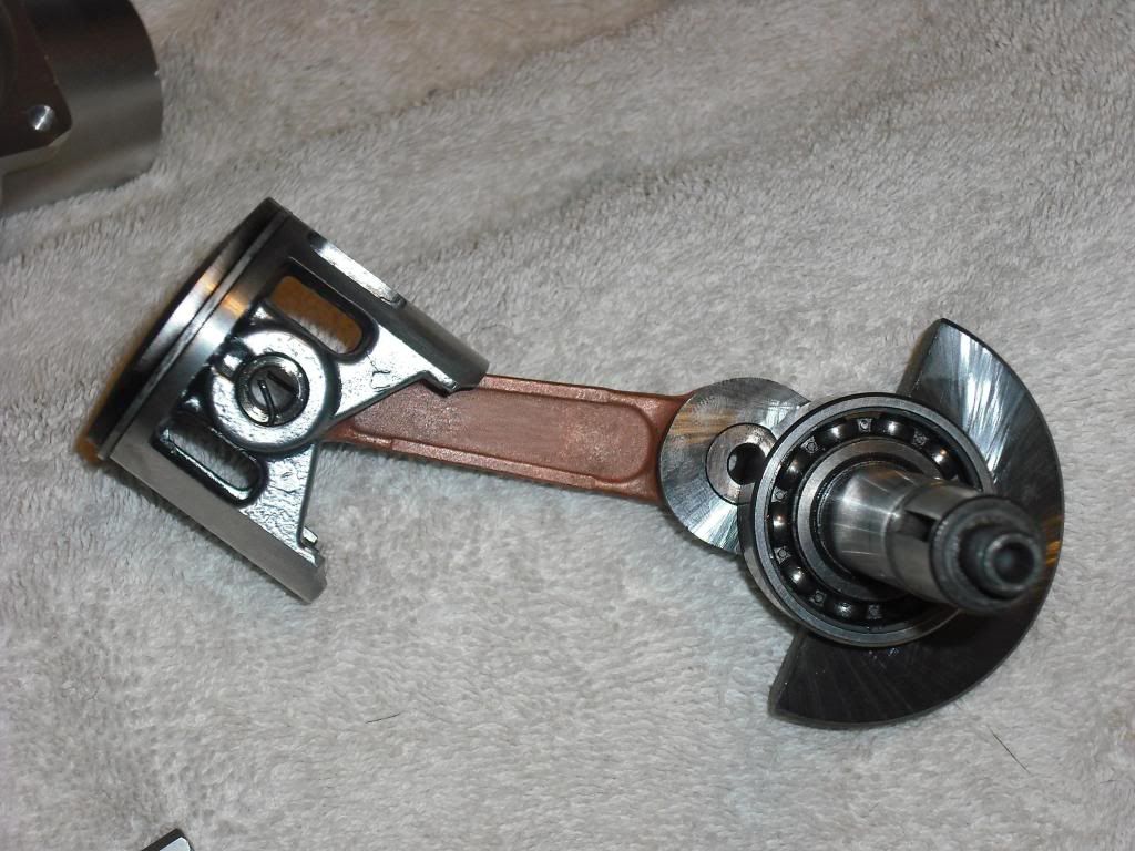

Never mind that the crank bearings are that tight in the casing that they feel rough before the crank goes in, which is why his engine is far too tight once assembled and he is now on his third set.
Not real good for a engine with only minimal run time!

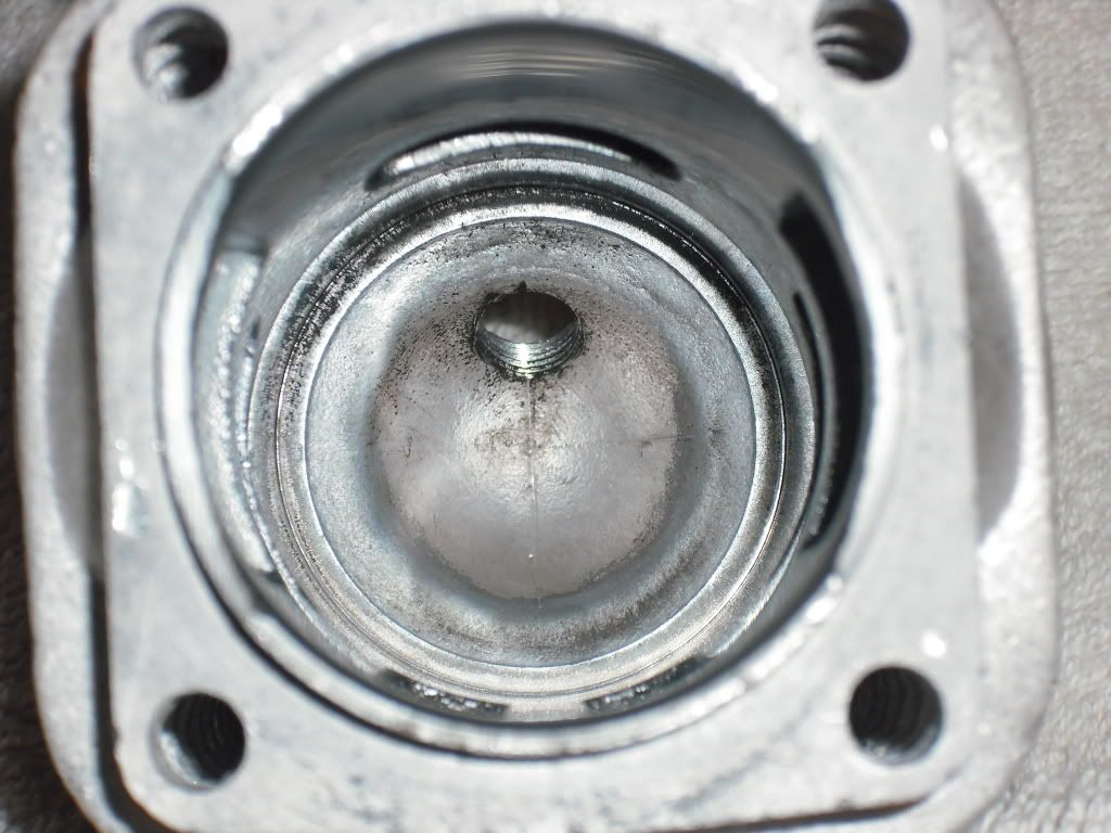

I did not intend to bag their product but was more hoping someone would have posted up that he got a dud engine and that this is not normally the case.
As I said, I usually play with converting weedies for myself and a couple of friends. I am not a flyer (more boats/Airboats)so have not had much experiance with these purpose built engines but I would never pay good money to end up with something like this one.
I have pretty much smoothed out all the ports now and polished the exhaust port already but still have to start on one of the transfer ports so will try to get a good enough pic to post up if you guys would like.
I will be skimming the main case to relieve the bearing areas by a thou. or two, so that will fix the binding problem. Im also thinking of getting a seal with a larger ID so I can spin up a sleeve to go between the two bearings to stop loading them up when the prop adapter is torqued up as they are only standard bearings and not designed for side load as proper 'thrust' bearings are .
I actually have 12 years experience as an Overhaul Tech. working with full scale Aircraft so I have access to all the tooling needed, so its really just time to get it all done and put together right and he should have a good engine will last.
It will probably perform a lot better (rpm etc.) by just fixing the binding bearing problem without all the port work so it will be interesting to see once its all back together how it performs compared to other peoples stock versions.

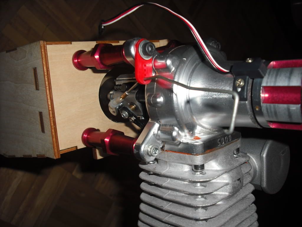

Looks pretty close, its the same muffler, rear carby but slightly different prop adapter. The one here has cutouts around it.

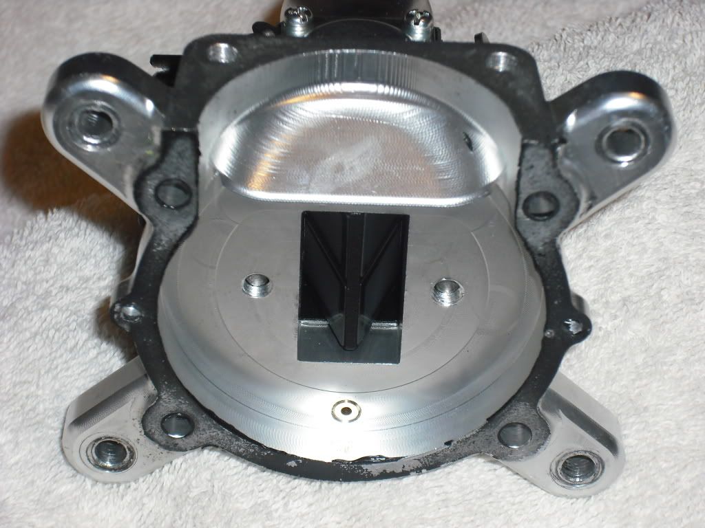

When I first got mine I could swing a Xoar 22x8 6200 rpm after timing it properly. I played with the ports, not much can be done there, they are small and the walls are thin. I played with putting a window in the piston too, I finally got 6400 rpm.
I looked at the carb block and did this modification with a dremal to give the fuel/air mix a better shot at the reeds, it takes about 30 seconds to do. I was able to get 67~6800 rpm out of it before I started blowing the mounting lugs off and need to make the aluminum box mount.

The intake ports need not be smooth. The fuel mixture is wet and will cling more to a smooth surface. Exhaust can be smooth. Matching all ports is a very good idea, that way there is no stepbetween bolt together parts that have ports. My cousin had a flow tester and did many, many port jobs. Also the engines he worked on held National Records for ten years strait. All 2 stroke Snomobile engines. Capt,n

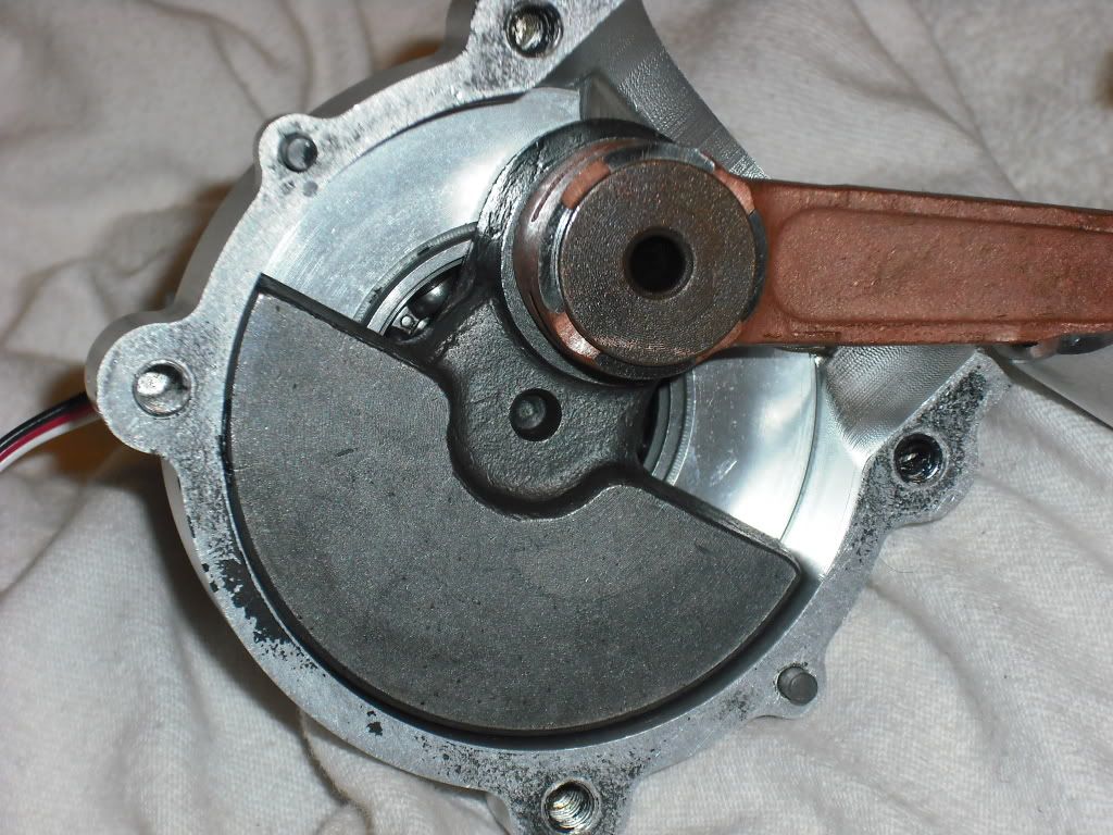

Yea, that's a different engine. The reed block is like the DL50 I've got, and the crankcase looks cnc'ed. With the Chinese you have to be careful thinking you have a billet cnc'ed crankcase, I saw one that was cast, then they ran a cnc machine over it to give it the "look."

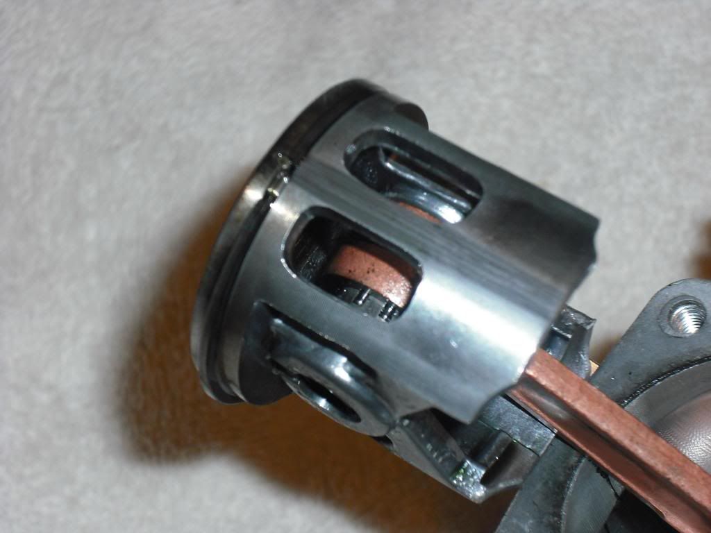

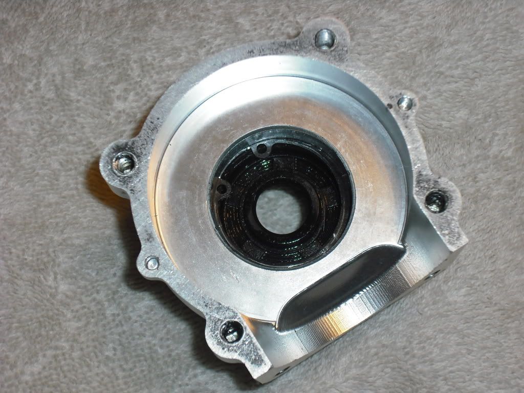

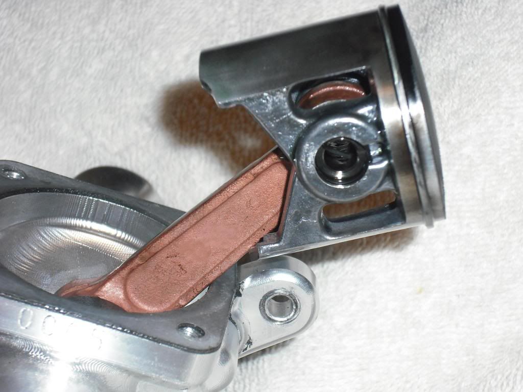

The pictures that " soarrich " posted are not a CRRC Pro GP50R engine.
I had a prototype GP50R for testing. S/N 0005
Went trough two engines with a too soft of aluminum engine case.
The bearings started to get loose in the engine housing.
Crank, connecting rod, bearings, cylinder were all from DL-50's ( Pre DLE-55 ).
CRRC made their own engine case and there own ignition.
I replaced my ignition with a Rcexl after two failed CRRC units.
Went through some issues with prop hubs ( prototypes were blue, productions were red ).
1st prototypes ran super strong, 2nd and 3rd had less rpm's (-300 ) with the same exact props.
Here is pictures and pictures of it ripped down for repairs.
Compare the machining of your engine to a prototype.
