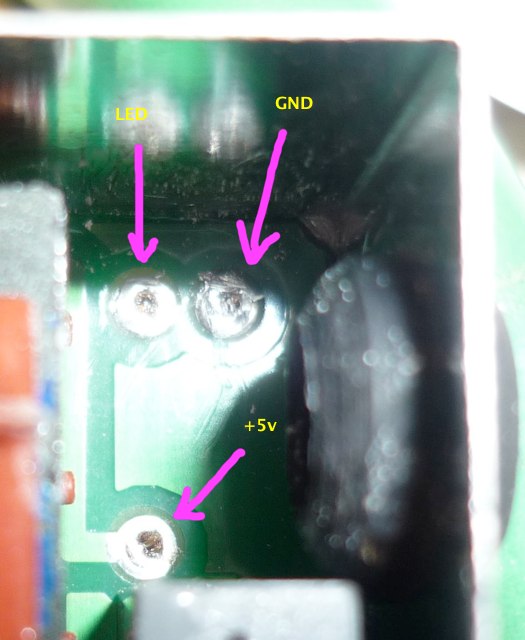

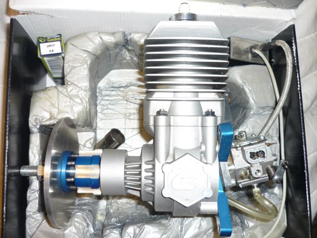

I had bought this Evolution 58 GT gas engine at an estate sale and it looked great then. But later at home when I was checking it out more closely, I discovered that the power and LED cables or wires were missing. Somehow they got pulled out and off the ignition module. Of course a new ignition module would cost about $200, if I replace it with another one like it. Although I could probably go with a CH or RCexl ignition unit, I figured it is worth a shot to see if I can repair it or not. Thus I opened up the module to see what I have inside. Evolution is using a Valach ignition module rated at 4.8v for this engine.
Upon closer inspection, I can see what happened as the latex glue only partially covered the wires and thus didn't help protect the wires from being pulled on. So i cleaned off the glue and identified the pertinent PCB traces on the board inside. I'll have to solder the two ground wires to the metal case as it is too tricky to get inside to clear the solder off of the pad next to that small integrated circuit. But the LED wire pad and the +5V pad are doable though. The LED pad trace has a small resistor in series on it but the +5v pad on the top is more wide and it has a small thin trace on the bottom going to the small IC chip.
Anyway before I go tinkering with it, I wanted to see if anyone else agrees that those are where the wires go on the inside or not. I have provided pics of the top and bottom views of the board inside the ignition unit.
Thanks for looking.

Amazingly enough, I was successful at getting it to work again. In looking at the manual for the engine, they mention a data line, but no LED was shown in the drawings. So I guess putting a LED on is a added bonus, at least it seems to work OK like that. But it is generating sparks again, so all is well at home once again. I did order a CH ignition unit to use on the engine later though. I suppose I would not have been able to fix it if I didn't have a spare ignition unit on the way. A variation on Murphy's Law.
Anyway, it is firing off sparks on command. It is a little odd in that you have to rotate the crankshaft all the way around once before it generates a spark. Just waving the timing sensor across the magnet back and forth doesn't generate sparks like a RXexl unit does. So it is a little picky. But it seems to be working now OK once again.
Also the user manual for the Evolution 58 GX engine shows the CDI unit without a LED cable on it, and the third wire on the power cable is shown as a data line. Oh well, it does turn on the LED when I power up the unit and it is still generating sparks so I guess it isn't a problem. I don't know if it is a drawing illustration error or not. My other Evolution 26GX engine has a LED cable on it so I assumed that the 58 engine also needed a LED cable too. I might be in error about that.

If the led is hooked to the data line (tach line?) then it may be showing continuous glow due to hysteresis of human eye while it actually may be turning off and on with rpm. To illustrate what I'm saying, hook an led up to an AC transformer with the appropriate voltage drop resistor to properly wattage the led of course. Visually, the led will show continuous glow but one knows that it can only be rectifying half the AC cycle and therefore must be turning off and on. This can very easily be observed visually by moving the led across ones visual periphery where the led isn't positioned at the same spot to the eye where visual hysteresis comes into play. Now it will be clear it is blinking as is likely for the led on the data line.

Apparently they made two different early versions of the Valach CDI unit for the Evo gas engines. The one on the 58GX (first model) apparently didn't have a LED on it. But the unit on my Evo 26 GX engine has a LED on it. I show the pic below with the Evo 26GX engine's CDI unit and its LED cable that is built into it. I copied its layout as I didn't realize they made one without the LED cable. I have attached a screen shot of the hookup instructions for the CDI unit without the LED on it.
Now then I have observed my old Evo 26GX ignition unit would blink once when I turned it on, and then glow when the engine was running. But I don't remember it doing anything else though. I attached a screen shot of the LED blink patterns from the GX2 ignition instructions below.
Both of my ignition units use the spark plugs with their tops cut off and the odd spark plug cap where you use a set screw to lock it onto a inverted cover that is held on with a spark plug. It isn't a bad setup actually, the spark plug is lower down for a lower profile and it stays on pretty good and doesn't tend to come loose.
Yes I can agree that the LED may appear to be on all the time but the data rate may be to fast to see. There is a small four pin IC that may be a driver IC or a optoisolator IC that the LED trace on the ignition printed circuit board comes from and it has a small surface mount resistor on it too. So at the time it seemed reasonable that it was for a LED. But maybe the early Valach CDI units actually were designed to be hooked up to a computer running a program of some sort to communicate with the device. I don't know of course.
I can also agree that the CDI unit appears to be a lot more complicated that I would have thought it needed to be too.

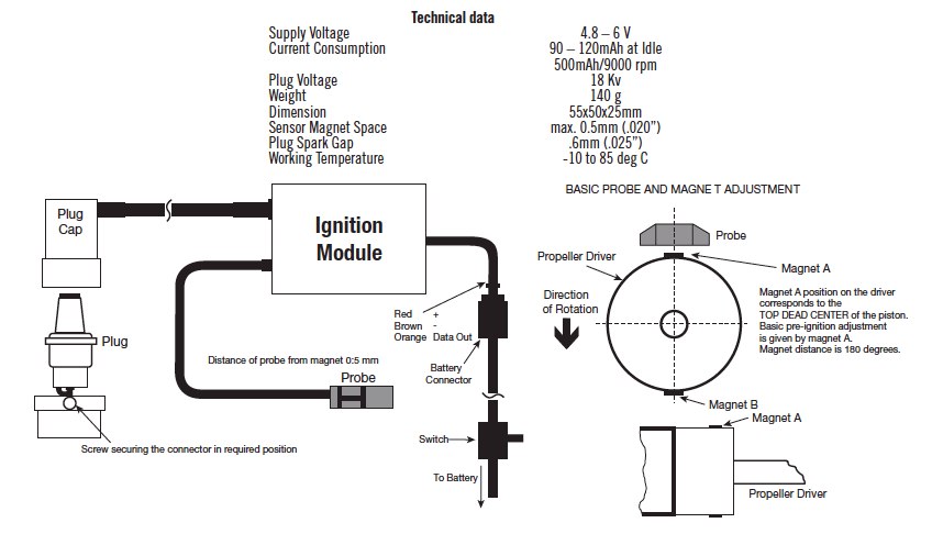

The third pic is the CDI hookup drawing for a GX ignition unit from the instructions manual.

Oh yeah, I forgot to include a pic showing the pads on the printed circuit board cleared ready for me to poke the wires through and solder them in again. I always feel anxious doing that as you don't know if the pads will lift up or come apart from the heat from the soldering iron or not. But the printed circiut board is a good quality one with plated through holes too. So it held up well to my cleaning the solder off and clearing out the holes in the pads. I used some solder braid to suck the solder off the pads with the sokdering iron. The large solder glob connecting the corner pad to the ground or common on the case cleared off a lot easier that I thought it would. I used a Weller soldering station with a fat tip for this, and a fine tip when I soldered the wires back in, and then switched to the fat tip when I put the solder back on to connect the corner pad back to the case again.
Now the case is thin sheet metal that was tinned. it is not alumimum. They may have slightly soldered the two covers on. On my unit, one cover was not soldered on and the other cover had one solder spot in the middle where the outer decal cover tape was wrapped around it. You may have to bend the covers a little to find where it is soldered on and if they over do it, you might wind up buggering up the cover a lot to get it off too.

Earl, I have in my scrapbox a Vlach ignition, serial 25456, type EZM 1 Ti.
These ignitions do have a data output where you can read rpm and timing, as well as operating hours using a data terminal. No LED on these buggers.
The ignition is an advancer, that calculates when to fire due to engine "history", I believe last 10 rpm or so. For starting, the timing is late. The second magnet resets the ignition so it can fire again.
Since the serial number of yours is close to mine, I would suggest they are close in properties, though production for MVVS and Evolution may show large differences.
Do not try to run the engine without a resistor type spark plug. It won't work. It fires OK with a non-resistor plug, but the timing is all over the place; a sure way of getting a fire spitting, backfiring engine.
