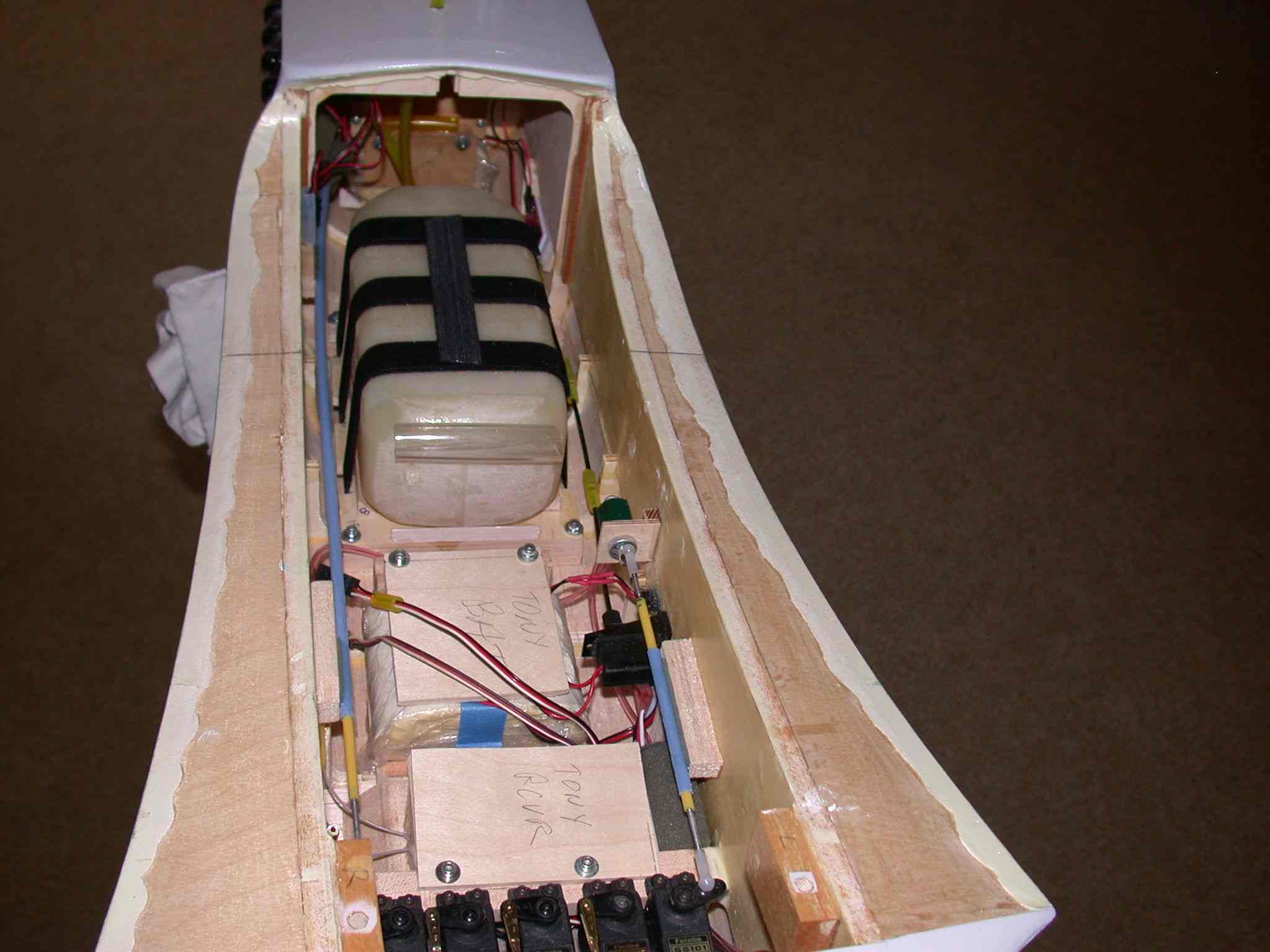

I haven't had a lot of time the last few days, but I did change the throttle servo, set up a different rx, switch, battery, and IBEC. I haven't ran it yet, but hopefully will tomorow. I will report back. If it's still no good, then I'll get new servo extensions and try moving the throttle servo. I also moved the reciever and the telemetry unit way back. There now at least 16 inches away from the ignition. My fingers are crossed.

BTW that is a nice clean installation in your picture. My only comment is "Look at all of that wasted space"

Well, good news is I found that cause. It was the servo connection for the ignition. With every thing I did, I started it and sure enough it was still doing it. I started giggeling wires and when I got to that one it stopped. So I cut the connector off and crimped on a new one and voila, no more glitching. I really appreciate all the help from you guys. Thanks, Steve.
