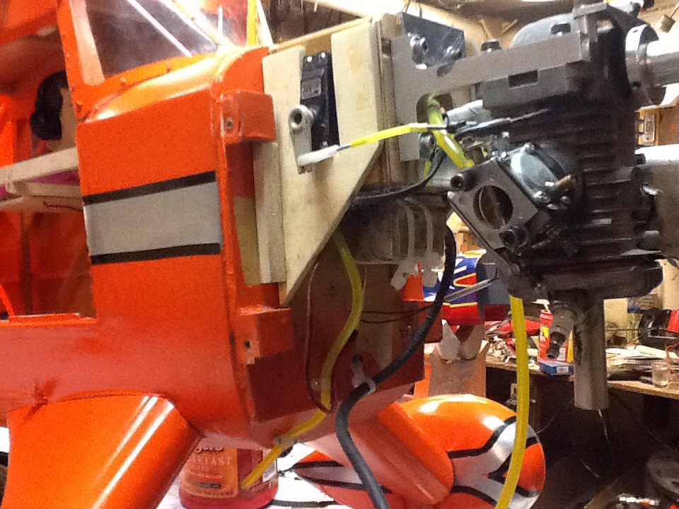

Will do. Is there any minimum distance that the ignition should be from a servo? My throttle servo is only at best 1 1/2 inches away. BTW, thanks for taking the time to help.

I would not run it that close, I am guessing you do not have a shielded plug cap, Also could have a crack in the porcelain on the plug.
Also make sure you do not use a metal connector with a medal rod to to the carb.

Just looked at the picture you posted and throttle linkage looks ok,
Looks like from the picture you have throttle coupling advance on the engine and if so for you to use a ignition that is not fixed timing you have to look the at 28 Deg before top dead ceneter

Posts: 1,369
Looks like there is a rod going from the carb to the front of the engine that rotates a wheel to advance the timing, Can not tell for sure in the picture, If so you can not use a auto advance with the engine without locking the wheel to set the timing at 28 digress before top dead center.

Well, conventional wisdom (and old recommendations from the radio mfg.'s) states a minimum of 12 inches, but in most modern radio installations that rarely happens. Certainly the grounding is critical as mentioned, and a resistor plug which you say you have. If you are running a 72 mhz system, you just might not be able to get away with having that throttle servo where it is so close to the ignition box and spark plug wire. A 2.4 gig radio system would probably be ok with it. Another thought, you could also try changing that throttle servo. Check the shielding on the spark plug wire, it's ground connection, and go from there.... For sure don't get frustrated and fly it unless it is perfect with no glitches on the range test at all.
Milton
If you look close, you can see the sensor mount that is common on Poulan/Brillelli engines at the top of the pic. It goes to the two forward crankcase half screws. It's not mechanical advance. I don't think any of the Brillelli conversions were....

I think what I am seeing is hooked to the choke.

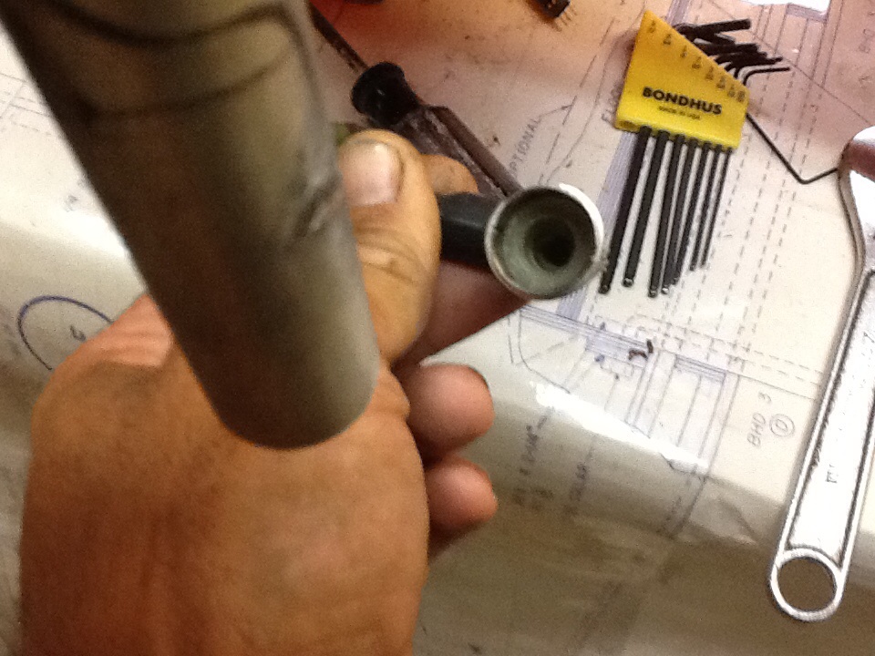

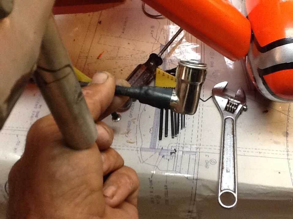

The most important aspect of this is out of the picture. Steve, can you post a picture of the plug cap?
It won't tell you anything. The earlier CH Ignitions just had a rubber cap like is on most weedeaters, blowers, chainsaws, etc. From right near the rubber cap, a lead from the shielding exited, and it was to be securely grounded to the engine.

, that is a choke rod your seeing, it has a pick up on top of the engine. When I get home from work I will first move the ignition, and maybe the throttle servo as well. I will also replace the old analog servo with a digital as well as re check my wiring and make sure there is proper spacing between ignition wires and any thing else. The plug cap isn't the old rubber type, it's like the newer ones. I'll post a pic. To me it looks to be ok, but then again if I knew, I wouldn't be here asking questions. One thing I DO know, this bird won't fly until it's straightened out. I have almost two years into building it and I'm not about to stuff it into a black garbage bag now just because I didn't want to wait . Lol. Heck, I won't even taxi it around the yard for fear that the throttle servo will start doing it too. I am confident that with all the help from you guys who know a lot more than me, I will get to the bottom of it. Here's the plug cap.

Put the plug cap on the spark plug just like you had it when you was running the engine and post a picture.

Those type plug caps are notoriously hard to install and are well known for causing interference if they are not on all the way. When it is properly installed, it will completely cover the hex of the spark plug and pretty much cover the entire spark plug. Push hard and straight. I have had them come improperly assembled too, with a gap at the parting line. Make sure the halves of the plug cap mate properly. If not, carefully undo one of the crimps, push the cap halves securely together, and then re-crimp the holder. I had a problem with this very thing recently as a matter of fact....
