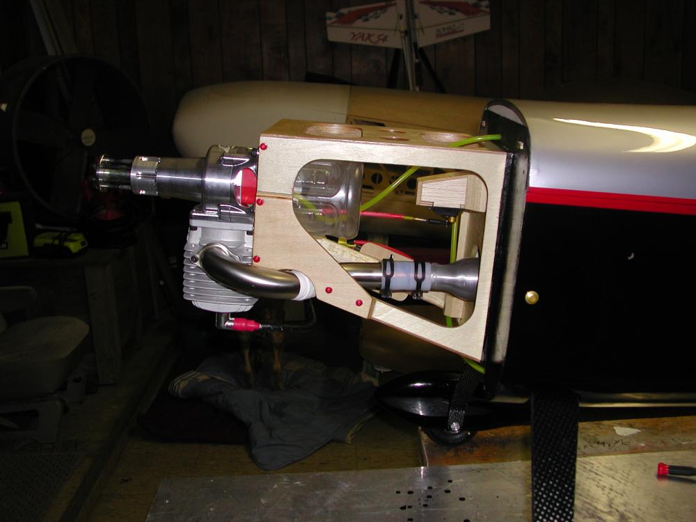

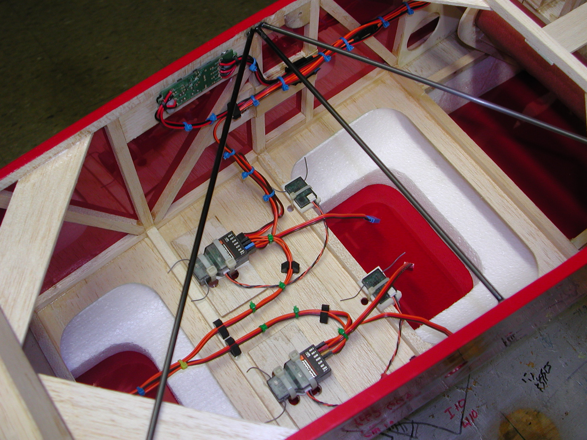

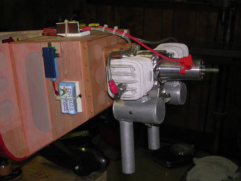

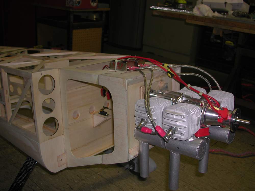

Just about all my radio gear installations since I started using 2.4 include at least the throttle servo and batteries placed within 3 or 4 inches of the ignition module as illustrated in pics below with no issues at all. I have done this in several airplanes now so I don't suspect that you will have any issues with your installations either. I too see more poor installation on everything these days then ever before, that is why I made the statement a couple of posts back to use the best shop practices when installing whatever in airplanes. I know you have probably seen these pictures before but others may not have.

Talk about the pot calling the kettle black, best shop practices would be to follow mfg's rec's. LOL! But I do the same plus a choke servo as well, plus a couple with a smoke pump right next to the ign just to piss it off......
Haven't pissed one off yet.
