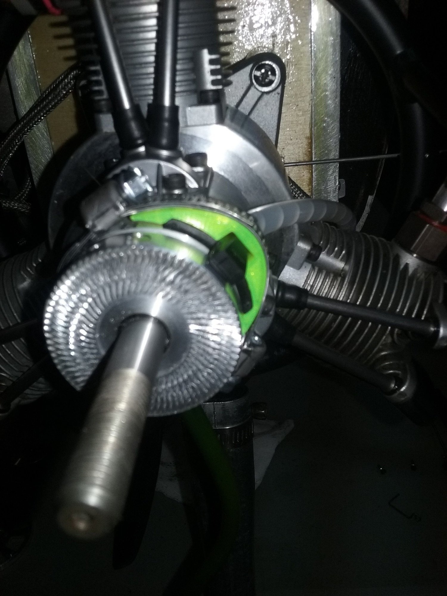

Default FG60-r3 temp Ign adjustment
You made my day!! Thank you all for the research and solutions info!
I built an ignition probe-holding adapter that slides to allow for timing adjustment. It is a 3D printed profile part that traps the sensor. Held on with a six mm wide hose clamp. This is a $3 setup for test purposes.
With this setup I adjusted the static timing to 34* btdc on #1.
first flip and it ran nicely at just 3k rpm!! I have always had to do my start and warm-up at 4.5k rpm with the 54* timing for 4 minutes before it would idle down to 2k minimum.
Now it idles steady at 1.5k rpm and will go down to 1.3k for short periods. This is with a room temp of only 40*f.
throttle response was stronger too. it has a 22x8 prop and revs to 6.5k rpm. ( I have a 24x8 to try later).
If the Morrisminor adapter addresses the crankshaft offsets, I will get that setup asap. If not, I'll build an aluminum adapter for a permanent fix.
I can't wait to fly this setup to see how it translates into pulling power!

Aquaskiman, I assumed as much, you seem to know your way around an engine so it was never in doubt that the FG60 failure was not your fault. Itís a design flaw.
jeff, sounds like an improvement! Nice!
34deg is still a little aggressive, and I cannot compared with mine as they are both at 30deg. The both idle solidly at 1100rpm and the transition is good on both. One is running a 4-blade, the other a 3-blade. Multi blade props usually carry a little more Ďmomentumí so sometimes idle a little better though. The 4-blader in particular, will idle solidly at 950-1000rpm. Maybe yours needs a little leaning up on the low-end, but you should get a solid idle around 1100.
Seems you can tell the the engine is a little Ďhappierí right?

cathurga, The engine and I are both happier. It is pretty cool here (about 4C) so I think 1200 is about all I can expect until the ambient temp comes up a bit. Number 3 drops out and drops idle below 1000 after about one minute. I am also a little concerned about valve lubrication at such a low idle. the L & H needles seem to be at the optimum since I get a rpm drop when I turn them in either direction. I did try to slightly richen the H and slightly lean the L. but it seems a little softer on the quick throttle opening.
I measured the thrust and with the 22x8 she runs 6500 max and gives 20lb of thrust. With the 24x8, she runs 5500 max and gives 22lb of thrust. with a 19.5lb plane, that will make a nice difference on the slow vertical lines.
FYI, Morrisminer told me he will be able to deliver after the holidays, so I pre-ordered on of his ign rings. FLy well. JJ

I have made a new prop hub based on my check of timing on My new engine.
Have used Proxxon dividing attachment 24264 to drill Hole for each magnet.
My goal was to have timing each cylinder within 1 degree and i almost made it, it is now
cylinder 1 30 degree, cylinder 2 30,5 degree and cylinder 3 31,5 degree.
I did borrow a lathe and bought dividing attachment and i am happy with the result with this cheap tools used.
Have started the engine and made brake in run and started to lean it but have not been possible
to have same temp on all cylinder and have turned engine during brake in to lean cylinder 2 and 3.
Next step is to buy intake kit from Morris mini motor .
The goal with all this is to have a engine that don't brake down and you can use for long time with normal maintenance.
Are now traveling and working and have to wait to be back at home for more test of engine.

Hello again
Cartuga
Spacing #1 to #2 magnet 126 degree. Spacing #2 to #3 magnet 108 degree. Spacing #3 to #1 magnet 126 degree.
I think this is correct Spacing but due to my cheap tool during manufacturing i have 1,5 degree off but are happy with it.

Jeff,
i dont think there is a need to identify them. We know that some versions had some differences, but it appears that the crank angles are consistent so you would be good to go with the ring/hub combo that Morrise is building. I think we have ascertained that the firing order has NOT changed. Itís all 1-3-2.
As far as I know, some of the very earliest models didnít have a brass bush on the crank, but I havenít seen any. Maybe I should trawl the earlier threads to see if someone had this setup. From what I see, the problems with the FG-84 were resolved and passed on to the 60 (apart from the aggressive timing of course). The only change that I KNOW of seems to be the redesigned pistons.
get the new hub, time it to around 30-32deg and you should have a good engine.

I also have measured my TDC's. My saito is one of the latest versions.
1-2= 126 degrees
2-3= 108 degrees
3-1= 126 degrees
Didier is offline

Thanks Didier, I think we are agreed that this is consistent throughout the range.
I am sure the morris hubs will help us to get the timing as close to even as we can get. Someone also pointed out that there might be some differences in magnet strengths etc etc, but it appears to me that these factors will not create a huge problem

I'd like to know if Mr Morris set the magnets on that ring at 120 degrees apart. If he did does not that throw this talk of a crank phased at 126-126-108 out the window?
