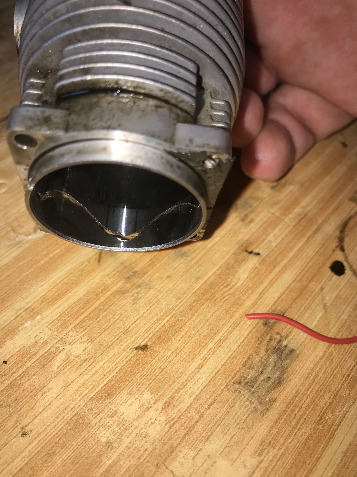

Well, gentlemen, I am sitting here at my dining room table, about to tuck into a HUGE portion of humble pie! Cylinder No2 let go earlier today in mid-flight. I will go into more detail later once I have access to the pics that I took. I need to do some more inspection before I come to any conclusions, but have already done the tear down of that cylinder, and it is quite surprising that the engine kept running. There was a very audible noise when it went, sounded like a misfire, but with more 'clang' in it than would be expected from a misfire. Landed the plane promptly as it was clearly running on 2 cyl's. As it taxied to a halt, it was still running but sounded like a marble was in there. Shut it down and noticed that No2 plug lead was off. Before the last flight, we did some tuning to the engine as previous 4 flights had showed some strangeness. It started, ran well and was fine, but after a while it got warmer, and started dropping a cylinder (assume to be number two) a week or so ago, we undid the spark plug on 3 and it disintegrated. Put a new one in and it was still running erratically. I have heard (and experienced, to some degree) the LS needle moving on its own and I thought that it was running too rich. I leaned up the LS and it got into its good rythym, and was going like a train again. Sent it up for the last flight and it did 4 circuits and was sounding sweet. The peanut gallery at the club were standing around admiring it. Temps on Cyl 1 was reaching 140 C max.Next circuit....bye bye cylinder.
It should be known at this point, the timing was at 30Deg and from what I can gather, the timing had not shifted. I need to check as part of the post-mortem, that the timing was still the same. This engine was purchased from someone who had previously had Cyl2 rebuilt by HH under warranty. I know that he had run the engine when he got it back from them, so it was not new to me. I have also probably put over an hour of time on this engine since I bought it from him, and probably another two hours since. The timing was changed a few weeks ago, and I would estimate that its done at least 20 flights since I changed the timing. It was running a Keleo exhaust.
I am bitterly disappointed, not least of all with myself, for banging the drum about the timing. I still think the timing is wrong from the factory, and I will KEEP running my engines with this timing. It simply appears that either this engine was carrying an existing problem, or the timing is not the only factor in the cylinder breaking problem.
I will post pics later, but in the interim, you guys are free to point and laugh all you want, LOL!
I, on the other hand, will be on the net, ordering another cylinder, valves and a new ring. Because I am not going to stop with this until I am done.... :-)

Ok, here are some pics from yesterday. And some rather disturbing discoveries about carbon build up....
First the cylinder crack. You can see it in place, as well as when I removed it. Obviously the crack looks worse once its off, but remember, this thing was still running when it let go....I also took a snap to see inside the crankcase, seems like there is plenty of lube in there...
Left View
Right view
Oil sloshing about
Rear of cyl - Removed
Front view - Removed

Now what I find disturbing.....look at all that carbon, the exhaust valve is in a VERY bad way.....this is with Redline at 20:1....
What the H.....?
Exhaust Valve
Inlet Valve
Exhaust Port

Sorry for your engine break down.
Yes that's a lot of carbon in combustion chamber.
Is it same on all cylinder, i can understand if don't want to remove all cylinder to check but i think you have to clean all valve's on each cylinder.
Any damedge on piston or piston ring.

Didier, yeah it happens, but I was hoping it wouldn’t happen to me, and moreover, I wanted the timing to resolve this problem.
i realise that this engine has had problems before And has been my ‘test’ bed for a while it has done many test hours and has been subjected to advanced timing, different oils, it’s had some odd gaskets installed in the past so I’m hoping that this failure has been a lot of different factors at work.
i haven’t removed the other cylinders, and probably won’t, but I will have a look at the exhaust ports, if I see the same build up there, then I might consider an oil change to stihl. As far as damage goes, the piston shows some slight scuffing that is probably from the failure, the ring is whole and looks fine. I am replacing cylinder, piston, valves and ring. It makes sense. There are no ‘particles’ from the failure so will just do that and then put Morris’ ring on it, and send it up again.

Sorry to hear of your woes! Just when you think you have it figured out... boom! Seems like it's always something. No "egg on your face," though. I have some information that may be of minor comfort.
I called Ray a couple of times as this thread has been developing, to further inquire about the timing concerns being discussed. The last time was about a week and a half ago. Both times he was adamant about the timing being correct on the 60R3. A few days went by, and then I got a call from him, where he announced that he had "egg all over his face!" He said he was taking the measurements off the 84R3 and 90R3, and basing his determination on that. He happened to get a brand-new 60R3 in the shop, and decided to examine it more closely. Viola! He found that the timing is, in fact, off! He said it was preliminary and that he needed to run the numbers with his giant degree wheel before he knew exactly how much deviation exists. I was impressed that he was willing to admit his faux pas. It takes a big man to admit he is wrong, but that is so very important! Ray is looking into making a correctly timed thrust washer for this issue. More on that as it unfolds...
In any event, your engine likely suffered from a design flaw that led to the failure. Perhaps you can take some solace in being vindicated!
