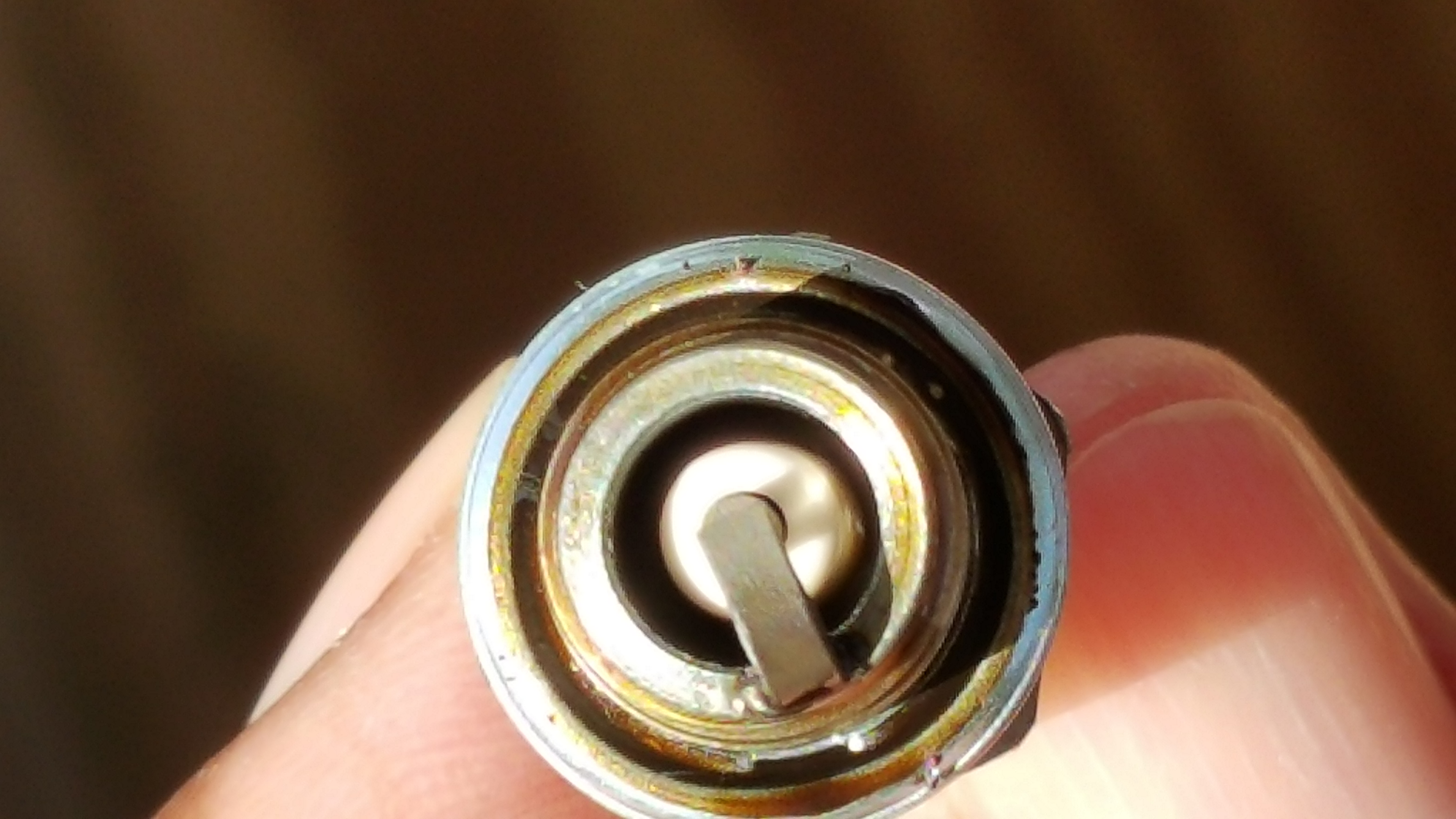

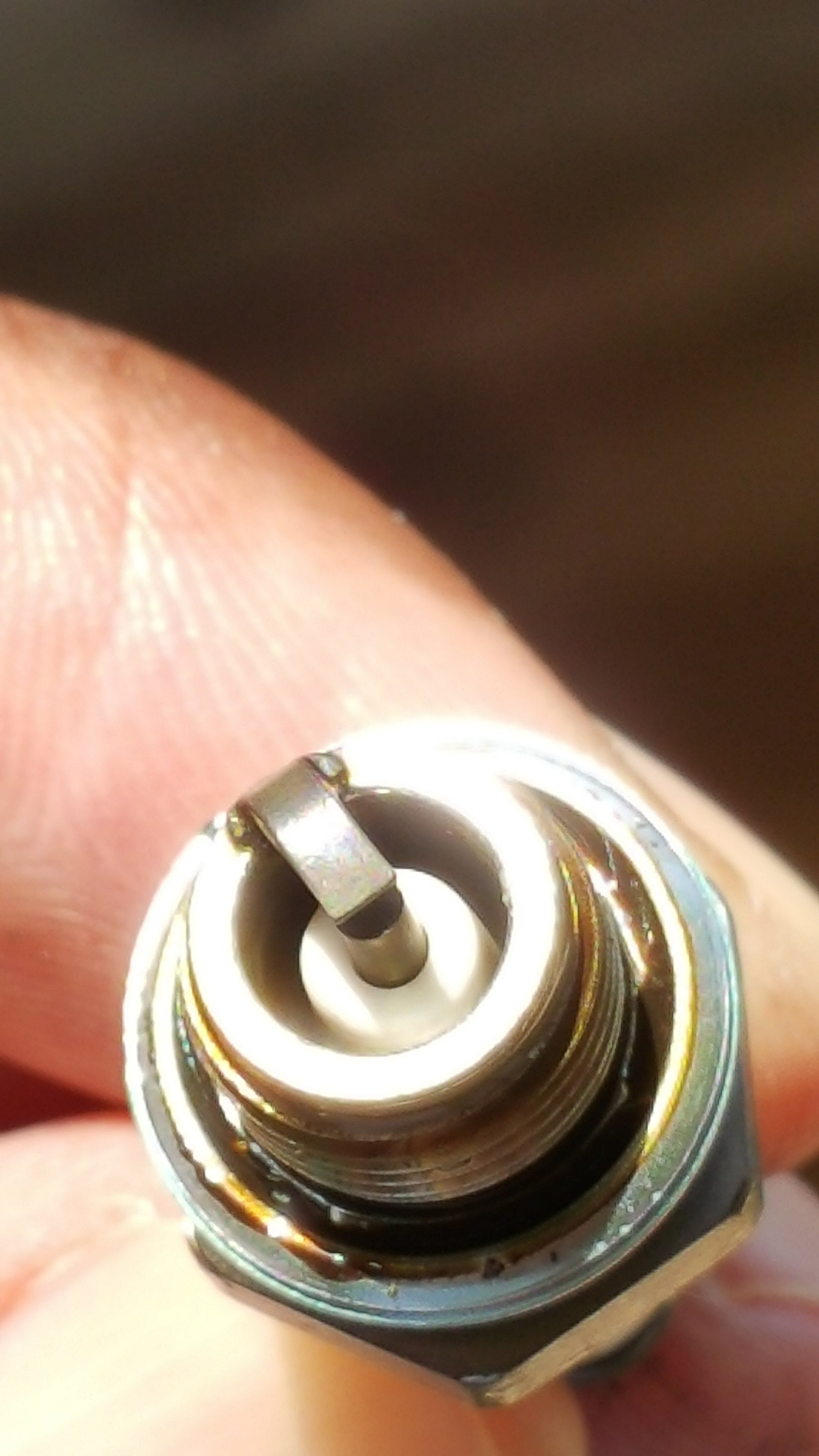

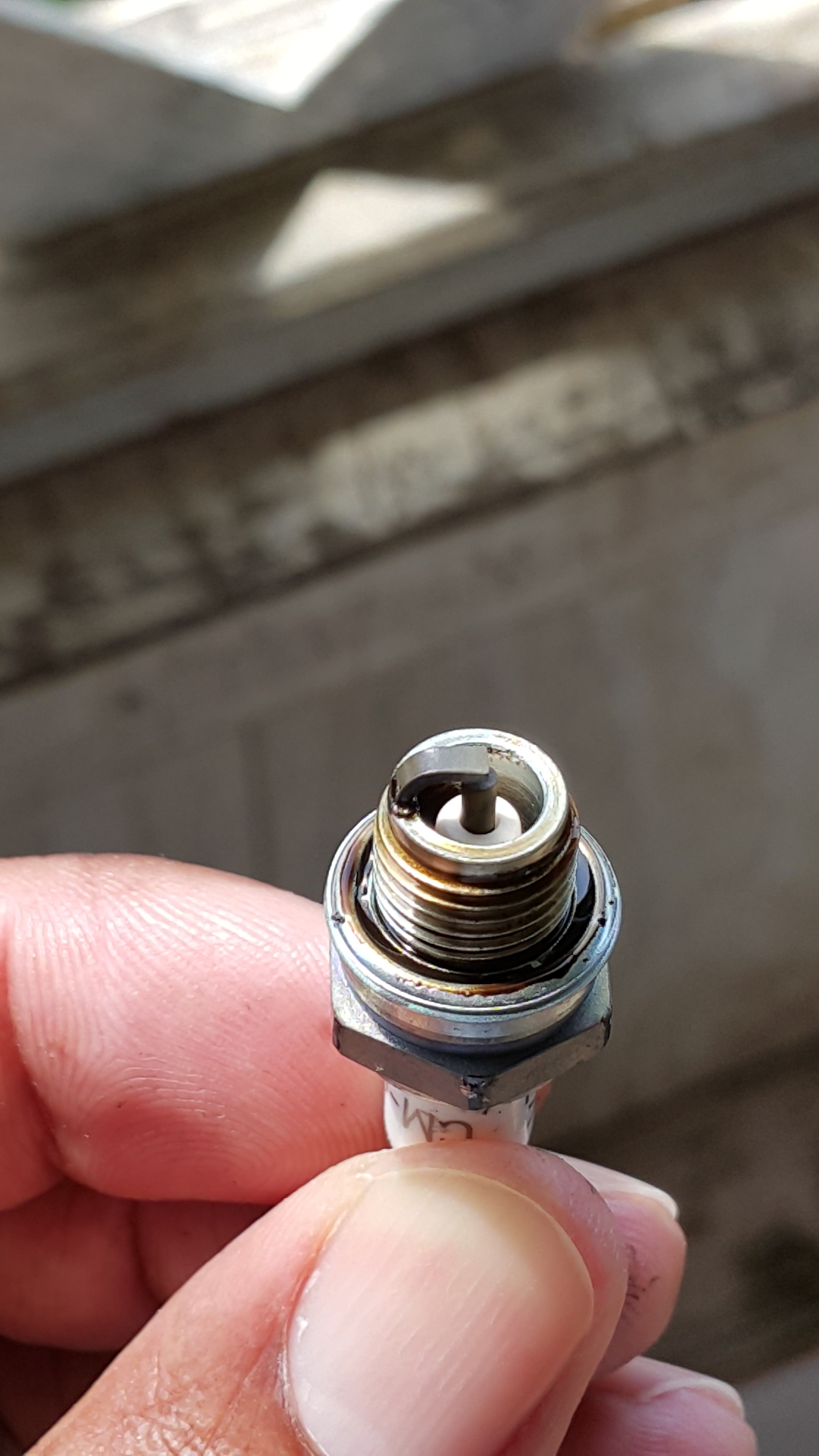

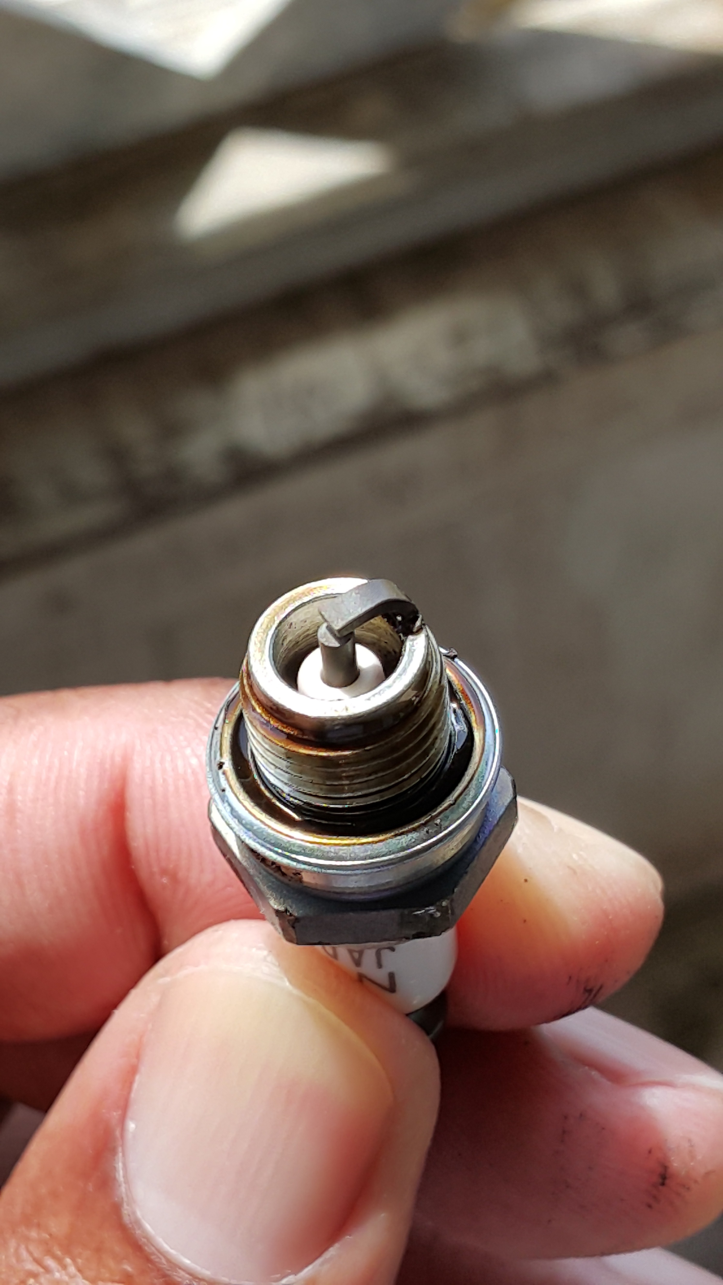

so i got it up in the air new plug and took some pics.. and now I'd like to get some feet back from you guys again.. I think I've done about 4 flights so far with this plug mostly high speed runs.
just pulled and took some pics have a look and let me know.. I think it might be too lean though... I did lean it out and then rich-en it a bit about an 1/8th to 1/4 turn.

Much easier to judge correct mixture based on how the engine is running. If it seems OK, you can confirm with plug readings - but they're going to need more time on them that what you have there.

looks lean to me I would richen it up , insulator should be tan colored, looks like you changed your oil brand or the mixture ratio

@ ahicks
Ok I'll have to send some running videos then...
@ dirtyoldman00
hm actually no not really, my fuel mix is essentially the same.
when I first ran the engine it was with regular lawn mower ashless oil non synthetic at 30-1 and remember it was very rich on the low as well as the high needle. That contributed to the fouled plug.. After breaking-in I swiched up to klotz synthetic and kept it at 30-1 for a bit.. then mixed it down to 32-1 eventually. All this was on the original plug.. Then I came in here and asked, at that time I leaned out both needles and richened the high speed needle about 1/8th to a 1/4 turn with a hand held tach to check speeds.
I've sice got a onboard mini tach to check so ill re-tune with that and report back with some videos also.
It's misfiring very infrequently now so the last mods I think I'll need to do is check that spacing on the plug and check the timing.
Thanks guys, it's getting there, I think.

It sounds to me like you have this thing whipped. In the interest of keeping things simple, suggest you shoot the video, if you think it's still necessary, after gaping the plug to .025".
