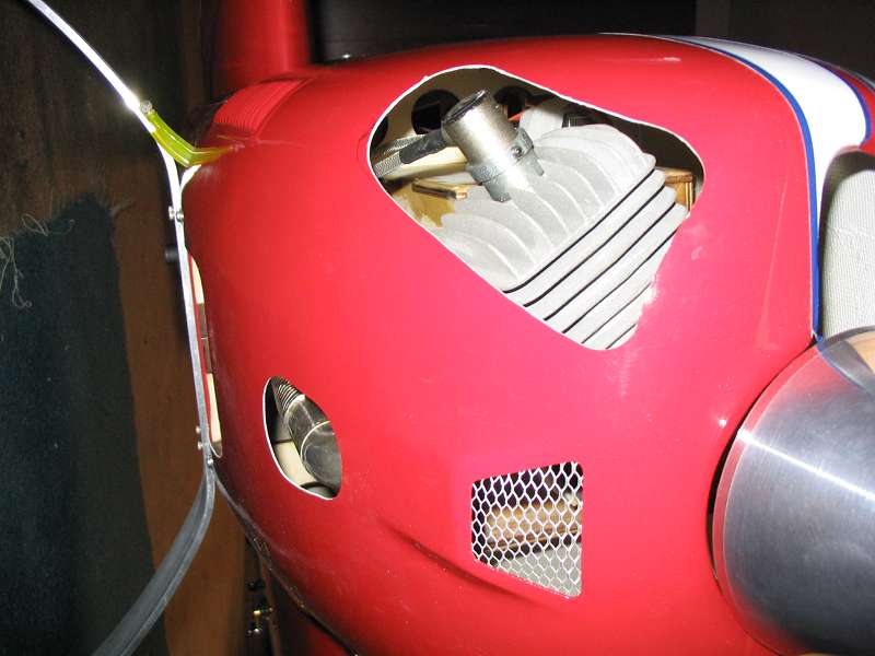

Hello,
Does anybody nows if the length of the header-pipe is critical for a gas engine with a muffler like KS/PEFA/MTW
Thx
Winfried

Muffler or Tuned pipe?
I have found that header length on a muffler dosent cause to much efect on the engine,
But it is criticle on a tuned pipe,
I can E-mail you the formula for the tuned pipe calculation if you wish.

RE: Pipe length between engine and muffer
The setup for the most power may not appeal -or it may -
as you pipe tune for most hp -you may cause a nasty step in the throttle response.
This will show up on larger props .
It is not a ZDZ problem -it is simply how resonant tuning works - for all around good performance increase - on a tuned setup --- the KS 80 can with front in -rear out -and 12" of header and a Mejzlic 26x10 --is a decent starting point.
IF--the plane is light -a heavier prop load may work just fine - IF you run wide open all th time -you can go even shorter and get more max power but you will soon run into a carb flat spot which you will likely over lean the engine to try and fix.
The engine has to use more fuel to produce more power
Don't buy into any talk of more power on less fuel - that's simply wistful thinking.
The catch here is that low and midrange do not want more fuel but as the resonant tuning kicks in -the engine wants a LOT more fuel - Fuel consumed = power. forget BS talk to the contrary.
So If engine setups are not your cup of tea - keep the tuned setup on the mild side
You may find that a non tuned - good quiet muffler on a very short header is better for YOU.
In this case - a 70/80 JMB can .
the total power is not as high as the tuned setups -but the throttle is easy to adjust and power is still very good.
We run different setups on our 80 singles - for 3D- a JMB muffler - for max power - a tuned pipe.
If you really understand pipe boost and how it requires fuel and pay attention to carb tuning and related prop setups -you can make this 80 perform with or better than most 100's
Better -simply because it is not sensitive to length.
For learning the "3D" stuff -you need smooth throttle response.
easier to do with non-tuned stuff.
Also - keep prop loads down- that is - let the engine rev-
largest prop-- a 26x10 Mejzlic- also try26x8-keep static rpm up in the 6000 range.
It takes practice to get comfy with a model hanging on the prop all day (zzzzzzzzz)
and the engine is loaded far heavier than when actually flying thru maneuvers at speed.
The heavier the model -- the smaller the prop .
Somewehre between 24x10 and 26x10 , you will fing a combo you like for 3D
On my IMAC plane - I can run the 27x10 stuff - no problems as the engine is unloaded most of the time.
The ZDZ50 (NOT the NG series) is a example of tuned port design.
If you study the intake/exhaust releationship -this is obvious.
When these engines were first released -I found that they ran like gangbusters- simply because I use a header and some kind of can (tuned or non tuned.)
Those who elected a restrictive in cowl setup did not get the design advantages of this engine.
Good power but not the high output it was capable of delivering.
The NG series use a different port/sleeve piston setup which flows in a different manner.
It is more tolerant of the restricted exhaust ( also has lower exhaust timing.)
Overall power on this setup is as good as anything I have seen in this size engine.
On correct tuned setup -it is really a treat.
On these engines (both series ) they respond better with larger cans .
Especially on larger prop loadings.
I see more people here using headers and cans/tuned stuff also.
this also goes for the other brands of engines.
I've run canisters on every gas engine I've had in the air for the last 4 years. After the 1st set it was impossible to go back to exhaust diverters. Until recently I had not played around very much trying to tweak and peak an engines output, but had just gone with the recommended setup and left it at that. While playing with the BME 110 Xtreme, though, I found that all the "rules" for making power could be forgotten if you just tweaked a setup and decided to be happy with the end result. My "headers" are exactly 2.5" long on my 110's, but I also feed the exhaust into extremely oversized "75" cc Pefa canisters designed for the 3W150's. This picks up about 200 rpm over "stock" but is still very smooth in the midrange and at idle, but REAL "tuned" length for the BME can only be achieved with a much more "engineered" exhaust design. The "hot" Setup for the 3W106's, as per Gerhard, is a 7" header into the "70cc" canisters meant for the 3W140's.
If you are looking to make only top end power, a true "tuned pipe" is the only way to go. .this works great for Pylon racing, and not much else, because it will kill your midrange throttle and you will have a lightswitch for a throttle .. on or off, and not much between.
Best bet, if you want a good running engine without being "peaky" is to order an oversized canister exhaust for it (by 10-15% of the canisters rating. . they tend to be a bit optimistic, so going larger is a good idea) , and an overly long header, then put the engine on the test stand, and start slicing off an inch of the header at a time till you get your rpm peak. Be sure to adjust the mixture as the exhaust scavenging characteristics change with the different exhaust flow characteristics. The canister style muffler will keep the max power from being "peaky" but you should realize a substantial power boost as the flow characteristics become mildly optimized.
A big can on a very short header just makes for a nice muffler - non restrictive -
a couple of hundred over an in cowl setup is reasonable -
I use the full length KS tuned pipes on everything from the 50 single-to the 160 ZDZ .
They do get long ---
the over 70 cm to tuning point is pretty common .
pretty much the same setup on the DA150's . The power boost is really excellent and smoooth transitions.
So far the quiet muffler by JMB - with very short headers is about the most fool proof setup I have tried.
No "boost" but much better than the in cowl stuff.
best setup for 3D where you are just "throttling"all the time
That setup is very nice .
It will work just fine.
I do most of my 80 and can setups , with the engine rotated to about the 8:00 position.
This allows for a single header bend.
On The WH35%, I did this setup as shown in attached pic.
I would suggest the front IN and rear out can by KS- I think it runs harder - It does have a little more internal area.
If you can swing it - the full length KS80 pipe is even stronger - but in the WH35%- the setup can be too tail heavy.
In this plane - balance is a real point of concern with the 80 engine.
I moved rudder servo forward and stripped and recovered elev and rudder after removing all sheeting and cap stripping them.
For the prop -for 3D stuff - let the engine rev-
Tho the 80 easily spins 27x10 MenzS in low 6000range, it will perform better using a 26x10 Mejzlic and running upwards of 7000 on the ground.
This rpm depends on tuning setup you use.
Do not use a short tuned setup - the engine can get rough in mid range.
The WH35% with this setup can be under 27 lbs -
weight is the enemy of good 3D flying
So-- my suggestion is to exercise every chance to lighten everything aft the wing tube - tailwheel etc., then - if it gets nose heavy, change the landing gear to 2024 T3 in 3/16" thick, 1/2 as wide as original gear.
My plane flew very well with the 80
we shifted to the 100 NG as soon as one was available .
The performance difference is not a bunch over a TUNED PIPE 80 single.
but the weight stays further forward.
The plane shown on the RC Showcase opening page, is this same plane.
It is a very good performer.

Dick
A grear big THANK YOU for all the info.
Thats a great shot of the header taken in cowl!
If you were to build a 35%WH again, would you use the 80 or go for a 100 twin?
How would you rate the preformance of your WH35% using the 80?
I would opt for a 100 if I was doing competition.
Flying the one I had - Brian Copfer won the SW IMAC Championship.
The 80 on a tuned setup is a good Sportsman machine but I like more power for Unlimited class stuff.
The 80 is a favorite of mine - I haved used it in a number of models and for my own tastes, I like to have it in a plane under 200 squares and under 25 lbs
Remember tho - We do most of our flying at 4500 ft elevation.
