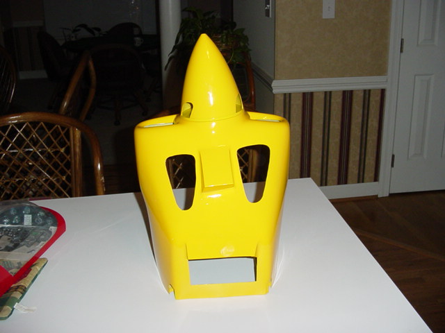

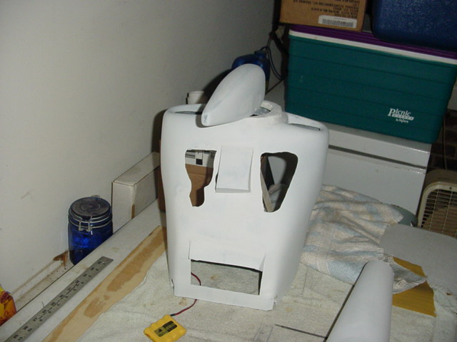

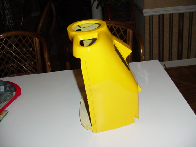

Hum space between the carb here are some pic were I built some f-glass around were the carb is sitting so it not out in the air.
Was that a no no there is about 1 inch of free space at the bottom

1" should be enough, But I had a little less on my comp-arf with a BME110 and it exhibited the same symptoms until I cut a little hole below the carb.
It would idle down very slowly, it also accelerated slowly (not rich) just seemed constipated. Cowl off everything was fine.
I still think the ignition might have something to do with it if all else has failed. Does it run fine with the cowl off??
Nice work on the cowl by the way.

THe last thing, how is your airflow around your diaphram? I have found that the engine is very sensitive to pressure or airflow changes around the diaphram pump. I used a 3W intake manifold and it made my idle very consistant without any changes. (on the ground)

Krazy, the carb shroud is not ideeal, it is probably creating a low pressure area at its open face, it would be better suited as an air exhaust

Crusty
R u saying I need to cut an air hole in the bottom of the cowl?
