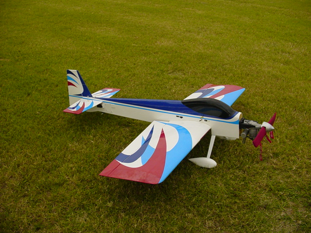

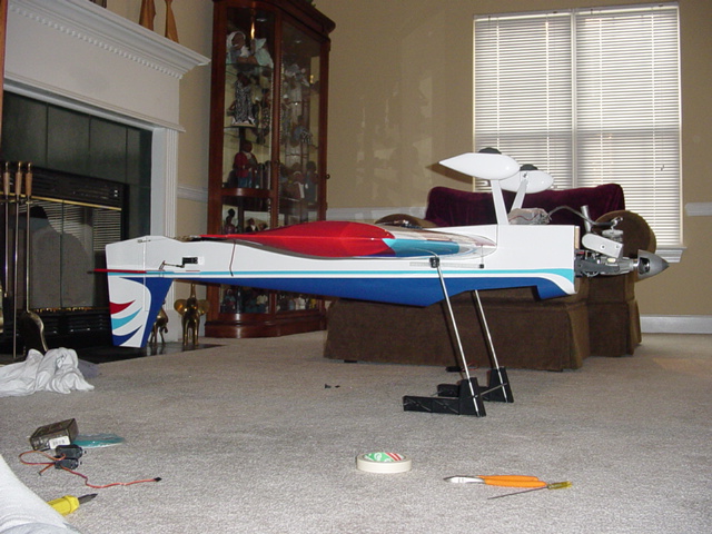

RCIGN1
any pics of that deal? how much was the conversion?
coony2787
how did it act being to lean? deadsticks or just sagging?
I have one that has treated me well i just ordered a Yak 54 65" profile to try it out on. I am going to put the U Can do up in the hanger for a other day it t-rolls its butt off on that bird... The Yak should arrive by Thursday of this week.

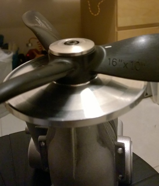

Hi! A good friend of mine sold me a week ago an Rcs/Moki - 140 (22ccGas) engine for my new Kyosho Spitfire .90. The engine is in mint condition , and is in the original box,with the accesories.
So i ve put her on the bench for the second test start and it runs great.In just four flips
the engine rocks , but...i realized when i tried to put on a 3-blade propeller , that the shaft was too short to mount the spinner into...! I ve put the spinner backplate , then the propeller , then the prop washer , but the shaft was at the end, and there where no thread to screw the spinner nut for my 95mm allu spinner...
The same situation for a smaller 2-blade APC 16X8 propeller with the backplate spinner on, and etc..
Anyone can help maybe?Has anyone experienced a similar situation ?
Thanks in advance
Chris
