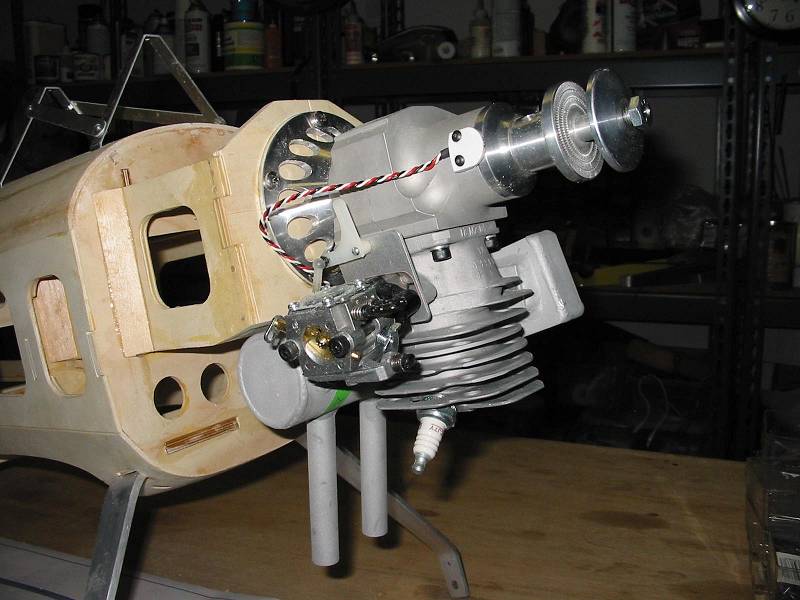

The Taurus TS42 is a good fit in the Super Stinker airframe. Here are a couple of pics of my SS under construction. I modified my tail surfaces based on a full scale S1-11b Pitts. The fin, rudder and elevators are enlarged and reshaped.

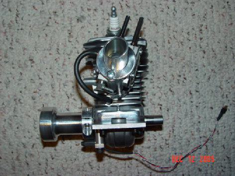

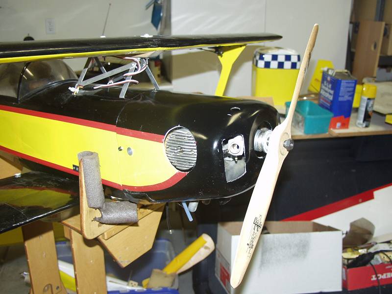

I too dealt with what engine to put in my super stinker..I opted for the SuperTiger 2300, (1) cause it was cheap and (2) it puts out gobs of horsepower.
Sorry too say, the engine never performed well, and I yanked..I now am deciding on a much more reliable engine and am thinking of putting in
my trusty Moki 2.10. Here are some pics.

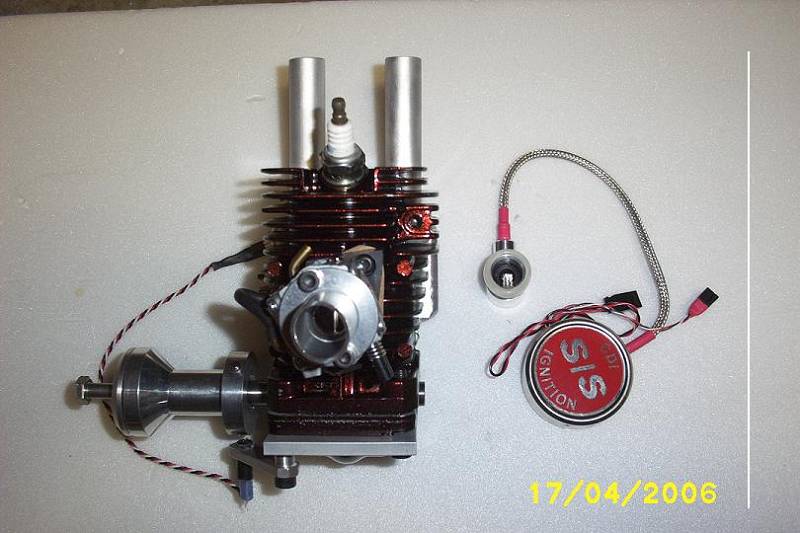

How about a Brillelli 25GT that weighs only 2lbs 12oz and puts out 14lbs 4oz of thrust with an APC 18x8 sport prop. I don't know what type of flying you prefer, but I do know this little engine is awesome. The best thing is this engine only cost $265.00 w/ei and the support you get from Scott and Mark at Brillelli cannot be beat.
Here is a review I did on this little engine and in the review I was testing the engine with a magneto on it. Even with the magneto this engine pulls my GB Giant big stick around with authority. The GP Giant Big stick is rate for a 160 2 stroke or a 30 -35cc gas engine. I have a Dyanflight SE-5a that has a 64" wing span that I am going to be putting this engine in.
http://www.rcuniverse.com/magazine/a...article_id=688
