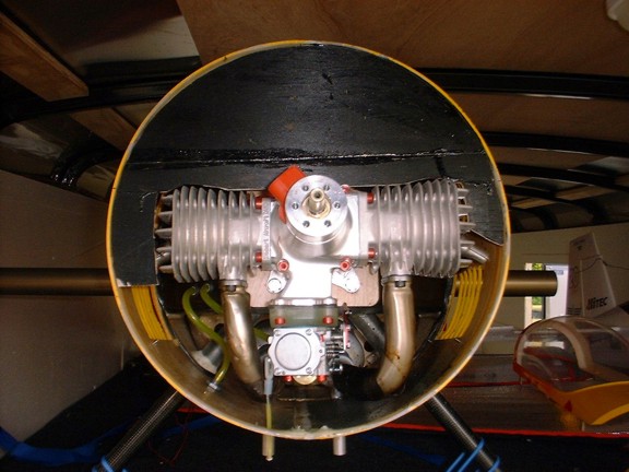

I like to see you have baffled the motor on you Yak mate. Heres how I did mine
http://www.flyinggiants.com/forums/s...ead.php?t=6116
Subsequent starts I do the full throttle choke thingy for one or two flips, depending on how much hissing I get then it goes first flip after that.
