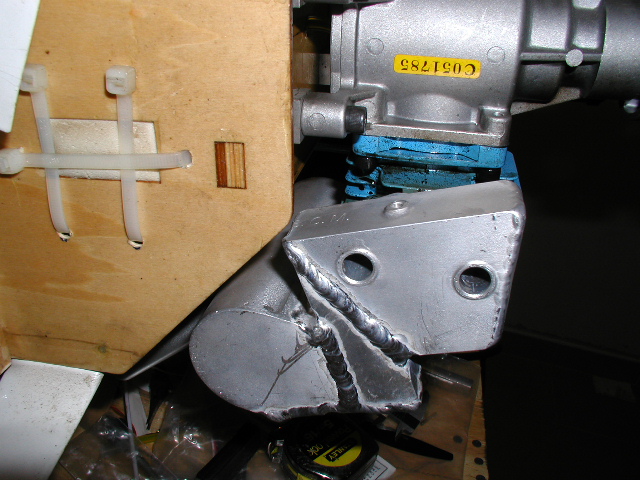

hy fellas i have a question about my bisson muffler , it is on a fuji 43 . to make it fit in a gp cap 232 i had to do some alterations . now i got it set up with slimline smoke pump and no matter how much or how little oil i put therw into the muffler it is seems to leave the bottem of the plane coverd with oil . i canot get dri oil here. so i am making my own with dessil and trany oil combo. could this be the reson for the unburend oil or is it normal to have oil under the plane when using smoke?

There's no such thing as a clean plane when using smoke oil. Some end up not as wet as others because the owners use a better smoke fluid and they adjust the volume of oil entering the muffler. Tramsmission fluid would not be high on my list of smoke oil ingredients if I was making my own in any case. Usually less oil equals more smoke, but you will end up with an oily plane no matter what you use. You can't put a boat in the water and not get it wet....
You might want to change the title of the thread. You can't blame the muffler for putting oil on the plane. You did that when you elected to use smoke oil

No problem. I was unaware of your singularity. If you intend to continue using diesel, which works ok, consider adding paraffin wax in block form to the diesel. The fuel will melt the wax and keep it in suspension. If anyone in your country uses wood forms coated with "concrete form oil" to make them easier to separate from the concrete after set up, see if you can obtain a few gallons of the oil to mix with the diesel. Your choice as to mixing paraffin with diesel and the form oil. You'll have to experiment with the ratios somewhat but for the wax use about 1/2 to 3/4 pound per gallon of diesel. For the form oil go with about 70% diesel and 30% oil. Move away from the transmission fluid first chance you get. All the mixtures will leave a film on the bottom of the plane, which is why some using smoke have long tubes on the muffler. The residue is also why so many don't use smoke at all. It's always messy! But it does look pretty neat. I can see where purchasing SuperDri smoke fluid might fall in the "unobtainable" category due to your location. Good to hear from flyers in Croatia. Truly this is an international sport and hobby.
