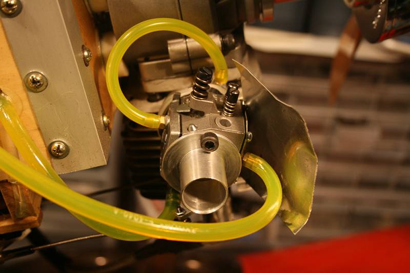

I have some MT62s, the one I'm playing with now is in a SD260 30% extra.
My problem is it's dieing on rapid throttle advance from idle. I've got the ignition set at 28* BTC static, and have replaced the soft carb block with one from Ralph made from G10. I'm getting 7400 rpm with a Vess22A and 7200 rpm with a BME 20x10, the same as my Brillelli 366GT. The plug looks good, very light brown. The idle is set at 1850, it will idle down to 1350, but it's a little rough there and 1850 works fine while flying. I've gone leaner on the low until it's really hard to start and dies lean on any advance of the throttle, and I've gone richer until it's slobbering. I'm running a KS86 canister with a DA header from TBM, it has no effect on the top-end compared to the stock muffler exactly the same power readings, just halve the noise. When I took the cowl off to tune the transition, the engine was wet with fuel/oil. When I ran it without the cowl I had to re-tune the end for top-end, then I noticed if I blocked the prop-wash from the engine I had to re-tune it. I fly with a cowl, dah, so to tune it without the cowl I strapped on a plate that blocks the prop-wash, as if it was in the cowl. Now I see where the gas/oil mix all over the engine came from, when I pop the throttle open a air/fuel mix fog comes out of the carb, it's not blown away like it was before the blocking plate. So tonight I'm going to turn a velocity stack about 1 1/2" tall and see if that helps the transition when I pop the throttle open. Anyone got any other ideas.

After each idle re-tune, you must set the H-needle again. It seems you are too lean on the top end, and your mixture is mostly provided by the idle needle.
Set the engine at ~1800 with the idle stop screw. Then find best idle rpm with the idle mixture needle. Open up 1/8th turn from there.
Now turn your attention to the high needle. close until rpm sags, open up again until rpm is just a tad off max rpm. If the carb is OK, transition should be OK. If not, dismantle the carb and clean the transition spray holes well. Blow some fuel in the carb and check function of each jet. There should be three or four of them, apart from the main jet.

Thanks I'll try your method.
I made a velocity stack for it last night, it seems to have really helped, the engine doesn't die anymore, but it's not 100% yet, maybe 99%, it started to rain so it'll have to wait for tomorrow.
How does the velocity stack work? Is it that it holds the air/fuel mix there to be suck back in? or is it ramming the air keeping the air/fuel mix from coming out?

I thought no way is the idle set too rich, but if I ask for help I listen and try what is suggested. It turns out somehow with all my putzing around the idle screw was set 1 3/4 out, the H needle was set about 1 turn out[:'(]. So to start I set the L at 1 turn, the H at 2 turns. I started it, then adjusted the H to get 7000 rpm, then set the idle on the radio at 1800 like Pe suggested and popped the throttle open, a little on the rich side, I played with it until it was about 7/8 on the L. Now it's working pretty well, 99.9%. So tomorrow I'll fly and fine tune it.
Thanks Pe.
